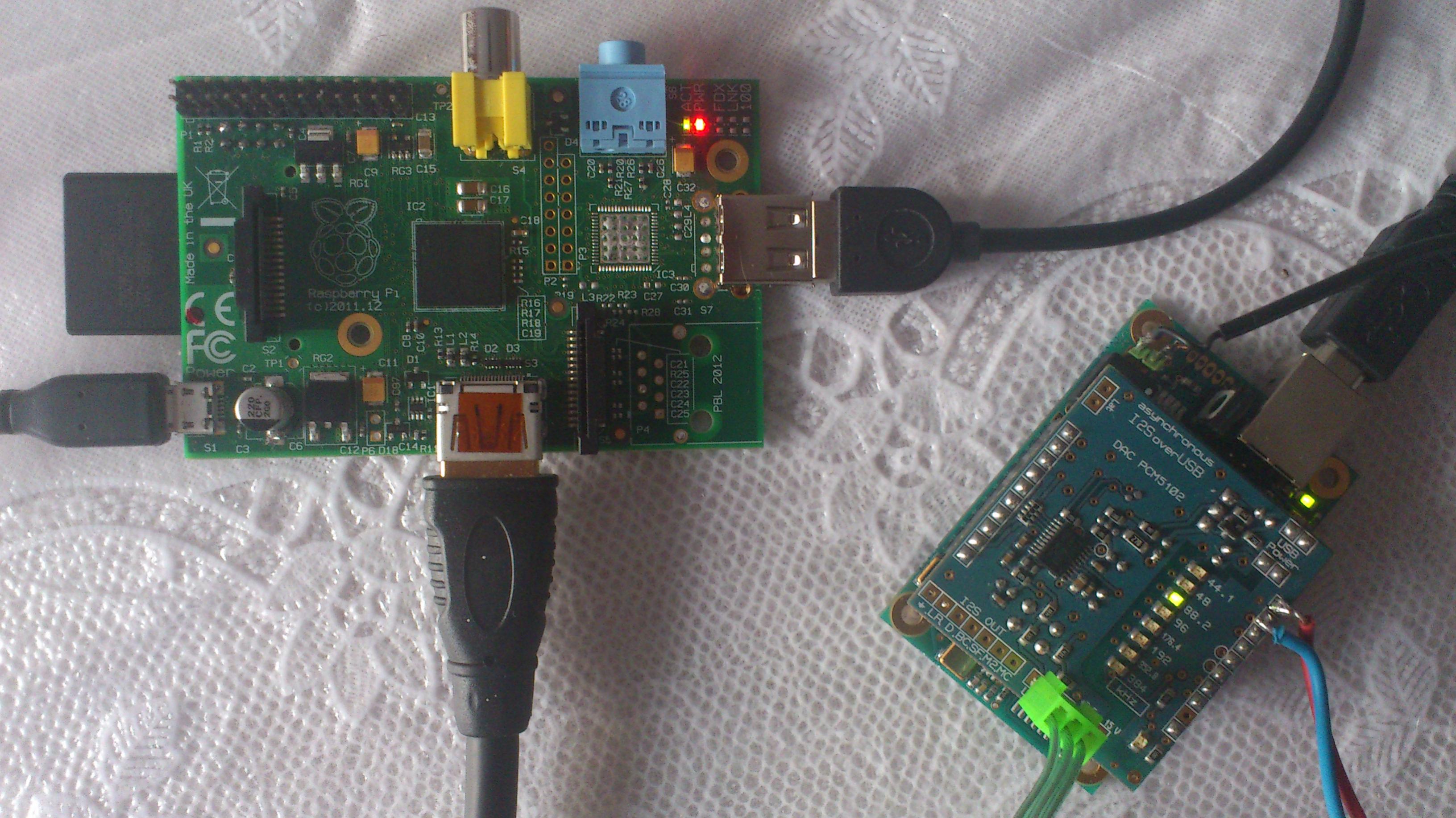

Hi.
Just installed the gadget. I hooked it up to a Raspberry Pi with Archlinux, running
latest 3.12 kernel and squeezelite.
The interface was immediately recognized. That's good.
I got trapped first. No sound.
I figured (RTFM) that I had to bridge the 5V lines without having the DAC board in place.
With the piggyback DAC board in place that 5V connection gets automatically established.
Now its time to apply proper power supplies and cabling.
Without it (just using a standard USB cable and USB power) my good old Squeezebox
makes a better job on the SPDIF output.
Please let me know what high quality 5V PS you guys use. As far as I understand I need 2 of them. On top of that I need a 7.5 supply. Hmmh.
What do you guys recommend as 7.5V supply for the 5102 DAC!!?
Thx.
Please let me know what high quality 5V PS you guys use. As far as I understand I need 2 of them. On top of that I need a 7.5 supply...
If you will use your XMOS board with PCM5102, you are going to need only one 5V PS and one 7.5V PS. On the PCM5102 board there is an embedded 5V regulator for the oscillators and reclock of the XMOS board.
If you will use only XMOS board, you are going to need two 5V PS.
Note: If you are going to use adjustable with trimmer potentiometer power supply (not recommended), please adjust the loaded output voltage and then connect to the XMOS board.
Joro

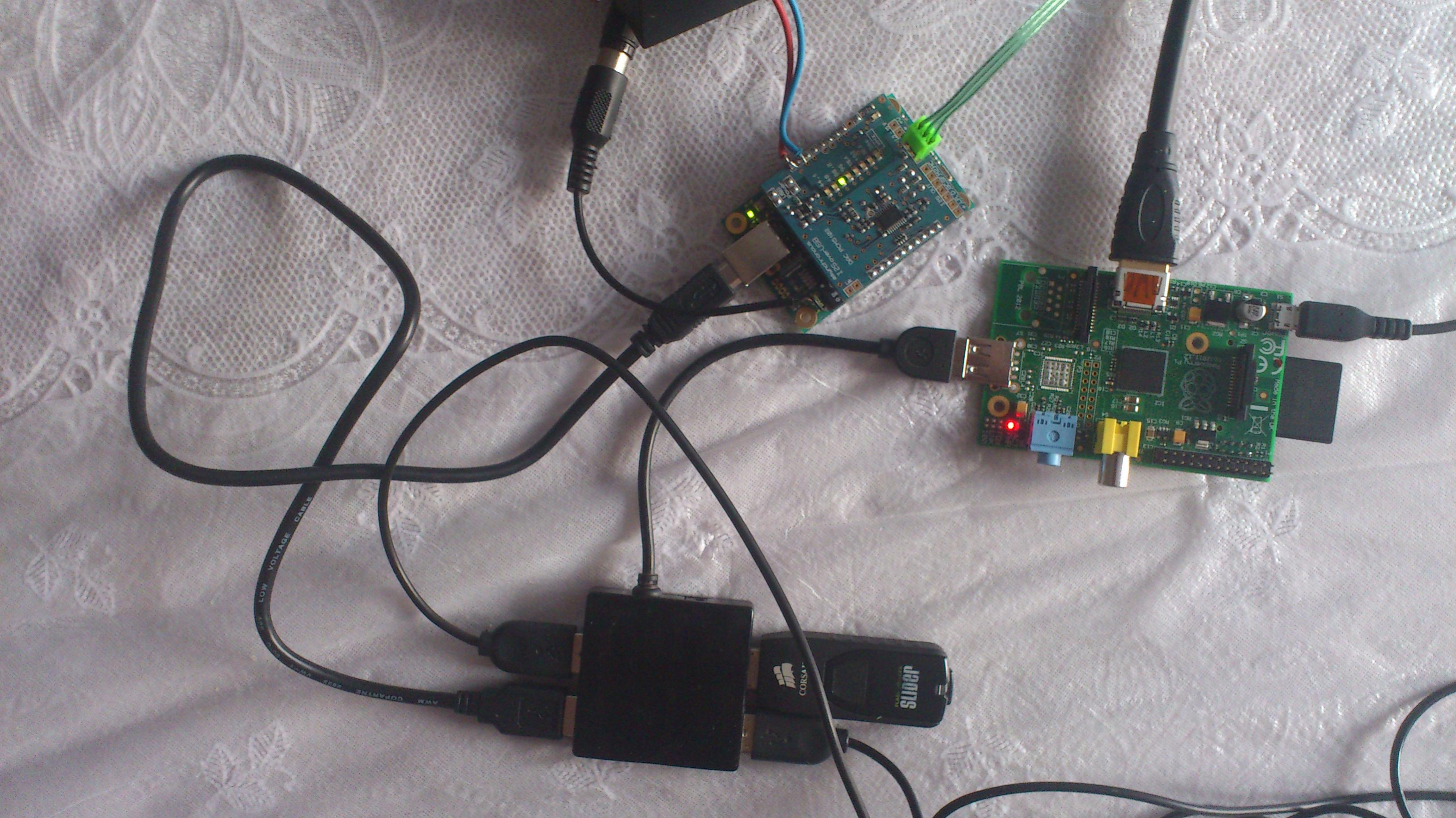

Hi there.
I today I worked on my SPDIF installation. (For the time being I skip the DAC board)
I run a RPI with Arch and squeezelite and a FullDigital Amp (a tweaked DDX320 from HifiMeDiy)
I basically hooked up 2 * 12000mAh EASY-Accs ( those batteries you use for mobile device charging) on each side to avoid as many gLoops as possible.
The Raspberry Pi that I'm currently using for testing is hooked up to another supply (5V from mains though). Here I'll catch a dirty ground.
The USB cable is filtered, the 5V lead is cut.
Bottom line. This setup beats my SqueezeBox Touch. A nice improvement. 😀
Though what I experience is not night and day appart. That doesn't mean much. My SBTouch was performing quite well with all the tweaks in place.
If I do the math: 50€ for the RPI (incl. case etc), 60€ for the batteries, and 80€ for the
SPDIF interface (Joro: could you please give your product a name such as JoroIF of JoroDac. 😉 ) . Bottom line the transport will cost me around 200€. That's not bad.
That's actually quite good. 🙄 30% less than my good old SB Touch - The stock price without any mods!
However. Why Am I not that enthusiastic!?!?
1. The 2-battery supply (for best sound and isolation) is kind of complex and annoying to
handle. Until I find a potentially better solution, if have to manage that.
One of those batteries need 100mA minimum current to stay on.
The isolated part of the IF stays below that. I had to load another USB port with
75R to get up to the 100mA.
2. The interface exhibits very nasty turn on/off plops. E.g. if I reboot the PI.
I guess something is missing there. This is almost a NoGo for the product,
unless I get that solved.
(If anybody knows a solution or has an idea of how to get this Plop thing resolved please let me know)
Next Wednesday I'm gonna compare the interface against an Audiophilleo II.
Cheers
The 2-battery supply (for best sound and isolation) is kind of complex and annoying to handle....
High quality sound requires some sacrifices 🙂 . XMOS board can be used with an external power supply (alone) for oscillators and reclock. The USB part to be powered by USB host, thus galvanic insulation will work.
All of the potential of I2SoverUSB ( like that, I named XMOS board some time ago 🙂 ) reveals when using I2S output (with a maximum short cable). This is because the receiver of S/PDIF has a PPL for recovering the clock.
I had to load another USB port with 75R to get up to the 100mA....
Sorry, but my English is not so good, so could you please explain this with another words, I can't get it.
The interface exhibits very nasty turn on/off plops. E.g. if I reboot the PI...
Unfortunately I have no opportunity to try each test unit (I don't have RPI), so could you be so kind to test the I2SoverUSB and the DAC5102 board with your RPI and under Windows OS if you have the opportunity, and share if there are still these issues.
Joro
* The Easy-ACC batteries that I use are meant for mobile device charging.
They come with several USB outputs to load multiple devices at once.
Obviously they have a chip inside that measures the charging current.
If that current gets below 100mA the Easy-ACC turns off.
Obviously I'm using the battery for a different purpose.
Feeding the isolated part of your board with that battery causes less then 100mA load, thus the battery turns off.
The XMOS part draws more then 100mA. That's why the 2nd battery stays on.
To generate an artificial load, to get above 100mA, I had to hook up a resistor
on another USB port of that Easy-ACC. And that worked.
* Connecting the XMOS section and the Raspberry Pi to the same power supply,
even with external cabling (no USB power), causes slight degradation of sound.
That's also been mentioned earlier in the thread by somebody else. That could be a sign, that the isolation part and reclocker doesn't really work at 100%.
And that there's still space for improvement. Though I guess your competition is not much better, if any better at all. However. I can hear the difference easily.
* I do not own a Windows PC. The RPI works well on my Teac DAC though. No Plops.
Somehow you , the XMOS , might sent a garbage signal out when turning the USB transport on/off.
When turning the RPI off and leavng the SPDIF IF on, it's rather like starting a machine Plop gun. I'm a bit concerned that this might kill my speakers.
Cheers
Connecting the XMOS section and the Raspberry Pi to the same power supply, even with external cabling (no USB power), causes slight degradation of sound...
When power supply is common, the interferences from one access to another, and vice versa. The way of the noise is not only through the galvanic barrier, here affects the electromagnetic interference. Galvanic isolation unfortunately can not cope with them. To reduce the electromagnetic interference are required electromagnetic screens thru capacitors and things are going to increase seriously the price of the device.
There are few people who could catch the difference when using separate power supply for the USB power part (you're from the lucky ones) for this I provide opportunity so one can use separate power supply for the USB part. For this I recommend necessarily completely self-power supply for oscillators and reclock and for those who can hear the difference option for external power supply for the USB part. I personally do not hear the difference, but some of my friends hear it and that's why I embed this feature (obviously I was not wrong 🙂 ).
The RPI works well on my Teac DAC though. No Plops...
Could you please directly pull out the USB cable (this would be equivalent if you power off the RPI, which you already done that). Are there the same plops? I just tested the S/PDIF output under Win7 with different receivers (receiver Harman Kardon, S/PDIF input of HD970CD and DAC Denon DA500) - no plops, when disconnecting the USB cable directly, as well as turning the computer on and off.
Could you please try XMOS + PCM5102 +RPI. Are there the same plops?
Joro

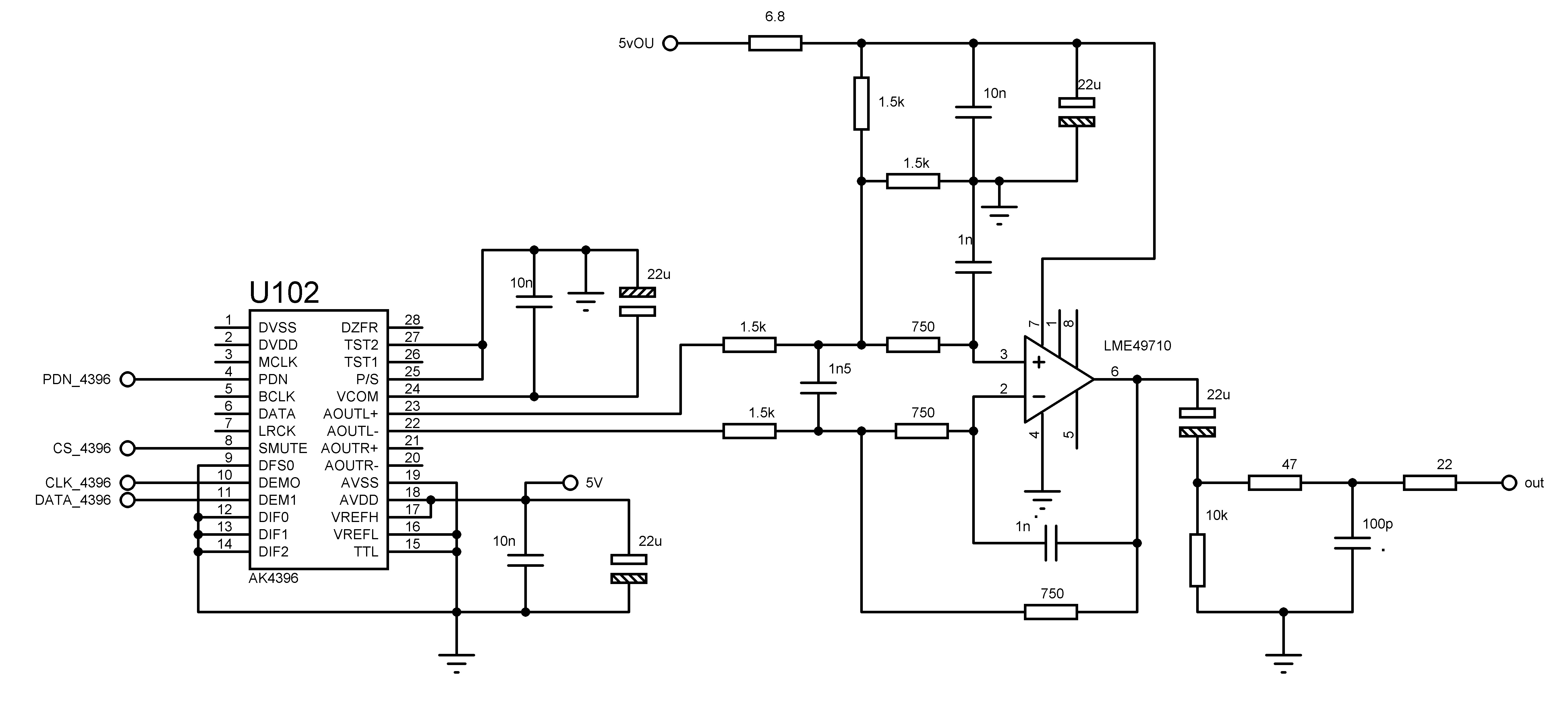

Hi Joro,
I have recently received the XMOS/AK4396 board and my intention is to get the most out of this combination not only by applying the external power supply.
Although the board should be difficult to work with (extremely compact, mostly smd components) I think it is possible to further improve the output section of the AK4396 board at least by installing the better components (capacitors).
As long as I could notice (I'm not an expert nor I have any technical background) all is done mostly as per AKM datasheet.
It still would be very useful if you could post the schematic of the filtering/output section of the AK4396 DAC chip.
Thanks and regards,
Goran

Yesterday, I borrow from a friend of mine RPI with installed raspbian pi kernel 3.10 and vlc 2.0.3. I checked all the situations, which Soundcheck has been tested. I did not notice any plops when power on/off RPI using both S/PDIF (with receivers listed in my previous post) and analog outputs from PCM5102 board. My conclusion is that there are a variety of software cores for RPI and there may be problems with some of them. According to my friend who is more familiar with the software for RPI all cores should work if one write the needed code.
Problems that I noticed - during playing, if you read some information - the sound stops and the indicator for CPU load is on the maximum. Approximately maximum CPU load is reached during 96kHz playing, at higher sample rates the sound stops (obviously, CPU performance influence), this is of course in this compilation of the kernel.
In near future I will try to test other kernels.
Although the board should be difficult to work with (extremely compact, mostly smd components) I think it is possible to further improve the output section of the AK4396 board at least by installing the better components (capacitors)...
Of course if you change the type of capacitor you will change the type of sound signature. You can experiment 🙂 , the used components are not bad at all, for the filter are used these components: Farnell numbers 9752897, 9752900, 1215927, 1215936.
As long as I could notice (I'm not an expert nor I have any technical background) all is done mostly as per AKM datasheet...
I can not escape from the datasheet 🙂 But approximation of the filter is synthesized by me.
It still would be very useful if you could post the schematic of the filtering/output section of the AK4396 DAC chip...
No problem.
Joro: I can sent you the interface parameters if you like. They look really different compared to yours.)...
This could help me.
