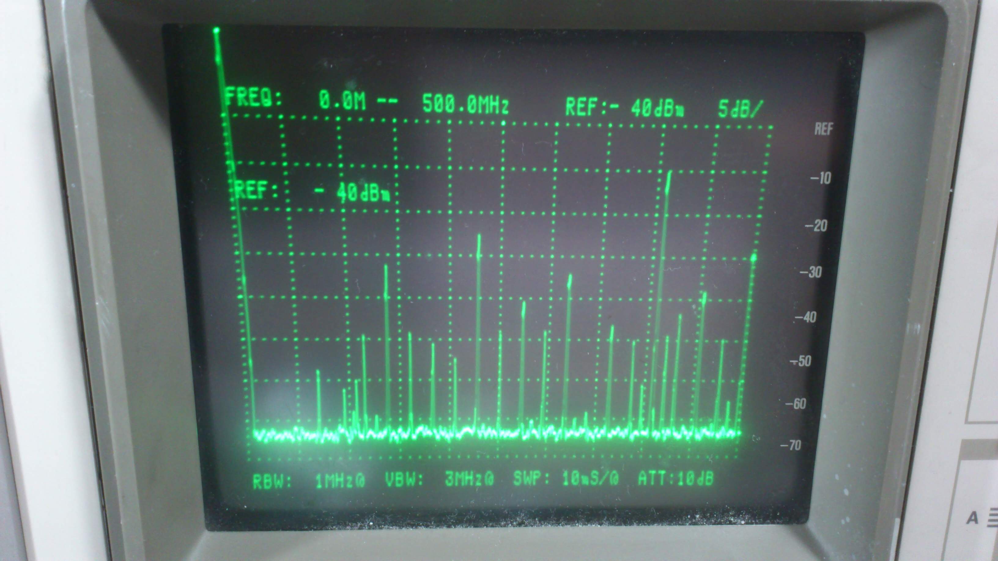

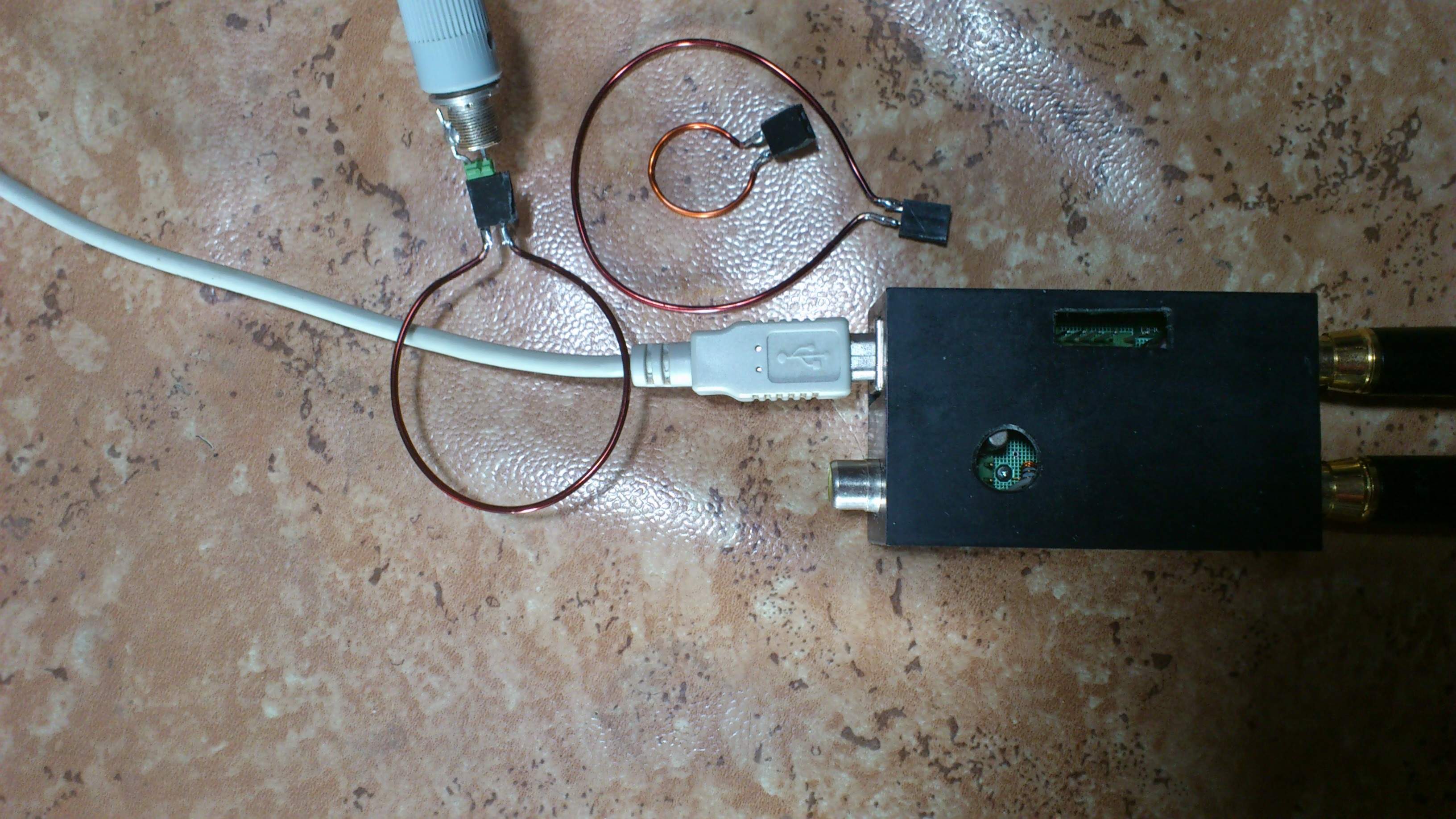

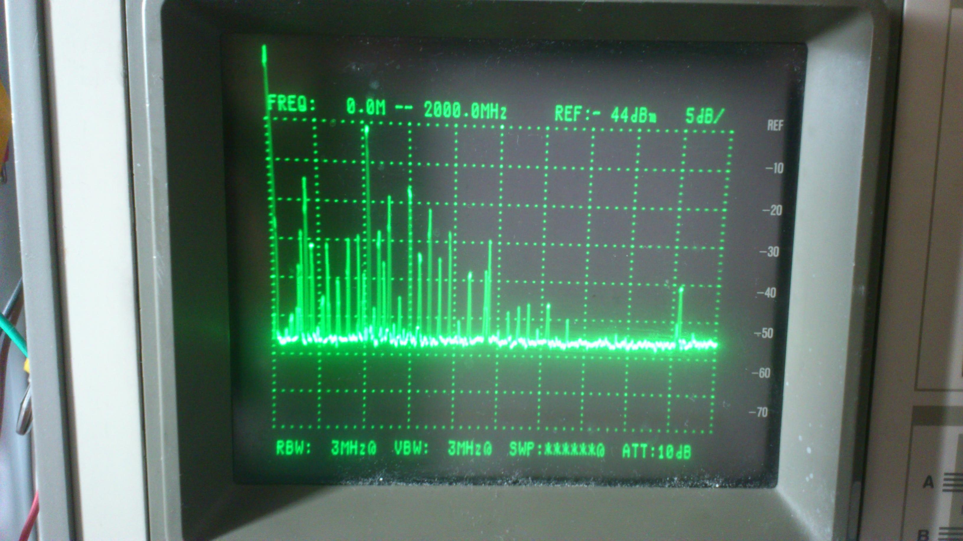

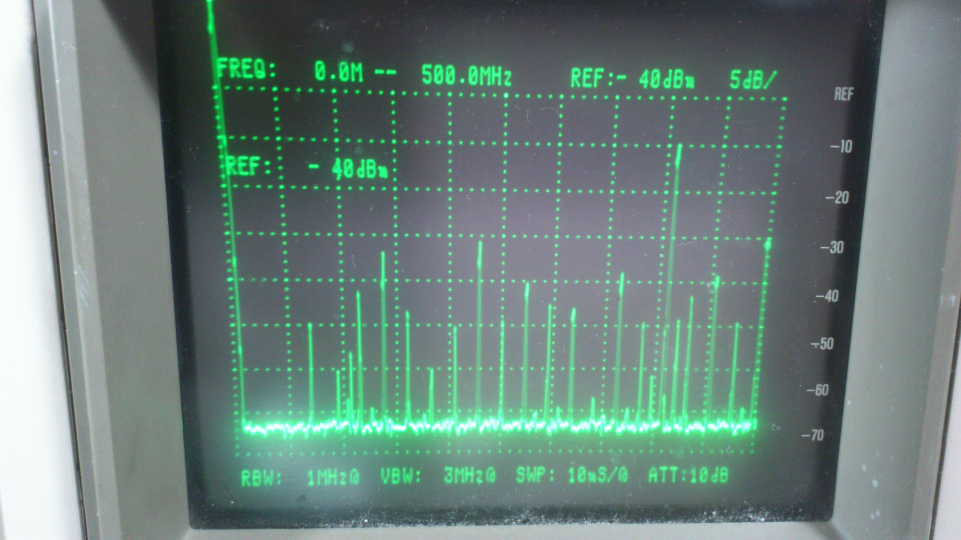

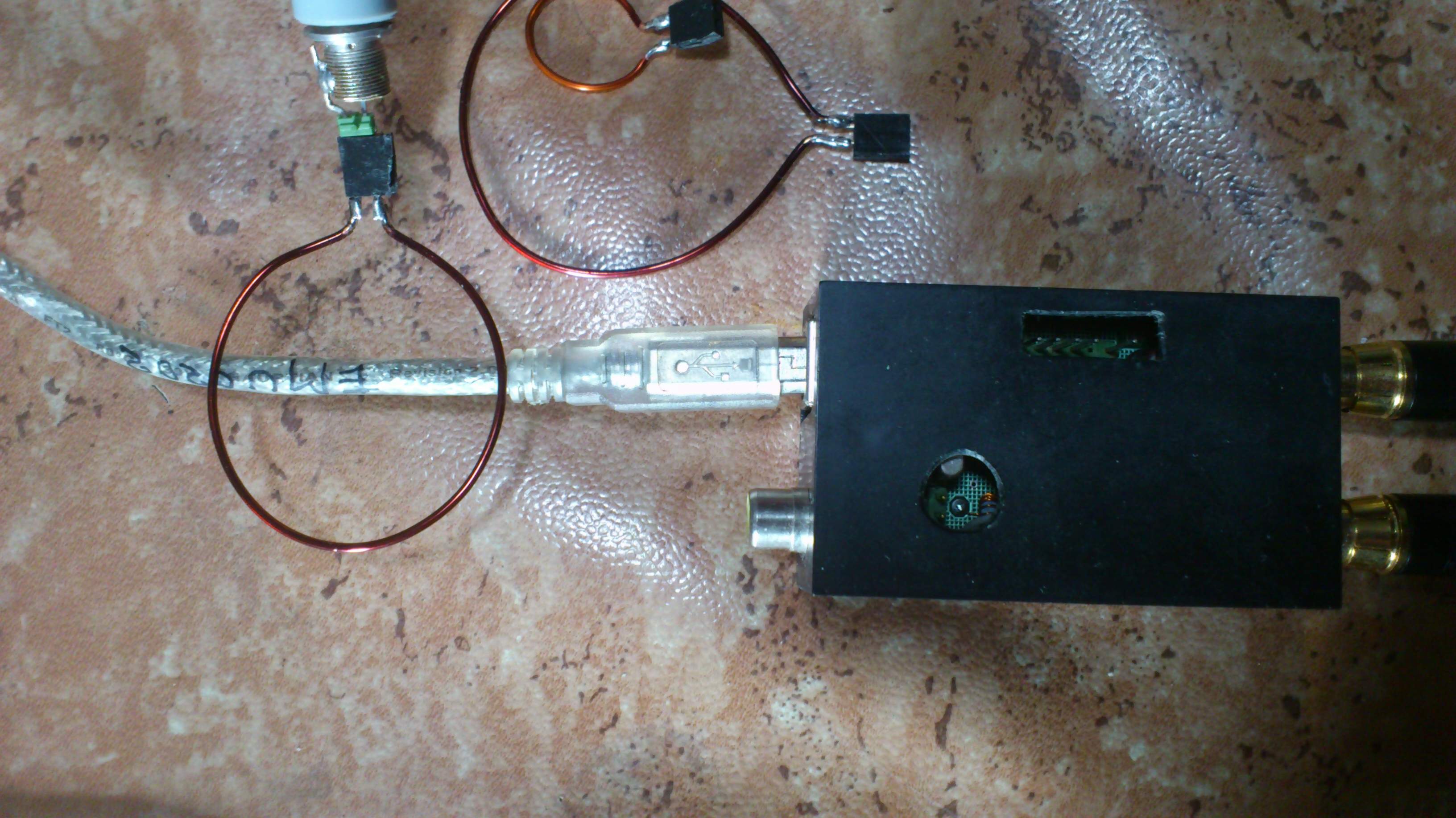

I'm back for the USB cables you noticed that have influence. Each cable (not only the USB ones) has its own broadcasting / emission depending on their design and the materials which are made from (as you will see from one of the spectrograms the emission of the cable is up to 1GHz). Pictures below are for two different USB cables and I intentionally use PCM2706. The emission is visible with the measurement done by my “old friend” ANRITSU MS710, which soon will come into well-deserved rest 🙂 .
If you look close at the pictures, you will notice the differences in their emissions. To be placed under the same conditions the input signal is 1kHz sin. You would probably guess that the galvanic barrier is the cables’ isolation and air. I hope that it becomes clear that the galvanic isolation is not a panacea, for me personally its usefulness is undeniable.
The electromagnetic interferences of the cables are received by each wire (trace from a PCB board) in free space as the distance is less, so the impact is greater. The only struggle with the electromagnetic field is with electromagnetic screens.
Joro
