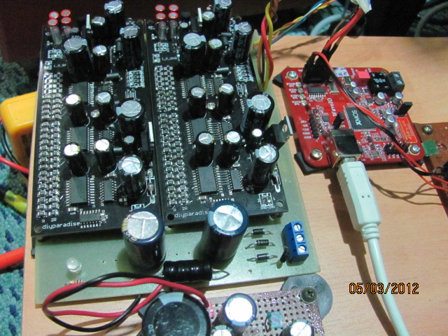

matching problem with discrete dac from diyparadise
I match it with the discrete dac from diyparadise malaysia.
It works but there is a constant low level distortion with soft music . the distortion is absent in between tracks or on pause.
I am using window 7 in a fanless ATOM based pc and Foobar .
The digital isolator is powered at 3.5 V via a salas shunt regulator that was proven to work well in another Tenor based converter.
Any idea what the cause ?
thanks
kp93300
@ PET-240: yes, drivers are for Windows OSes.
@ kp93300: Try to use external Power supply: 5V @ 0.6mA minimum (please do not cross 5.8V limit). For this you'll have to connect the external PSU to J13 screw-type connector and switch the jumper on J12 pin header from "USB" to "EXT" position (check the back side of your WaveIO card for Silk screen text).
Please let us know if there's any improvement,
L

Is it sufficient to run external PSU with voltage slightly lower that 5V....my shunt regulator stays at 4.93V when running with a fix resistor. I works well with a other 5V ICs but...who knows....!
There will be no problem! 0.07V isn't a 'huge' difference 🙂 Just make sure that the currents will be enough for the card to work properly (0.5A min). One side note: it will be nice for you to keep the voltage below 5.8 V otherwise you could see smoke from the back side of your card 🙂
