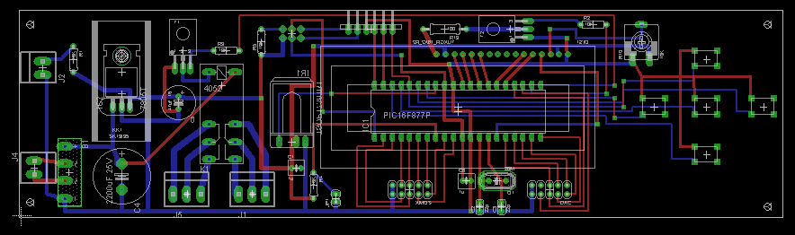

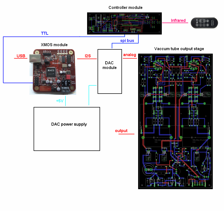

How does it get data from the xmos module if the xmos usb interface is already connected to a computer?
I think he is sensing the sample rate from WaveIO

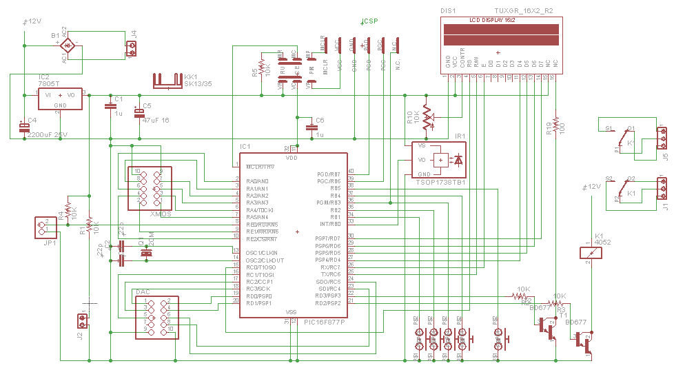

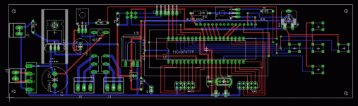

See new main schematic.
I can send microprocessor chips with custom firmware for any DAC if someone have problems to flash these.
The LCD is a 16 x 2 characters with blue background.
