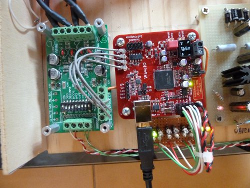

A question for Wolfsin or whoever is successfully using WaveIO with a TP Opus 8740 module.
I don't get any output from the dac (but the module works fine with Teralink X2 I2S output) and WaveIO output clocks signals seems ok (non-isolated).
Which hardware setting are you using on Opus8740 with WaveIO?
Mine is a typical stereo (I2S high, dsd low, deemph low, mode low, iwo high, diffhw low, fsel off, mute off, osr off)
Thanks.

Opus 8740 again
Well, reading 8740 and 8741 datasheets I noted this peculiar difference:
8740
The WM8740 supports data input word lenghts from 16 to 24 bits and sampling rates up to 192 kHz
8741
The WM8741 supports PCM data input word lenghts from 16 to 32 bits and sampling rates up to 192 kHz
If I'm not wrong, I remember that Lucian told that WaveIO I2S output is 32bits.
Could it be that difference the problem with 8740?
Yes, but from that 32 bits only 24 are used. I2S Data is left aligned (except the first bit after the Left/Right transition) while the rest of them are zero padded. You can see descriptions of I2S interface here, at page 13 (bottom) and here, at page 23, below the I2S Mode paragraph.
At first sight you ave to make sure that your DAC chip has Audio Input format configured to 24-bit I2S data (pin 28 & pin 23 = High).

Opus 8740 + WaveIO now works
Problem seems solved.
I used I2S cables lenght of 170mm at the beginning in order to have the chance to be able to move the board in case of need.
I've cut the cable to 70mm and now I got analogue output on the scope.
With X2 I used a I2S cat5 cable of about 150mm with no problem, so I started with a similar length, but it's clearly not sustainable in this new setup.
Thank to Lucian for the time dedicated and help by mail.
external usb (with a usb cable I'm crafting) and external power are two future steps in search of improvement.
At that point I'll turn WaveIO 90° counterclockwise and I2S cable will be less than 10mm.

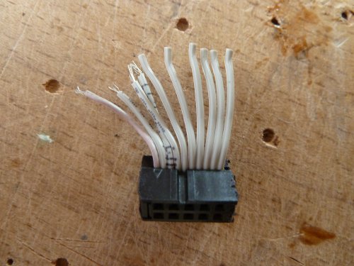

Just a hint for whoever need a connector for isolated pins at nearly no cost: an old ide connector
you know that screw terminal will be decimating any impedance matching you achieve with those u.fl cables right? its completely possible to turn that input into a bank of 4 x u.fl
