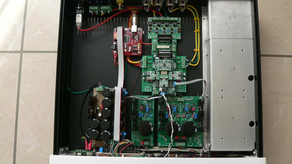

Hi PET-240,
I attach a few pictures of my original build. I will rearrange the backplate with all inputs directly behind the 4*SPDIF board.
What I have learned building the DAC is : KEEP INPUT SIGNALS and cables AS SHORT AS POSSIBLE!
Although The combination WaveIO - BuffIII is excellent, the DAC is rather picky about input signals. So you should deliver it signals as clean as possible. But when all is ok, you got you a top class DAC.
kind regards,
Henri
ps.: The interconnection diagram just gives an idea how to place the modules. Connections are not entirely correct.

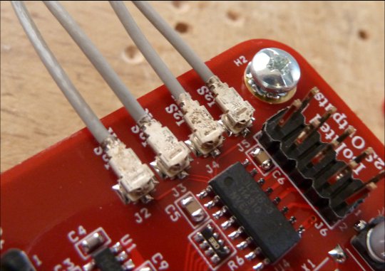

Henri, I can't be sure but it looks as though there is some difference in length of the i2s lines, I think matching length of these wires may be of similar importance to minimising the length, just a thought. Very nice work otherwise!!
A question I have been meaning to ask for a while now. Is it possible to drive one i2s dac from the u.fl connectors and a separate DAC from isol i2s output at same time without damaging/having visits from the nasty blue smoke monsters?

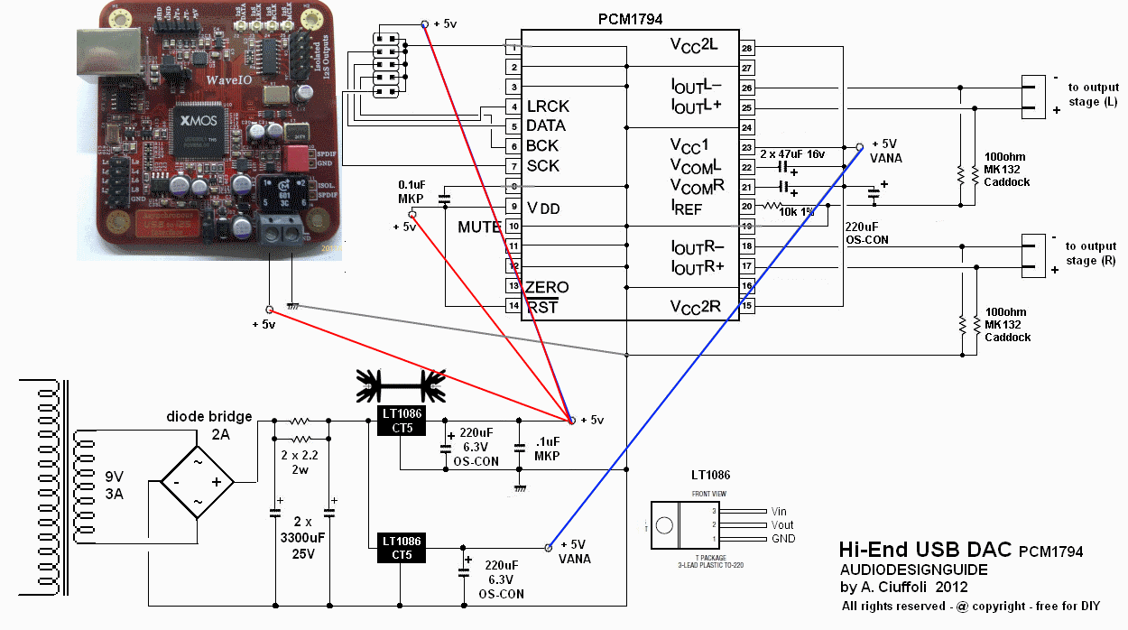

XMOS to PCM1794 schematic
USB DAC 2 - Hi-Resolution System
Andrea
The usb to i2s board got a +5V pin at the Isolated I2S Outputs. Where do you connect this terminal for connection with PCM1794 chip ? Will it works if I ignore this connection ?
Regards
I have used only 2 power regulators, +5V for all the digital section and +5v VANA for the analog section.
From the picture I see 5v pin (of the usb to i2s card) is connected to Vdd of the pcm1794. I this necessary when 5v psu is connected to the converter ?
see this and photos
Thanks for the photo. You made your point now when all 5v terminal needs to be connected.
If you want to isolate the ground of the USB-I2S module use a different power supply for this.
It means another transformer secondary, another bridge, another CRC and another LT1086.
In this case the heatsink is necessary only for the LT1086 connected to the USB-I2S module.
