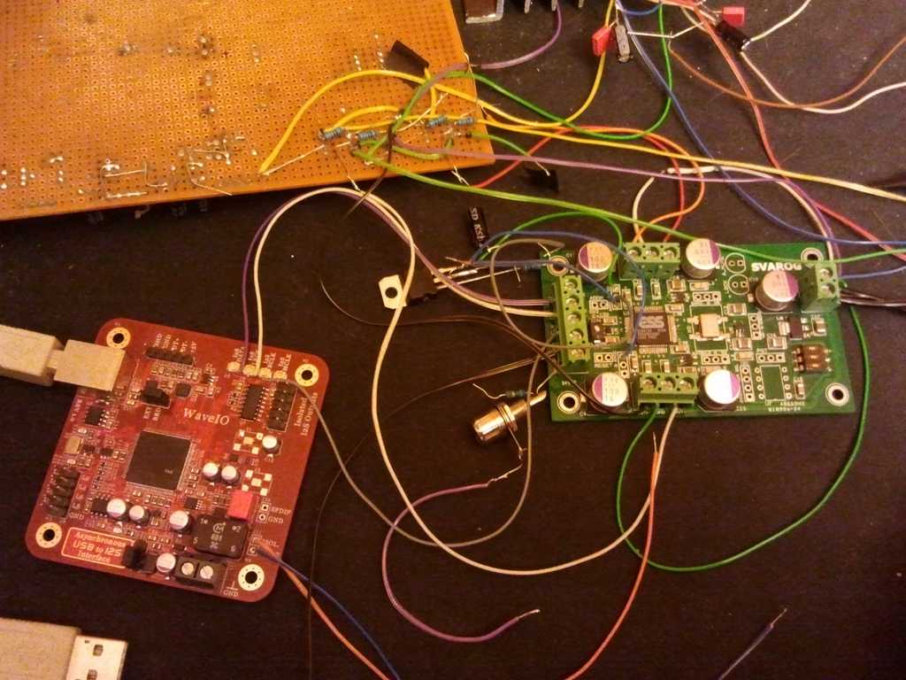

thanks for the trouble you took in answering my posts. I can tell you that the issue with I2S is solved. It was due to a partially activated relay all 3 I2S lines were not connected with the DAC. I now can stream music but the dac loses lock constantly. I suspect HF radiation, airborne and transported via cabling, is the reason the dac is losing lock. I plan to do a decoupling of all power lines locally by means a few capacitors.

The problem with losing lock is not a problem of the WaveIIO board. I can see the card is constantly streaming data without losing lock.
It would be nice if you could help me with isolating the locking issue,but i also realise it is very difficult to diagnose something from a distance. The people at Twisted Pear are very helpful and do all they can to help me out.
Let me know which pictures you want, Lucian

Lorien's board is not to blame for losing lock.
Look at the mess that works perfectly for me ATM.
NEVER lost lock.

@Kovax: You are right. Lucian told me to connect WaveIO directly to the input terminal of the BuffalloIII. After that: music and nothing more. After listening for a few hours I can tell you The WaveIO board and the BUffaloIII are a killer combination.
