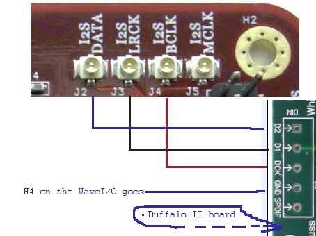

Hello Lucian,
Can you tell me how a I2S data signal should look like? I have a problem my Buffalo III does not accept the I2S signal coming from WaveIO.
I could check it with my oscillo.
kind regards,
Henri
kind regards,
Henri

I2S should look like digital data. Unfortunately, a single-trace 'scope cannot tell you whether the data is good or bad - you really need to see the clock and data on the same time scale. Often, if I2S is not working, it's the polarity of the clock or the timing / phase shift between clock and data. There should be data sheets for both the Buffalo III and the I2S chip on the WaveIO that you can compare to see what needs to happen for compatibility. Note that my answer is generic to all I2S links, since I have not used your specific setup myself.Can you tell me how a I2S data signal should look like? I have a problem my Buffalo III does not accept the I2S signal coming from WaveIO.
