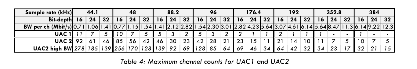

. UAC2 does a 1024 byte frame every 0.125us which amounts to 65.536Mbits/s.This can barely fit 14 channels of 24bit PCM audio @192kHz FS/24bits.
Also did this a years ago, I used just 8 channels PCM-192/24 and 6 at DSD128 in one design, and 16ch PCM96 in another.
P.S. Are anybody implements UAC2 high BW?
Ross (from XMOS) promised to do this few years ago....
This can give us much higher number of channels (or higher sample rate).
