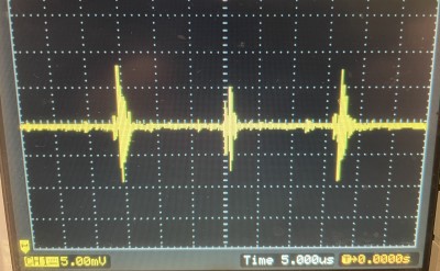

Trying to swap dc-dc 1.0V supply to linear regulator on XMOS. Overall the picture is much better and sound is better, but with a constant frequency in the processor power supply circuit there is interference. I understand that the processor itself makes this noise on the power bus. Any ideas how to get rid of interference or it is normal on processor power rail ?
WaveIO card (to which this thread is dedicated) does not have Switching Mode Power Supply (SMPS) regulators on it! It has been already taken care of starting with 2011. One of the reasons which lead me to that decision you can clearly see it on your scope. In your case, perhaps a passive filter tuned to that freq. will lower those spikes. A better approach would be just remove the SMPS Vreg and replace it with a linear variant.
Edit: you can ask for help on a dedicated thread as I'm sure there are out there guys who know better what to do and may help on your specific issue!

Which PCB are you using? One way to avoid processor switching noise in the analog circuits is to have completely separate power traces for digital and analog, along with sufficient bypass filtering on all chips - both digital and analog. One common practice is to place two different capacitor values in parallel - the frequencies that one cap lets through will be filtered by the other. Bottom line: Since the processor draws a spike of current on every clock pulse, the power rail voltage (both power and ground) will see the increased voltage drop due to that current spike. If analog circuits share the same power rails, then the analog circuits will see voltage spikes on power and/or ground. Keeping the analog power supply current separate from the digital power supply current avoid this. (I started reading this thread years ago, but have no read all 173 pages, so apologies if you already mentioned which PCB you're using).Trying to swap dc-dc 1.0V supply to linear regulator on XMOS. Overall the picture is much better and sound is better, but with a constant frequency in the processor power supply circuit there is interference. I understand that the processor itself makes this noise on the power bus. Any ideas how to get rid of interference or it is normal on processor power rail ?
