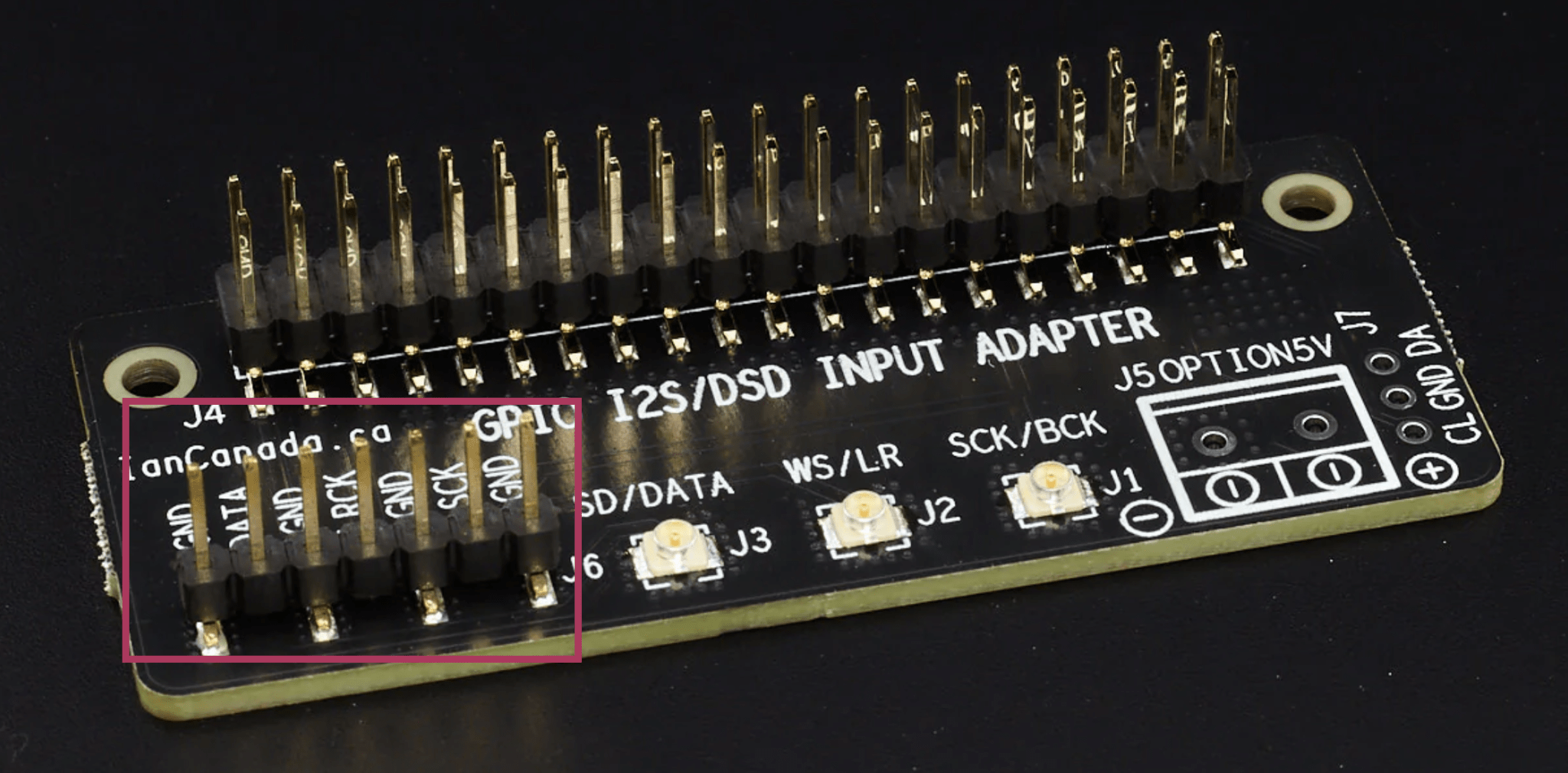

Wondering if anyone know if WaveIO Usb can be fed as input to IanCanada's Fifo pi? what i'm looking for is a way to get the Frequency info out (44/48/88/96 etc). I know the monitor Pi gets that info, I also wanted to build a control from that frequency info. The waveIO usb has headers that give that info easily.
Any reference pic would be extremely helpful.

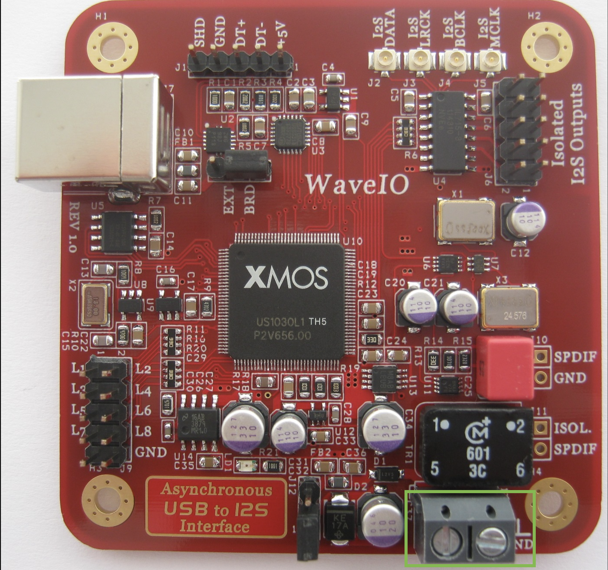

Thanks @dddac . I did some research on my end. Would this understanding be correct?
1. On the WaveIO usb board use the isolated output
2. For reference use the Fifo extension board to take input from the waveIO board (this is just for reference, we can prolly directly use the FifoPi input)
Then
1. Connect all the GND in the fifo adapter to the WaveIO isolated GND.
2. Connect waveIO DT -> Fifo extension DATA
3. Connect waveIO LR -> Fifo extension LRCK
4. Connect waveIO BC -> Fifo extension SCK
RPi hats are designed for 3.3V data signals (that's what RPi GPIOs output). The isolator requires power supply for the isolated side and you want to keep the output signal around 3.3V, not 5V.
Are you talking about the WaveIO external power (green box) or the FifoPi clean side input (isolator). Sorry a noob question.
The waveIO manual says
The NVE's IL715 isolator accept 5Vdc or 3.3Vdc power supply on the V+ pin to work
So I'm guessing the green box?
  • Thank You
Reactions: NeoTheOne

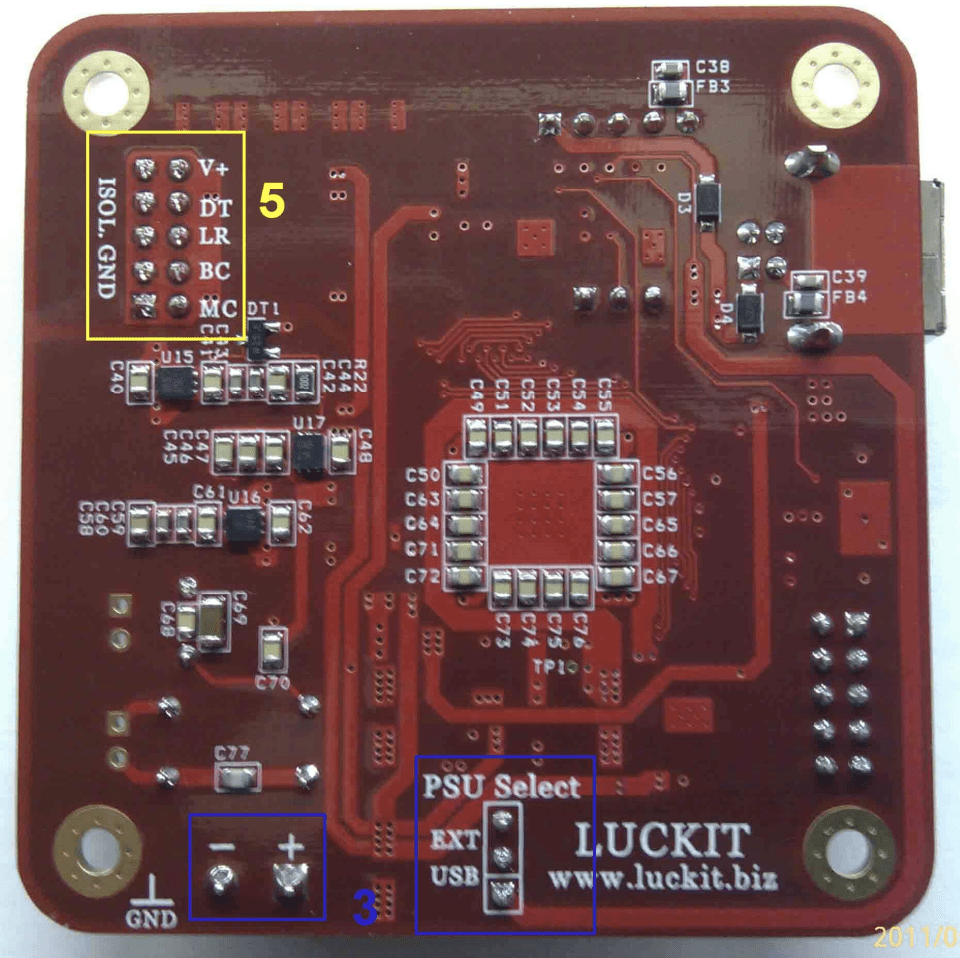

I'm trying to use WaveIO with a miro TDA1541A dac but having some issues getting sound out. The DAC has LRCK, BCK, DAT, and GND connections. I am connecting those to LR, BC, DT, and one of the GND connections on the J5 header for isolated outputs. To V+ and GND I'm connecting +5V and GND from a power supply. I'm powering the waveio using usb power.
Any advice on troubleshooting this would be appreciated!
