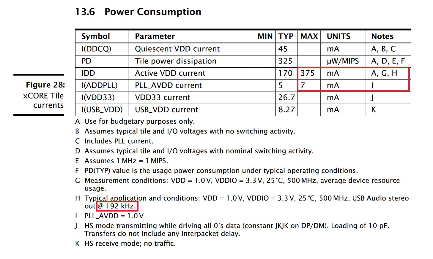

See please attached picture: if you stay at/under SR=192kHz, in case of XU208, I would recommend to consider about 380mA for 1V0, as the worst case.
As Lorien said, there are a lot of other apects you should take care of, too.
I like altor's solution, with TPS72010, even if it has a max. 350mA. Its main advantages are that it accept 1V1 as minimum input, it is cheap chip and it has good enough specs. I will try it in the future with pre-stage 5V0 to 1V2.
Meantime, waiting for TPS62912 (or TPS62913) back on stock.
I use 1.8v pre-stage because I need it for other purposes.I like altor's solution, with TPS72010, even if it has a max. 350mA. Its main advantages are that it accept 1V1 as minimum input, it is cheap chip and it has good enough specs. I will try it in the future with pre-stage 5V0 to 1V2.
Even with the maximum regulator current of 350mA, power dissipation is (1.8-1)*0.35=0.28W, which is less than 0.615W allowed at +85C.
I am using XUF208s and I don't think I've seen total power consumption going over about 350mA, so even in the case of going from 5V down to 1V we are talking about 1.4W of power, which can be relatively easily dissipated by a 4-layer PCB's ground plane.

According to the datasheet, the maximum consumption is 382mA(VDD+PLL), but I believe this is in projects with all cores active at full load, the typical consumption is reported as 175mA(VDD+PLL)only.
With the LT3045 working in 1v8 to 1v0, we have from 140mW to 306mW. I believe this is easily dissipated by MSOP12.
But this is just speculation, I haven't tested it yet, as soon as my parts arrive I'll put them to the test under these conditions and analyze the behavior.
**4v0 to 1v0 makes pcb design easier, but +500mW in typical consumption, doesn't seem like a good idea initially.
