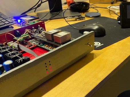

Rpi4 - piCore - WaveIO
Hi
I`ve been working on a streaming solution with Rpi4, piCoreplayer OS, USB out and my WaveIO for a while now and I can`t get the samplerate LEDs to lit up.
Host active and Audio streaming gives light, after hours of fiddeling around in the software, but not sr.
With my old Touch, USB output, LED sr works fine.
I think my WaveIO is from 2014 or 2015. Max sr is192, 8 LEDs in total. I made a very nice front panel with engravings for sr, so I would really like to make this work with Rpi4/piCore. Is it possible to update firmware? Found a link a few pages back, but it did not work.

Not sure if the firmware is at fault, but mine is able to recognize and display the sample rate of streams I'm putting through.
This is with an RPI4, USB, WaveIO. I am doing this with Volumio, though, which - as opposed to PiCorePlayer - is able to recognize the WaveIO and accurately name it as the device connected to USB when setting the options for audio out.
Not sure if your issue is related, but I dropped PCP for this reason and have been running Volumio. Which has its issues, but the sample rate displayed by the LEDs is always correct and reflects what Volumio reports regarding the incoming stream.
Hi andRookie,
Sample rate display did not work under Linux roughly since kernel version 3.10. @Lorien fixed it September last year (see post #3252). Using firmware v6.F2 the LED output works with current Linux kernels (5.4 and 5.10 tested).
You can find firmware files on luckit.biz on the 'Support' tab. There used to be an instruction pdf also; since I cannot find it anymore, here my update notes from the last upgrade:
