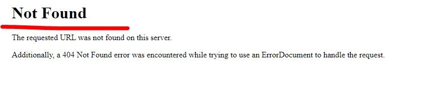

Link seems not to work Lucian?
Hello all and Happy New Year!
It's my first post on this new and updated DIYaudio forum! Nice looking thing BTW, but my head is spinning around a bit to find what I'm looking for 😊
@ vessk0: maybe my question is weird but what you mean about "double digital conversion"? I'm having some ideas in my mind but I just want to be sure we are speaking about the same thing!
@ Doede: that link is not available anymore because it was a page built solely for Black Friday offer (2021)! If you hover your mouse over "small update" text you'll see what I mean! Anyway, feel free to PM me for clarifications! 😉
