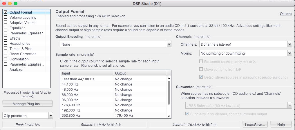

I mange to play anything now, DSD64, DSD128 and DSD256. The only strange thing is that when I play the DSD256 files from 2L (The only one I have) the buffalo detects PCM 176KHz instead.
Not really a big issue as there are not really content available and I am not sure where is come from. It could be that JRiver is doing something. I am curious if you have something similar.

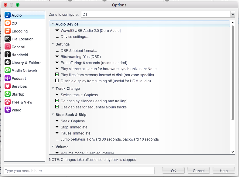

Tools > Options > Audio > Settings.
BTW I don't use JRiver....

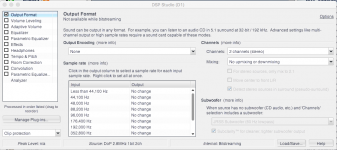

Attached are the settings. Reading on the bottom of the windows you can see what actually happens when playing DSD64 and DSD256. I guess Jriver converts DSD256 to PCM 176 on the fly, for some reason.
For the rest, everything if pretty cool !!!
D.

Well the computer does not have visibility on what DAC I use. If it would output DSD256 and the DAC would not support it, I would just get no sound. In this case, it actually works, but JRiver takes the initiative to convert it to PCM.
It's just a curiosity, as I don't get to use it.
