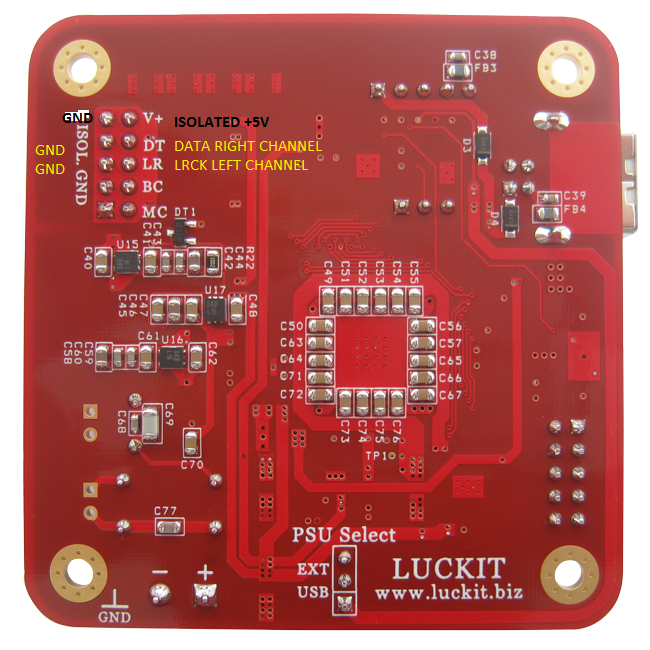

Hi Guys, I am about to use the WaveIO to provide I2S to a Metrum Accoustics EVA Dac board -
All Engineering
I have previously used the WaveIO to run my DDAC boards, my question is how to power the Isolator chip for the isolated I2S output. The DDAC had provision for this, the EVA Dac does not.

Of course you can't use the same PSU for powering the WaveIO.
Merlin, I have used the same PS for the isolator as the one for Ian's PCM converter and this first goes through a buffer (K-multiplier). Thought that would be OK.
Do I understand that is not a good practice (either)?
see ians thread
albert
Albert is ok because using the Ian's PCM converter PSU you are isolating the PSU coming from the self powered USB or external WaveIO psu. You musn't share self powered USB or external WaveIO psu with the I2S isolated outputs psu because if you share you aren't isolating....

I have some troubles in my DAC: I cannot go above 88 kHz. The 88kHz looks fine on the scope.
I use the WaceIO isolated output to feed the PCM card of Ian; but also the not-isolated MCLK!
So there is a possible fault in my 'architecture'.
I have been thinking about the power supply, I see flaws in my design (remote box with transformers) and the feeding earths have capacitative and inductive coupling. But I also had almost the problem when I had everything in one box.
There are also 5 pins dedicated to isolated GND. They should be used.

Lucian,
- I break the isolation first of all
- secondly there is a time-lag in the isolator that is (inherently) not in the MCLK signal
I checked and I was wrong in the previous post: I have usedIn the documentation of the WaveIO, I see it mentioned:
Lucian,
Do I pinpoint a possible cause for the error I have?
DT = I2S Data,
LR = I2S Word Clock,
BC = I2S Bit Clock,
MC = I2S Master Clock. and this goes to the PCM-board MCLK. is that correct?

Well, I'm not entirely sure what's happen there but all connections above are as expected!
DT stands for I2S_DaTa,
LR is for I2S_Left/Right_Clock (or I2S_LRCK)
BC stands for I2S_Bit_Clock and
MC is I2S_Master_Clock
I'm really sorry for all this confusion, but I swear I'll put more texts on the silkscreen next time just to avoid all these situations!
Kind regards,
Lucian
