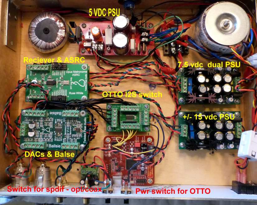

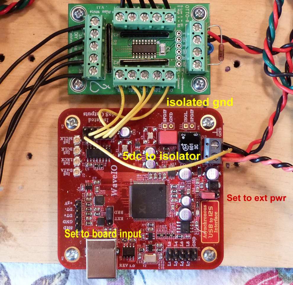

Hi Everyone,
Just got done hooking up a Wave IO to my Opus DAC, I'm using an Otto to switch the I2S between spdif receiver in and the Wave IO. The Otto is switching properly and when I set it to the SPDIC receiver I2S the DAC plays fine, switching over to the Wave IO I2S is silent, she won't sing. The Wave IO is powered by a separate 5 vdc supply the external power jumper J13 is set to ext and a small green on the board is lit. The usb input jumper is set to brd. The Wave IO I2S assignments to the opus that I'm using are BC (wave) to BCK, MC(wave) to MCK, LR(wave) to LRCK, DT(wave) to Din, and I've hooked an isolated gnd from the wave to the gnd on the opus I2S input. I have the isolated I2S V+ connected to the external 5 vdc psu that is hooked up to power the Wave IO board. I am trying to use a laptop with windows 10 as a source using Foobar 2000. Windows seems to recognize the Wavio driver but when I look in device manager it seems that it wants something else installed that wasn't in the setup. I've attached a picture of the message. I know that some of you have successfully used the Wave IO with Opus DACs so would be appreciated.

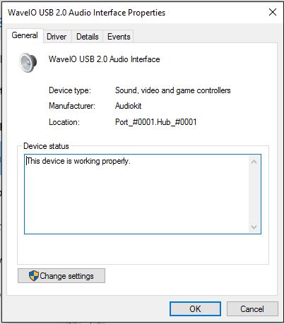

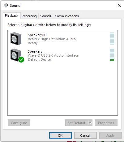

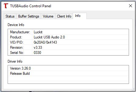

Hi folks, I've a couple of ancient WaveIO boards in various devices, just ordered a new one to go into a USB to SPDIF convertor. I've done this previously, using the isolated SPDIF output straight to a BNC connection for co-ax connection to the DAC. I'm now looking to add optical output and have the necessary, in this case Sharp, optical output connector. This requires 5V power, and I wonder if it's permissible to take the feed for this from the 5V input into the Wave board? I'm using an external power supply to feed the board.
Hi All,
I played around a bit today and managed to get sound out of the Wave IO. I needed to put it on USB power to get my PC to recognize the device reliably, after that I switched the power jumper to ext power. I needed to change my sound output device in windows to the Wave IO to get sound out, but so far things still need some work. the sound from both Foobar 2000 and Pandora streaming is full of crackles, like a beat up old vinyl record. Here are some screen shots. Does anyone have any ideas as to why this thing crackles ? I'll post some pics of my installation.
Paul
Paul

Paul,
You have a few potential issues there but you should start by NOT using WaveIO as the default Windows sound device. This setting sends all system sounds to WaveIO; you don't want that...
Nick
Hi Everyone,
Here are some pics of my install. Please let me know if I've done something wrong hooking things up. I tried several different USB cords, no change with any, still crackling like crazy. I have used these cords on another DAC that uses a ministreamer no issues so I'm supposing they are not the problem.
Nick,
If you could let me know what potential issues I may have I would greatly appreciate it. I'm not a windows or software expert so I'll be happy for any help I can get.
Paul

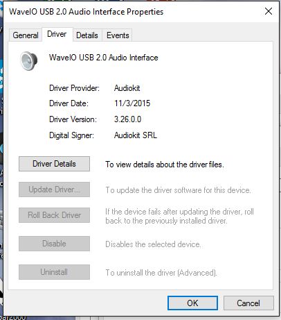

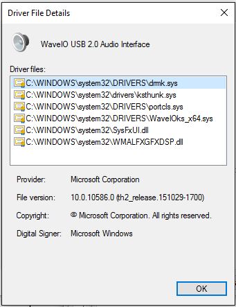

@PJN:
I'm pretty sure I'm no expert either but I'll do my best😱.
1. were you able to get sound from WaveIO without selecting it as the default Windows sound device? I think this is critical.
if not then..
2. your driver installation looks doubtful so you might want to try a re-run of the set up. then go back to 1. Post your result.
Push comes to shove you may need to bypass the Otto to make sure it's not a contributor but let's get this far.
Note that I do not use Opus nor the isolated output from Wave IO so won't comment on your layout😉
N.

@ PJN: looking at your pictures (and avoid upsetting anyone) I would say that the main source for your issue is poorly made wring. At least for I2S...
Let me add few reasons to sustain above statement:
1. As I can see, you wired the V+ pin (power supply of the output side of the isolator) to the +5V external PSU of WaveIO. This is NOT recommended since doing so, you will bypass this chip and its main function = to isolate grounds. The related "isolated" ground (which is reference for all i2S signals) is directly wired to Otto. So, since the I2S signals are NOT differential, there has to be a returning path back to WaveIO's main GND (as long as you powered the output side of the isolator with +5Vdc from J13 screw-type connector). Is there such a connection between the, let's say, GND of Otto (which is also GND of the output side of isolator) and main GND of WaveIO? Check this connection with a multimeter!
If so, how long this connection is? I ask because, for speedy I2S signals it really does matter! My assumption is the GND connections is made through power supplies... and if I'm right... this is a reallllly long path...
2. Secondly, I strongly advice you to bypass Otto - but only for testing purposes! After you'll solve your issue you can freely add it to your system!
3. Check if all your I2S wires have the same lengths and are as short as possible!
4. The simplest solution I see now is to bypass Otto and add a +5Vdc (or +3.3Vdc) wire from anywhere else than J13 making sure that main power supply rails of WaveIO (connected at J13) does not have a direct contact to anything else following output side of the isolator!
As for drivers, firstly I want to thank to Nick for his support but I would suggest you to try first at least one of above HW changes before reinstalling drivers!
Please keep me posted,
L
