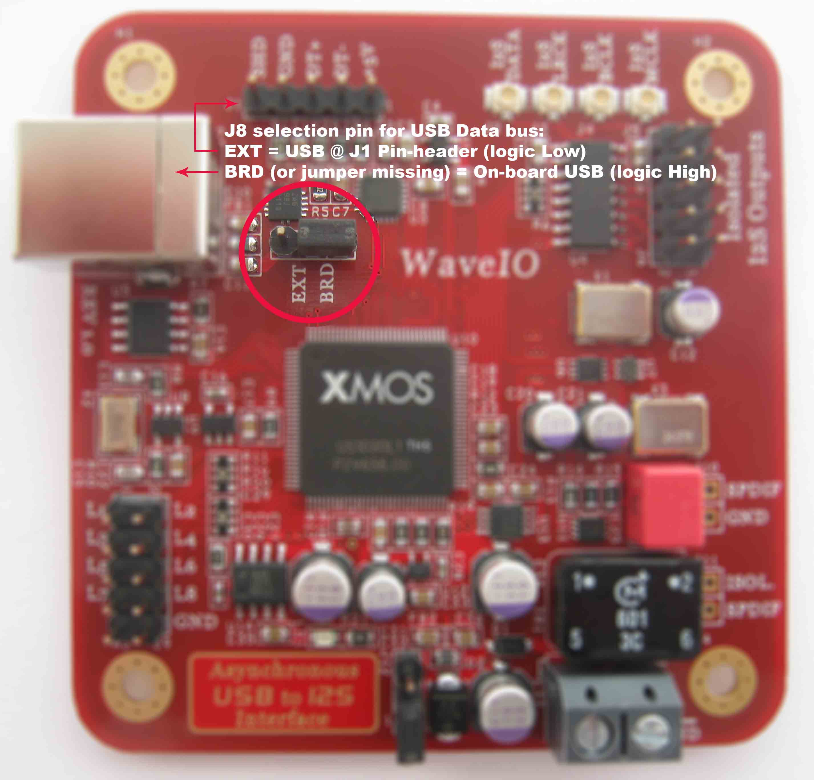

The usb power jumper setup correctly on Waveio?
daphile maybe needs to install on a HDD not an usb stick.
Yes.
Why, Amanero don't need it on a HDD?
Yes.
I use my WaveIO with Daphile on USB stick for 2 years. Does not require any additional driver.

Guys, quick question: Does Waveio require the 5v USB to be connected in order to be recognised by Windows? I have read that it doesn't but I cannot get it to be recognised without it so I am assuming that it does...or I may have a jumper set incorrectly!
[edit] Just to provide some more detail. I was hoping to be able to switch the 5v line off in the USB cable either completely or once windows has recognised the Waveio. What happens is that if I permanently disconnect the 5v, the card is not detected and if I switch off the 5v once the card has been detected then the card is no longer recognised correctly (I've installed a switch inline).
Can Lorien or anyone confirm whether what I am trying to achieve should be possible and/or whether I have a jumper wrong?

@Crom, check post 2295..I think it may have the answer you are looking for?

I have made sure that the GND is in place between PC and Waveio but still no go.
It's not a major issue but I've read loads that things sound a little better without the 5v connected and I wanted to try it out.
@ Crom: USB3318 ULPI chip I'm using on WaveIO does have a pin called "VBUS" (pin #2) which is directly connected to the +5V USB wire. I'm assuming it's not placed there for nothing... There's no sarcasm used here... I'm only saying this because I didn't have the chance to dig into the very depths of USB data transmission (as it wasn't required so far) since I'm focused on other fields (hardware mostly).
Anyway, I do "feel" most of the problems, many related to 'custom' USB cable (where +5V USB wire is not connected intentionally), have this broken connection as a starting point in solving those issues! GND is excluded!
As for your board, I do remember that you had some problems with USB multiplexer (or am I wrong?). That chip is also a weak point but it will be properly addressed on next PCB revision.

Thanks for getting back to me Lorien. I had read differing reports about whether +5v needs to be connected either at all, just for handshake, or continuously and I am trying to get to the bottom of it.
The reason I'm interested is (similarly) I've read various reports about the benefits to sound quality with the +5v disconnected - but obviously GND left - (or even disconnected after handshake) and I wanted to test these for myself.
I can't get the card to be detected without +5v connected and if I leave +5 connected until after handshake (a few seconds) and then disconnect, then the card is immediately no longer detected.
