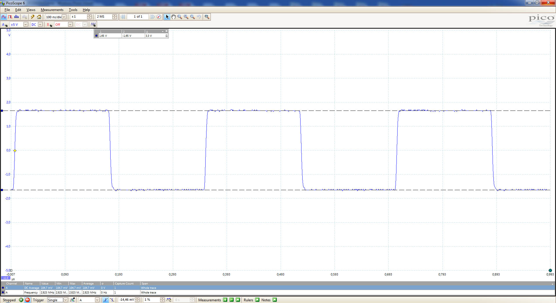

@ JMF11: as you already guess, it's a stereo platform so this HW does output only two channels.
Isolation: the topic is vastly discussed on this forum and others as well but to be as short as possible: it's a good choice when properly implemented.
@ triode_al: Thank you! I didn't had time to build up a document but hare are some details:
1. it's meant to play DSD over PCM but I'll do it after I'll finish tuning the hardware. In any case, the actual firmware revision does come with DFU feature implemented in it so future firmware uploads will be possible directly from your PC (like in most of WaveIO cases).
2. Those white arrows found on both sides of this board will indicate the flow of the signal (or power). The arrow pointing towards the edge of the board are stating that the corresponding signal is an "output". There's one pointing down - that's for Grounds.
3. 24/22 is a signal used to "control" external clocks and enable the one used to create the SPDIF stream. Since this board can be slaved to an external clock, you may need that signal. It's useful when you have a single clock generator capable to source two freqs. thus with this signal you can "tell" it which frequency to output. In case there are two distinct clock generators, each one outputting 22.5792 and 24.576 Mhz signals then 24/22 is useless.
4. "Output disable" is an input signal tied to the reset pin of the reclocking stage. It will simply disable the SPDIF output if needed.
5. PCM/DSD is meant to show when there's a DSD stream playing. Likewise for the corresponding LD3 LED.
6. J3 output pads are for the SPDIF output signal. This time I managed to build up larger holes with enforced vias in pads to prevent damage to the copper traces. I expect this idea to be copied soon enough by all kind of copycats 🙂
I didn't need trafo for isolation due to couple of factors, the most important one is the output signal. I'll try to attach a picture taken from my scope with my latest results of SPDIF tuning (from what I remember is taken after a 44.1 khz track was playing). Its not my latest achievements but close to it.
I hope you like it.
7. LD1 is "power" - will lit when board is fully functional. This means is not tied directly to one of the power rails and voila! No, this one is driven by the XMOS processor thus if the isolated SPDIF output side is not powered or XMOS have a problem then this LED will stay "dark".
8. LD2 - Active. Is used when a track is playing. Similar to "Audio Streaming" on actual WaveIO cards.
PCB Jumpers:
JP4 - if cut it will disable all LEDs but you'll still be able to get active signals from J5.
JP5 and JP6 - if cut, will disable local oscillators - both of them. It's used to get rid of additional noise sources when board is slaved to external clocks.
JP2 and JP3 - switching between local and external clocks. The best demultiplexer for me in this case is a base copper trace and a solder joint.
If anything to the PCB jumper must be made as was initial, a bump of solder will do the trick.
JP1 - SPDIF @ 3.3V / SPDIF @ 0.5Vpp. I'll get rid of this though and leave SPDIF @ 3.3Vdc.
J9 is for powering the isolated SPDIF side. It does require 5Vdc @10mA. Yes, 10mA.
You can use the power from USB bus by bridging the corresponding J8 pads. Anyway, there's a diode protection in case one is thinking to do "X" connections on power rails.
Well, that's it! As simple as it can be 😛
