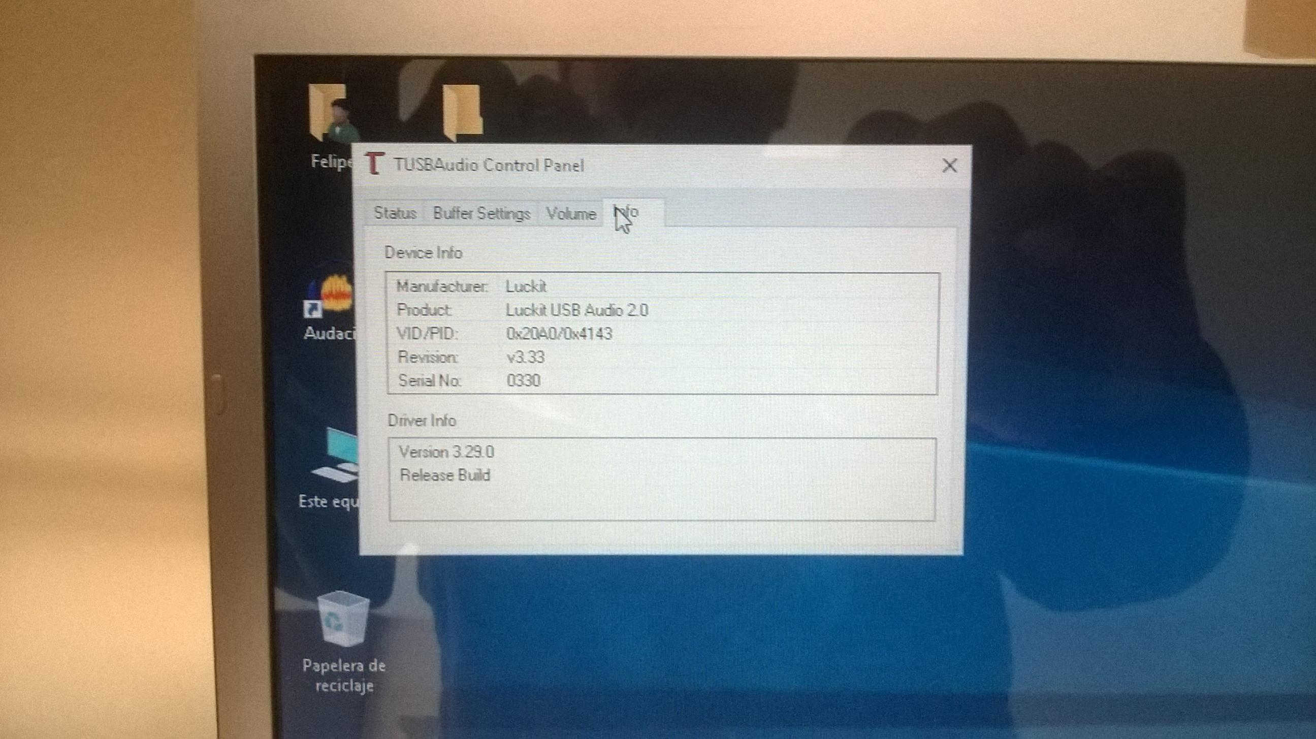

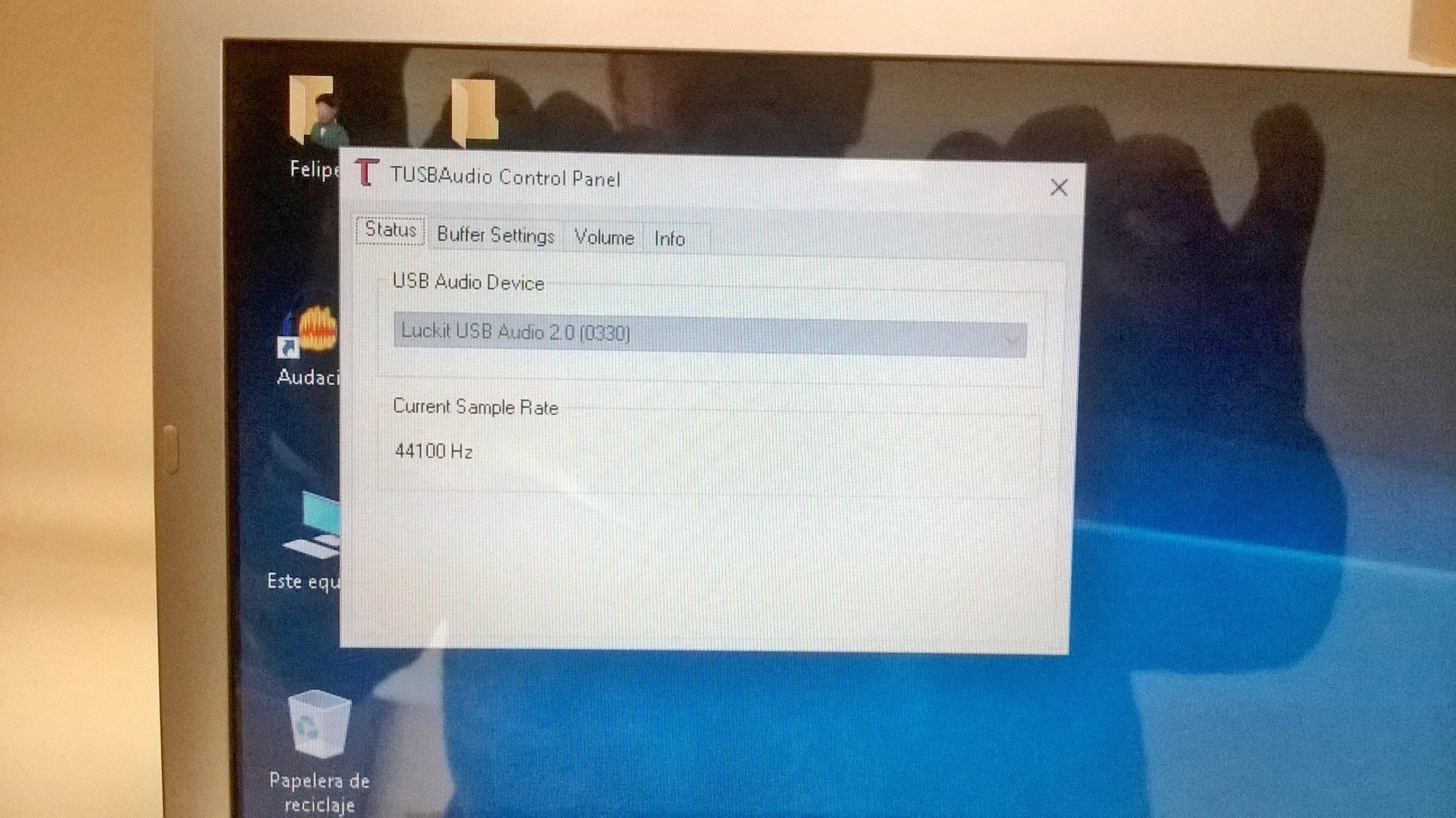

Lucian how to know the installed firmware? or better how to install your latest firmware?
Merlin, in your installed driver folder there are a few .exe files. Run one of them (I can't remember the name off the top of my head, maybe spy or controlpanel) and work through the various tabs and you will be able to see the firmware that is installed. Then you can get new firmware from here: Luckit | Audiophile grade DIY products (see the support tab).

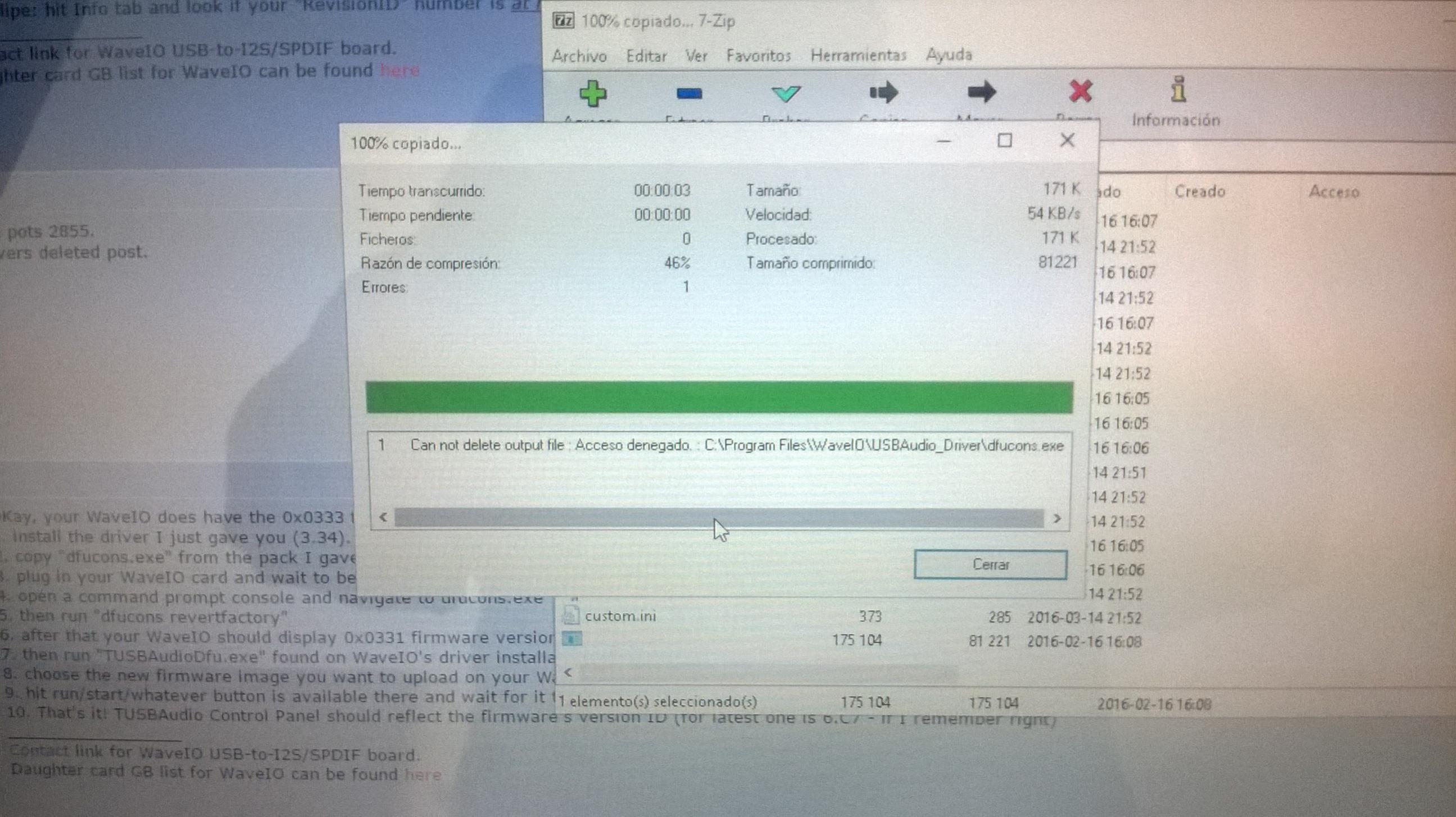

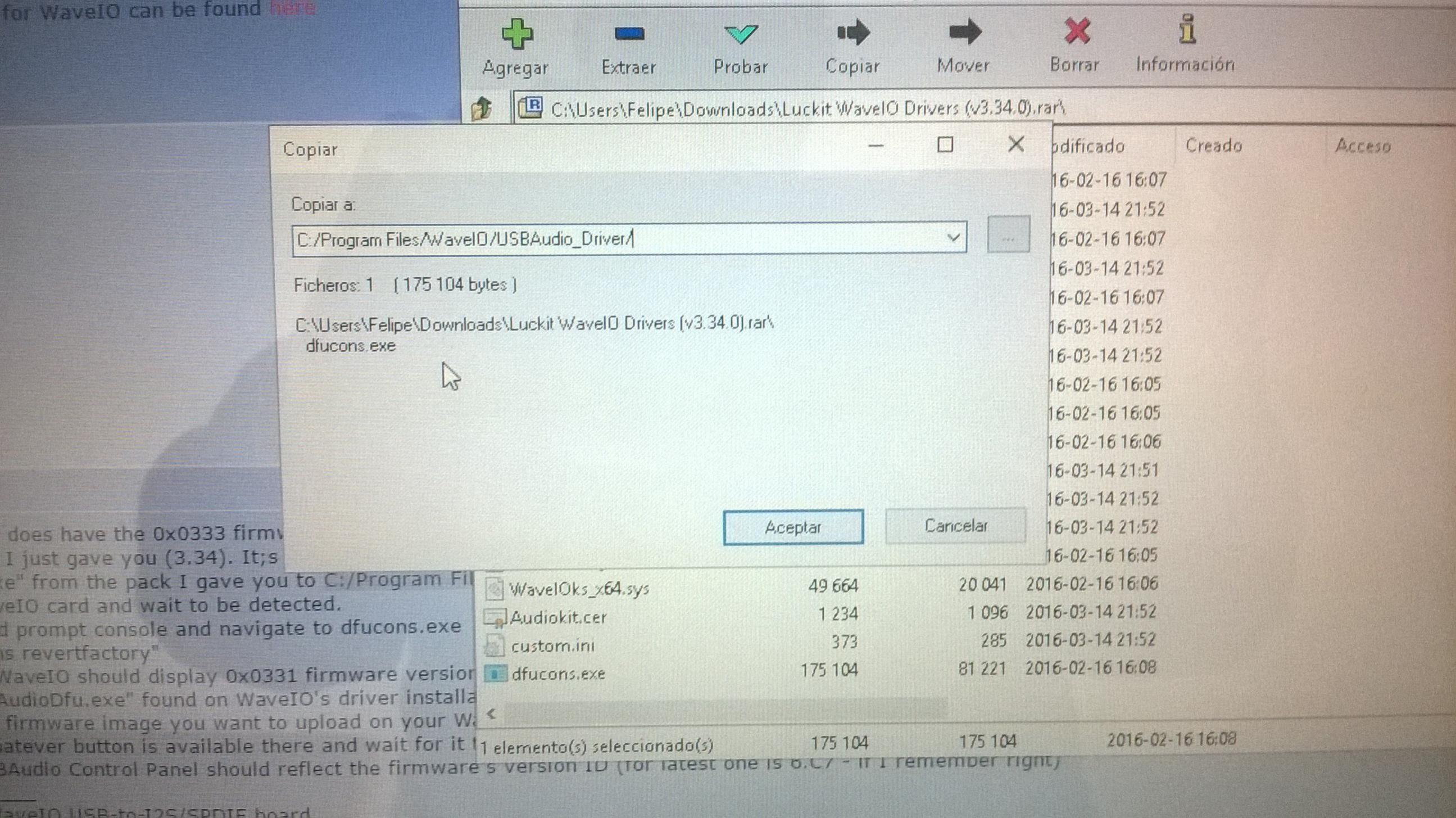

OKay, your WaveIO does have the 0x0333 firmware on it right now! To change it do the following:
1. install the driver I just gave you (3.34). It;s wiser to uninstalling the one you already have on your computer to be sure we will avoid any nasty complications (if any!)
2. copy "dfucons.exe" from the pack I gave you to C:/Program Files/WaveIO/USBAudio_Driver/
3. plug in your WaveIO card and wait to be detected.
4. open a command prompt console and navigate to dfucons.exe
5. then run "dfucons revertfactory"
6. after that your WaveIO should display 0x0331 firmware version.
7. then run "TUSBAudioDfu.exe" found on WaveIO's driver installation directory
8. choose the new firmware image you want to upload on your WaveIO
9. hit run/start/whatever button is available there and wait for it to be done.
10. That's it! TUSBAudio Control Panel should reflect the firmware's version ID (for latest one is 6.C7 - if I remember right)
Felipe, please extract all the files from that pack somewhere on your HDDs/SSDs and then copy it from there. I remember that you had troubles with your archive program in the past. DO NOT try to run/copy/move files inside the archiver.
