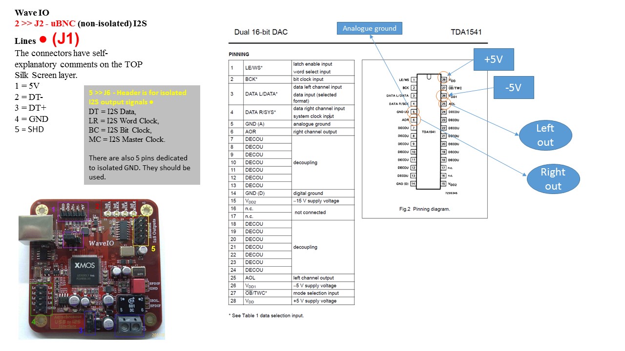

Found a clue here:
TDA1541A DAC through I2S : DACs - Page 2 - Volumio
The TDA1541A doesn't have SCK, it has; pin1 = LRCK, pin 2 = BCK, pin3 = Data, pin5 =gnd.
The TDA1541 has SCK. With the TDA1541 BCK, LRCK and data are the same pins as the TDA1541A, however, you connect pin 4 (DataR/SCK) to pin 2 (BCK), and it should work.
And I have TDA1541 (non A) so I am should know enough now right?

DSD Connection re-mapping
Hi Lucian,
We were able to experiment some more with this.
First of all this was only tested on the uBNC non-isolated connections. The connections are absolutely fine for PCM signals.
For DSD, the signal currently being sent to:
LRCK must be remapped to BCLK
BCLK must be remapped to DATA
DATA must be remapped to LRCK
This way you get the clock data on LRCK and the L/R signals on the correct pins. With the terminals rewired in this way we were able to play DSD64, DSD128 and possibly even DSD256 😱(I need to be sure about this so don't count on it!).
Hopefully this gives you the info you need. Let me know if you need additional.
Happy New Year
Nick

I have no idea when I messed up the output ports of XMOS chip so badly but here it is! In fact, if I remember correctly, I made couple of firmware versions on summer and this one is... I can't say which one for sure 😱
After all, it wasn't a very 'bad' idea to switch the I2S/DSD signals and look for the "right path", yes?
Obviously, when I said "just for fun" I didn't say it to offend your or cause troubles with your Wave board, just had a strong feeling that switching signals will somehow solve the issue... for the moment.
As for DSD256, if I recall correctly, there's an option in Foobar for DSD to DSD conversion and I was able to go up to DSD512... but for a short while as WaveIO seems to be *not so stable* for this sample rate... Still, DSD256 went smoothly on my Win7 x64 laptop.

Not a bad idea at all as it proves that all is well once the connections are right. 😛
And naturally no offense taken 😎
