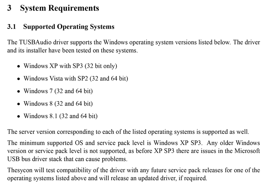

I also have the 0330 board and sorry to say the install failed (multiple times). I uninstalled 2.23 first and trying installing 2.24 with and without the WaveIO turned on.
It is failing right at the end. The dialogue says it is copying the CPanel App and fails to copy. But it copies everything before that successfully.
Never had any problems installing Thesycon drivers before with the same PC/WS2012R2.

@ Jonathan: I guess there are some changes to the driver installation procedure as well, like it was some versions before this one...and, once again, I'm a bit skeptical when it comes to this. On my side I tried these drivers on Win Vista, 7 and 8.1. If there were some errors or issues I would contact Thesycon immediately and not release this version as I have no gain in running into this kind of cases like yours and put WaveIO users on troubles!
Below is a list of supported Windows OSes taken directly from one of Thesycon documents. They mention Server variants as well! Like Massimo said before me, I kindly ask you to try again and see if there are any changes. I have to make sure that this is a driver issue or my stupidity 'in action' (as I customized those drivers... at some extent). If, indeed there's a driver problem, I'll forward it to Thesycon and ask for a solution.

Tried installing 2.23 back and that failed in the same way. Error copying WaveIOks.inf file. So it must be something in my 2012R2 set-up as I had 2.23 installed before.
Jonathan, I'll come back to you in the following days with a second version of this new driver.. the unpacked one... like all the variants up to v2.23. Maybe there's a problem related to that archive, who knows! It will take some time as I have to build it from scratch!
Meanwhile I'll search for advices to Thesycon...
L
Yes - I think so too. Strange though as I installed 2.23 before without issue, and haven't changed the set-up of 2012R2.
