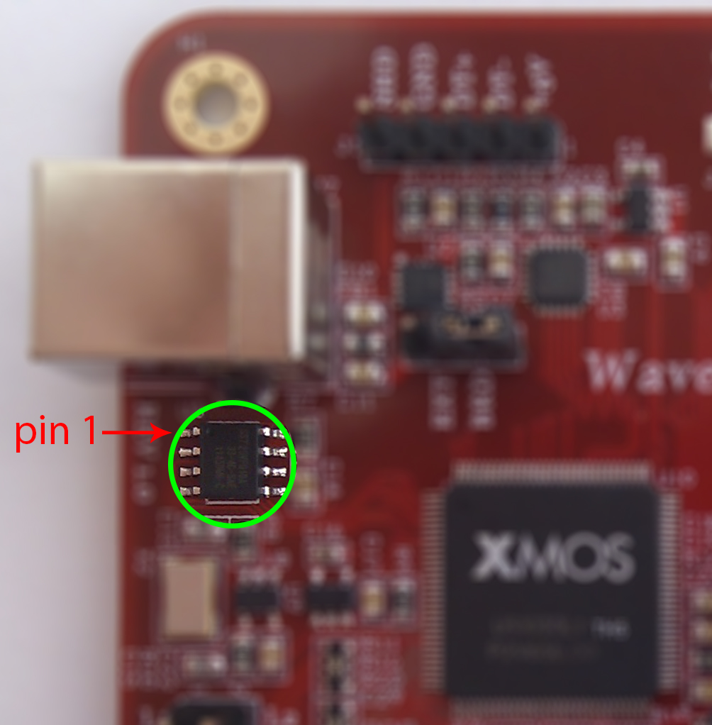

Hello kp93300, the chip can be easily see in the attached photo. It's a SOIC8 SMD part! I would say it's quite accessible to replace with a new one. Pin 1 is marked with a red arrow and is located closest to "U5" silk screen text.

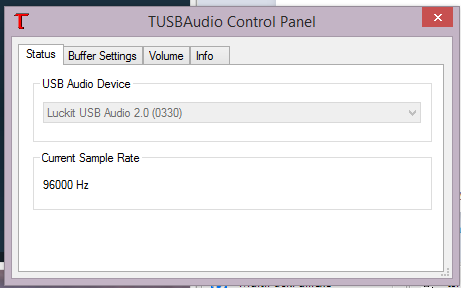

I am facing problems when I connect my DDDDAC1794 and WaveIO USB to my windows PC with JRiver20:
The latest driver is installed V2.23 and I have tried earlier versions. Everything seems to be installed alright, but when I want to play music, it sounds like stuttering and/or glitches.
In Jriver settings everything seems alright, I can see the USB DAC and it produces sound, but with the earlier mentioned glitches and stuttering.
Has anybody faced the same problems and knows a solution. I would really appreciate it.

Have you tried to change the values of the USB buffer from the TUSBAudio Control Panel? Maybe there are lower values than expected!

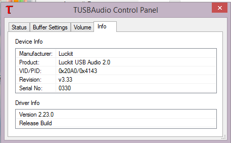

I'm reporting back after installing the 'test' firmware. I reset things as per previous poster recommendations - thank you. Driver is version 2.23. Tus control panel reported the presenceof the card correctly and read revision v6.60. However, no sound when I tried to play. I saw that there were bit depth options in the control panel. I don't remember these being here before, I tried both 24 and 32 but no sound. I use kernel streaming so could this be the trouble or is there another setting I missed?
As soon as I reverted to the older firmware v3.33 everything Played fine.
Any ideas?

Bit depth wasn't there... it's another new "thingy" for these drivers!

I should try to reproduce your setup and see if here I'll get the same results. I should confess that making that firmware to work on WaveIO wasn't a simple task to do and when I finished my system was already messed up. I usually work with Foobar so it is possible to try out the same settings with this player?.. at least we could speak with the same "language". 🙂I'm reporting back after installing the 'test' firmware. I reset things as per previous poster recommendations - thank you. Driver is version 2.23. Tus control panel reported the presenceof the card correctly and read revision v6.60. However, no sound when I tried to play. I saw that there were bit depth options in the control panel. I don't remember these being here before, I tried both 24 and 32 but no sound. I use kernel streaming so could this be the trouble or is there another setting I missed?

Hi Lorien, thanks for getting back to me. My hardware setup is as follows:
USB out > Waveio (using I2S) > Ian's FIFO board > Buffalo IIISE
The software chain is:
Windows server 2012 > JRiver v19 set to Asio out (JPLAY driver) > JPlay using Kernel streaming > waveio drivers 2.23.
Everything works perfectly using firmware 3.33 - ie I can select Kernel streaming into waveio and sound is great. However on the test firmware the option to select kernel streaming is not available and no sound ;-(.
Hope this helps,
Crom
