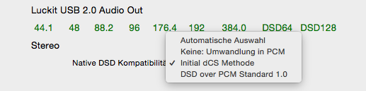

Some points on my system (Mac with Yosemite):
- You changed the name of the WaveIO (or it would be recognized with a wrong name)!?
- another DAC would be recognized correctly with DSD functionality, the WaveIO not (i can choose of two presets manually setups but then i hear then some "ticks" in the playback), DSD capability not shown in the player (Audirvana Plus)
- the biggest problem is for me that 384khz not more possible is! If i sect on my system resampling to max (32bit/384khz) there is not playback anymore.
How can i help you to fix these?

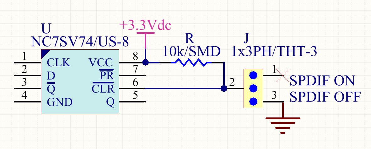

This time I have non-typical hardware question: is it possible to easily switch-off the SPDIF signal from XMOS?
I mean a comfortable switching-on/off the signal processing inside the XMOS, not simply powering-off/on NC7SV74 driver before SPDIF transformer (+Vcc pin-up). This is the only "primitive" method I am using now.
When using i2s output it gives slightly better sound.
When using old DACs with SPDIF signal input - I simply solder the 8th pin of NC7SV74 back to +Vcc.
Anybody tried this kind of improvement?
Best regards, Piotr.

Hello Piotr,
thank you for your kind words! I would strongly advice against desoldering too many times that VCC pin of the Flip-Flop chip otherwise you can damage the part. I didn't thought at On/Off switch for SPDIF but if you really need one solution then I'll look for it!
Kind regards,
L

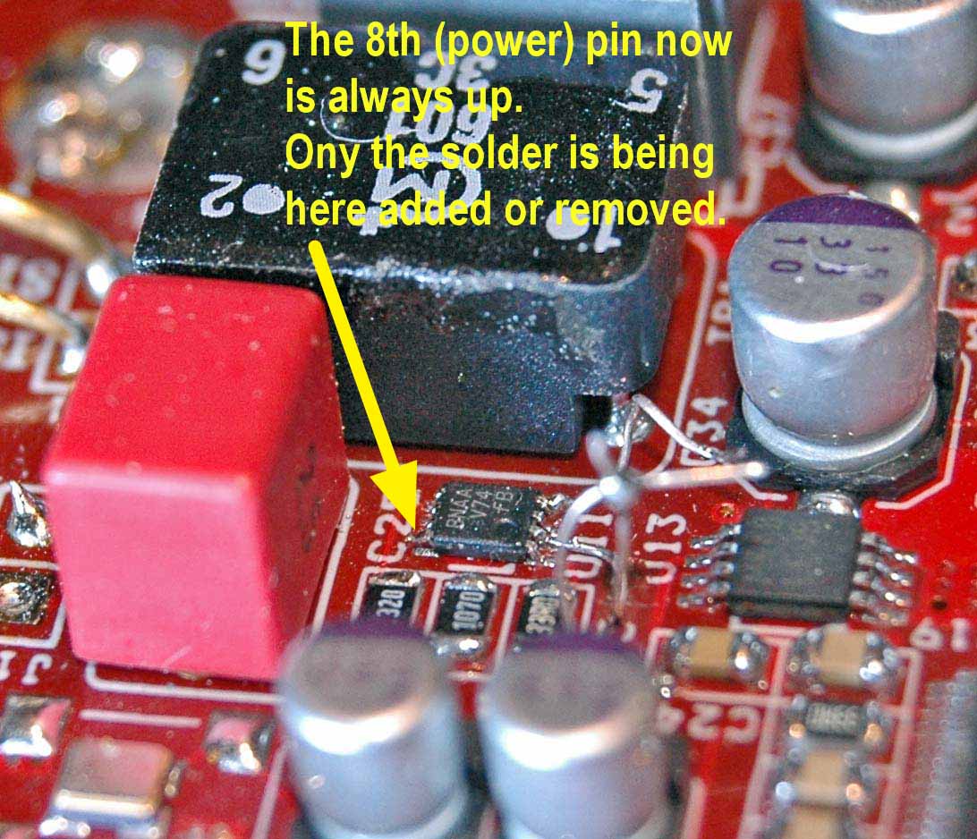

Hi again, Lucian.
Of course, you are right. The desoldering procedure here is always very risky. To perform it from time to time I use: good desoldering braid, magnifyiyng glass and a special tip for soldering iron. Pls see photos attached.
Soldering back is much more easier. Small drop of a solder at the iron's tip is enough...
Much easier and better would be switching on/off the SPDIF coding process with XMOS processor itself. Digital noises together with some power supply would be also saved 🙂
My discribed method is risky & primitive as SPDIF signal is still outside XMOS. Only the signal path is shorter. Anyway, the "cleaner I2S" music effect is always slightly better: the resolution is higher and timbre of voices is more natural.
The above effect does NOT mean that XMOS-generated SPDIF signal is bad. Sometimes, for testing different DAC's equipped with SPDIF input only, I switch-on the power for NC7SV74 and I connect SPDIF cables to the trafo output. The quality of music decoded from PC-USB and coded to SPDIF is still very good.
Piotr

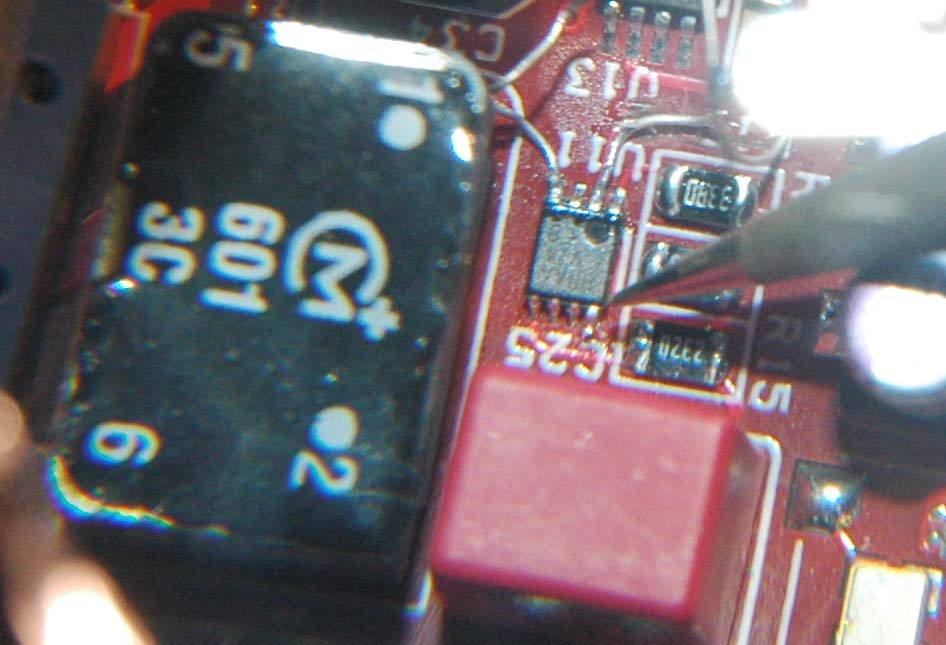

Even if lifting the power pin is the best choice here, you can also try your DIY skills with the CLR pin of that FF. I mean to leave the power at its place, lift the CLR (pin 6) and solder a thin wire to it.
Stabilize that wire on something to not go away with the 6th pin from the chip and solder a pull-up (10K) resistor to it... pull-up wired to any 3.3Vdc PSU you'll find nearby (see picture attached).
When you put CLR to ground = bye SPDIF otherwise (leaved floating) you have SPDIF signal on output(s).
After I saw what you did on your Wave board I'm sure you'll enjoy it! More than this, if you get into troubles I'm here to back you up... just be careful though! 😱

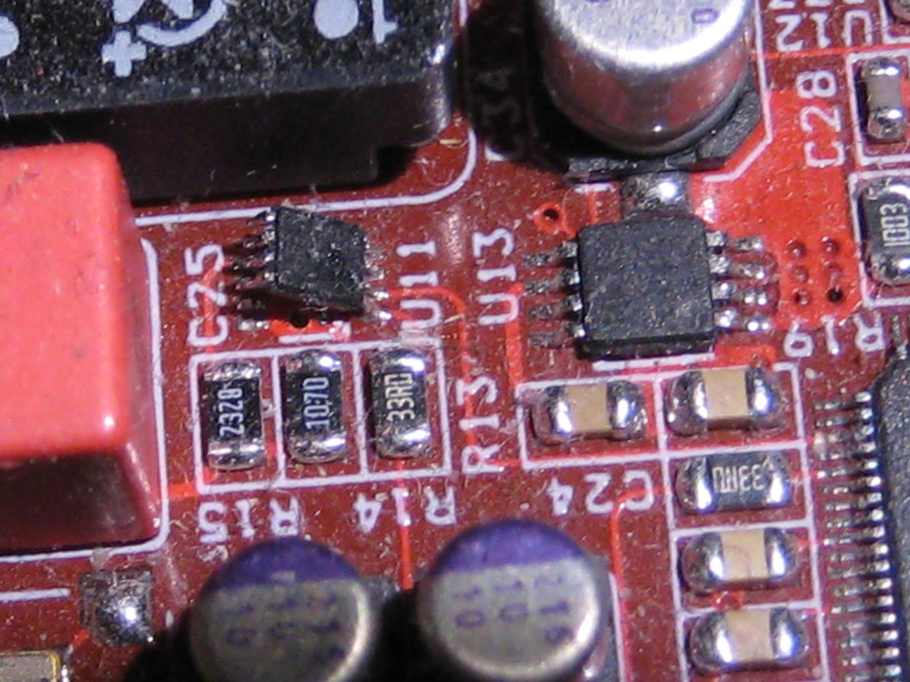

SPIFD ectomy Success
Thanks for the tip Piotr. Base on your report, I took the plung and removed U11, effectively removing SPIFD from WaveIO to make it dedicated to producing best possible I2S signal..
Outstanding!. Improvement is not subtle. WaveIO was always great. Now Outstanding.
There is a significant sharpening of every sound in 3d space, and an improvement in micro detail and dynamics.
I have a well resolved system. Improvements in source are evident. In this case everything sharper and more focused and 3d. Slight digital edge removed taking one step closer to analogue. More and better defined bass. Complicated busy music that was previously muddled is now perfectly defined layers in 3d. As Piotr described, voices and treble even more natural. 😀
The chip is tiny. How Lorian assembles these by hand is beyond me. So clearly care is required. With strong magnifying glass and good light I can not imagine desoldering the #8 leg. So I simply carefully pried the entire IC off with a flat screw driver. It popped right off clean. Then checked carefully for no shorts. Powered it up and Nirvana.
I am sure you risk destroying your board, so proceed at your own risk. I think when ordering your board, if you have no need for SPIFD, you should ask Lorian to leave U11 off the build.

My pleasure. I am a big fan of WaveIO, and had no idea it was possible to squeeze a little more out. I should have taken a picture of the board after the operation and it may be a while before I am back in there. To be clear, U11 is the tiny square IC that Piotr points at with his fine point soldering iron.
My soldering iron is the size of the entire IC, so no way to lift a pin. I figured that worst case, a couple of legs would be left behid that could short out the pcb. If that had happened, I think it would be pretty easy to clean itup with solder removing braid. But no worries, the legs stayed with the IC and snapped off clean on the pcb.
Thank for the picture, it explains very clearly what you did.
How are the pads on the board now? Can they be soldered again?

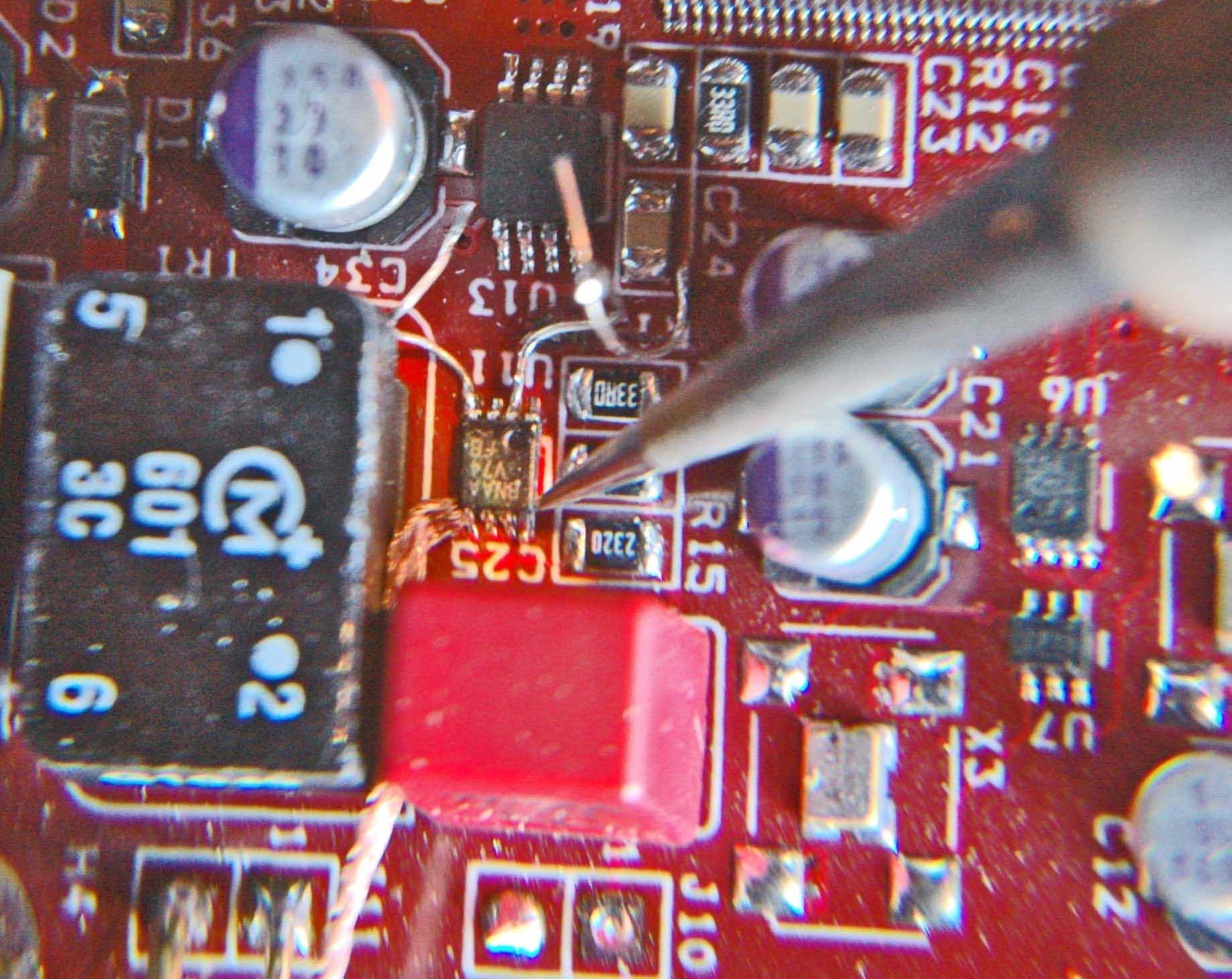

Guys, this is great feedback. I will be doing this if I can get the baby to go to sleep for 30 minutes!!!
Anyway, in the meantime, do be very careful about prying that chip off as the tracks may get damaged. It's a little extra money but this is very useful and I seem to remember you used to be able to order samples from them. It makes removing chips like that a doddle:

Hope this helps and I'll report back when I've lifted the leg!
