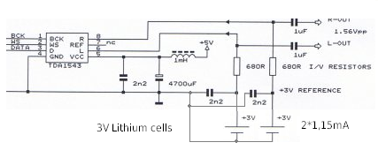

I have a strange problem with a WaveIO board and a lonely 1543 DAC. I have built a DAC as per attached shematics and just added a WaveIO board. The strange thing is that the digital input signal is so loud that I have to lower the volume in Foobar2000 - 50 dB or thereabout to get distortionfree sound. It is like the DAC (or WaveIO) is amplifing the input signal. I have found a thread that seems to discuss a similar problem that they call "a four cycle shift on the word select line causing a x16 digital gain". I have absolutely no idea what that means but is there a solution to the problem?

@ Vbenonisen: From what I know, WaveIO isn't able to amplify a signal. it's all related to how your TDA DAC is decoding and "understand" the 32 bit I2S signal coming from your Wave board. For the moment there are no solution to this from me, at least not in firmware. Most probably you'll need an adapter to convert the 32-bit I2S streams to the one(s) accepted by your TDA chip. Sadly there are no plans for this at the moment as time is not.. on my side.

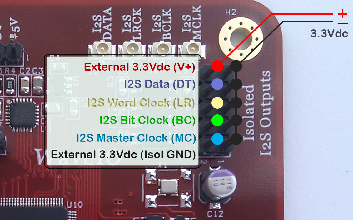

Which I2S output are you using? Isolated or non-isolated? Isolated needs 3.3V or you will have no signal.
Get the manual. You need to supply 3.3V to the isolator in order to get a signal out... or use the unisolated ones (U/FL). 😉
I connected the isolator chip to external 3.3v power supply.
But no sound with CS4398 in I2S.

Hi all. I've been happily using the waveio for some time. There is however a niggly low level hum that's ever present with the usb cable connected. I'm running the waveio board itself off a separate 5v supply, board is not grounded to the case, and using the isolated i2s output, which has its own 5v supply.
If I change the jumper to use usb power I get a lot of noise as well as the hum. So the offboard supply is definitely much quieter.
With the usb cable disconnected there's complete silence. As soon as the cable connects I get the hum.
Any ideas on how to troubleshoot and resolve?
Off the top of my head: Have you tried isolating the power coming down the USB cable? I just use a bit of electrical insulation tape over the appropriate pins on the USB B plug? Or better still isolate at the other end so that you avoid having any power in the USB cable at all.
I think the I2S needs 3.3 not 5v.
My waveio is in a wooden case and not earthed but I don't get any hum. I have spent quite a bit of effort earthing the PC at various points though with good effect. Just for clarity...I never had a hum but it just improves the sound the better the earth.
Hope this helps.
Hope this helps.
Thanks Crom. I just tried putting insulation tape over the power pins at both ends of the usb cable but no joy, still the same level of hum as soon as I connect the cable.

Hmmm, OK, I'm guessing that it's coming down the ground lead of the data connection. Have you tried a different USB socket on the PC? Or a PCI card rather than a motherboard socket...clutching at straws...
If the hum is around 50Hz then it'll prob be mains hum. A bit tenuous but any mains lead running parallel to a signal lead?
Otherwise it's probably a ground loop but someone more knowledgeable will have to help out with that one ;-)
