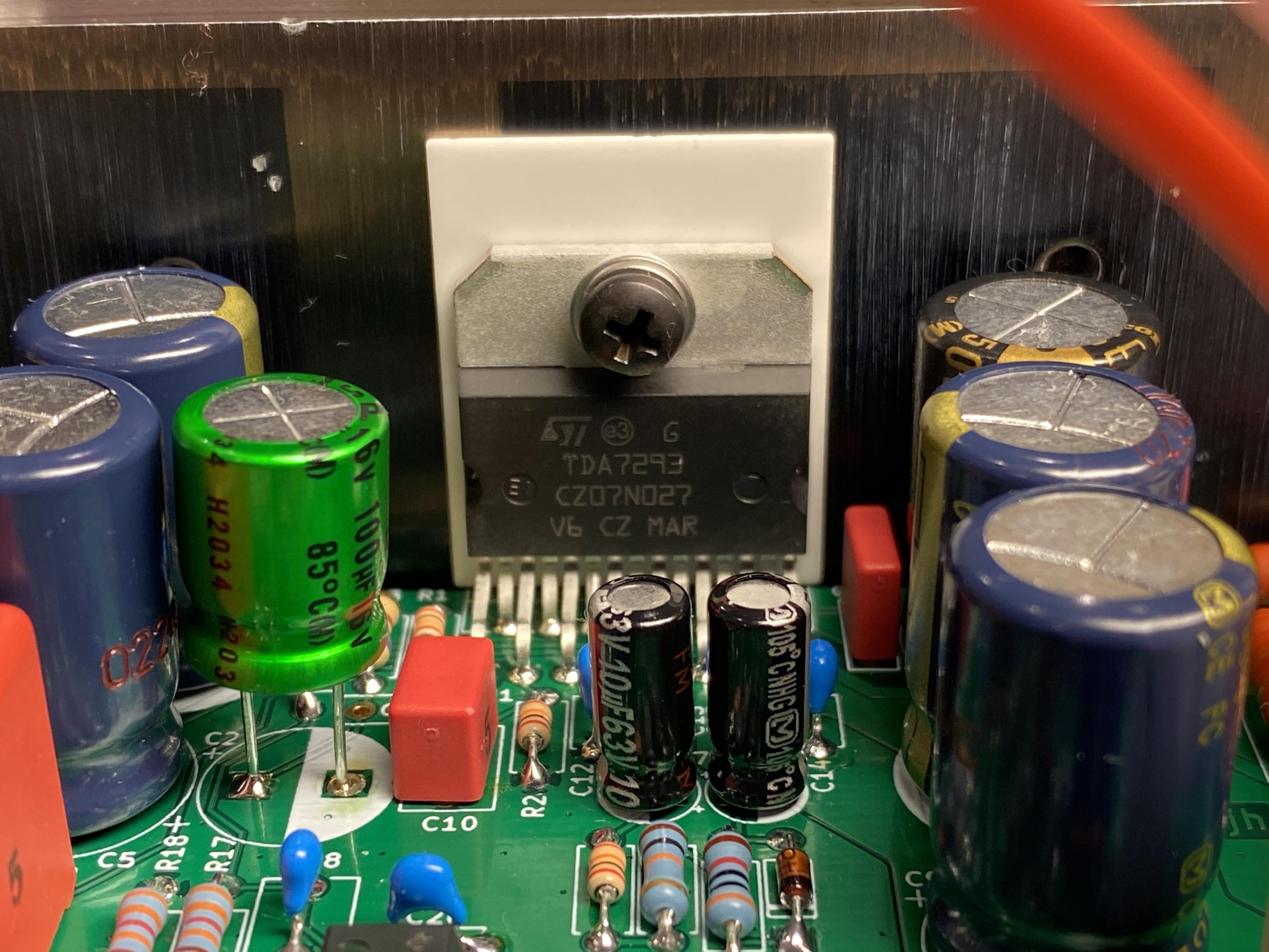

All fake chip i got have V6 written on it, They will fly to sky like a fire cracker when you use more than ±25V DC.
It seems V6 chips from mouser are free from firecracker syndrome.

Hi Vunce,
That TO-264 ceramic insulator seems like it was made for this! Nice build! When will you be in stereo?

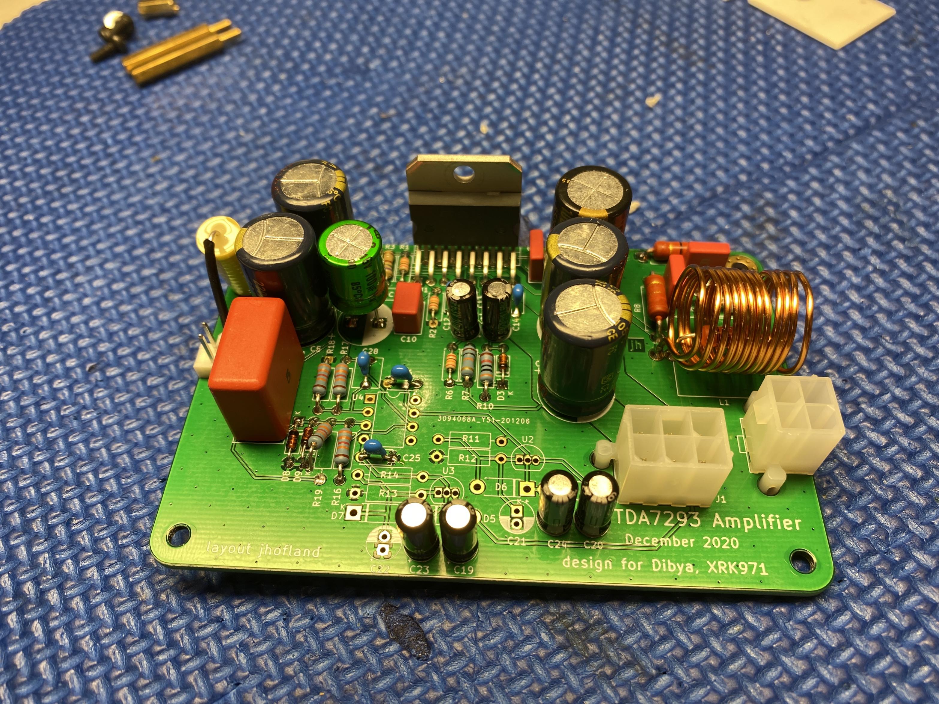

Second channel hot off the press!!
I’ll have time to fire it up now, check offset, and pass the magic smoke test :D. I believe tomorrow I will have full stereo enjoyment. I think I have a “doner” chassis I can use ;)
I know, my inductors look sad. I didn’t have enough magnetic wire on hand, so I unwound a pair of inductors I had in my parts bin and rewound them for this application.
Thanks for the link Vunce.
Instead of using a screw + screw insulation going through the IC, I normally use these clip + some insulation between the IC and the heatsink. It’s much easier if you have the room for it on the heatsink. It’s from AAVID, model Max08Blocked
BR
Eric
