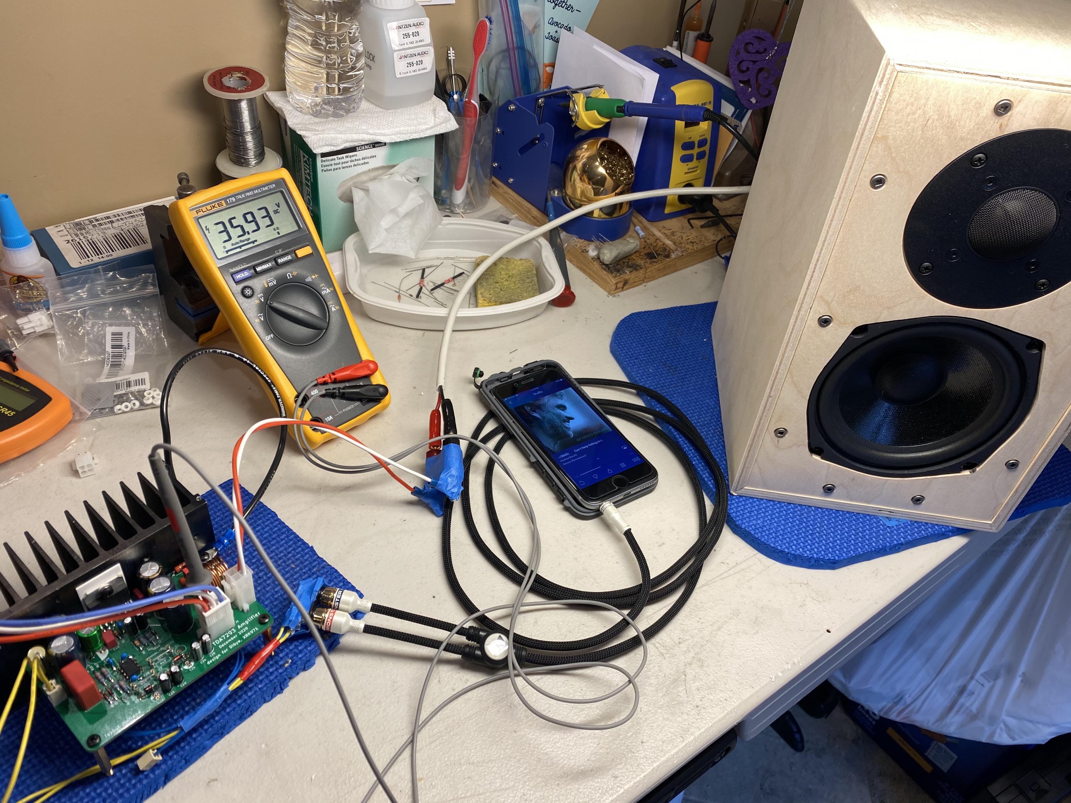

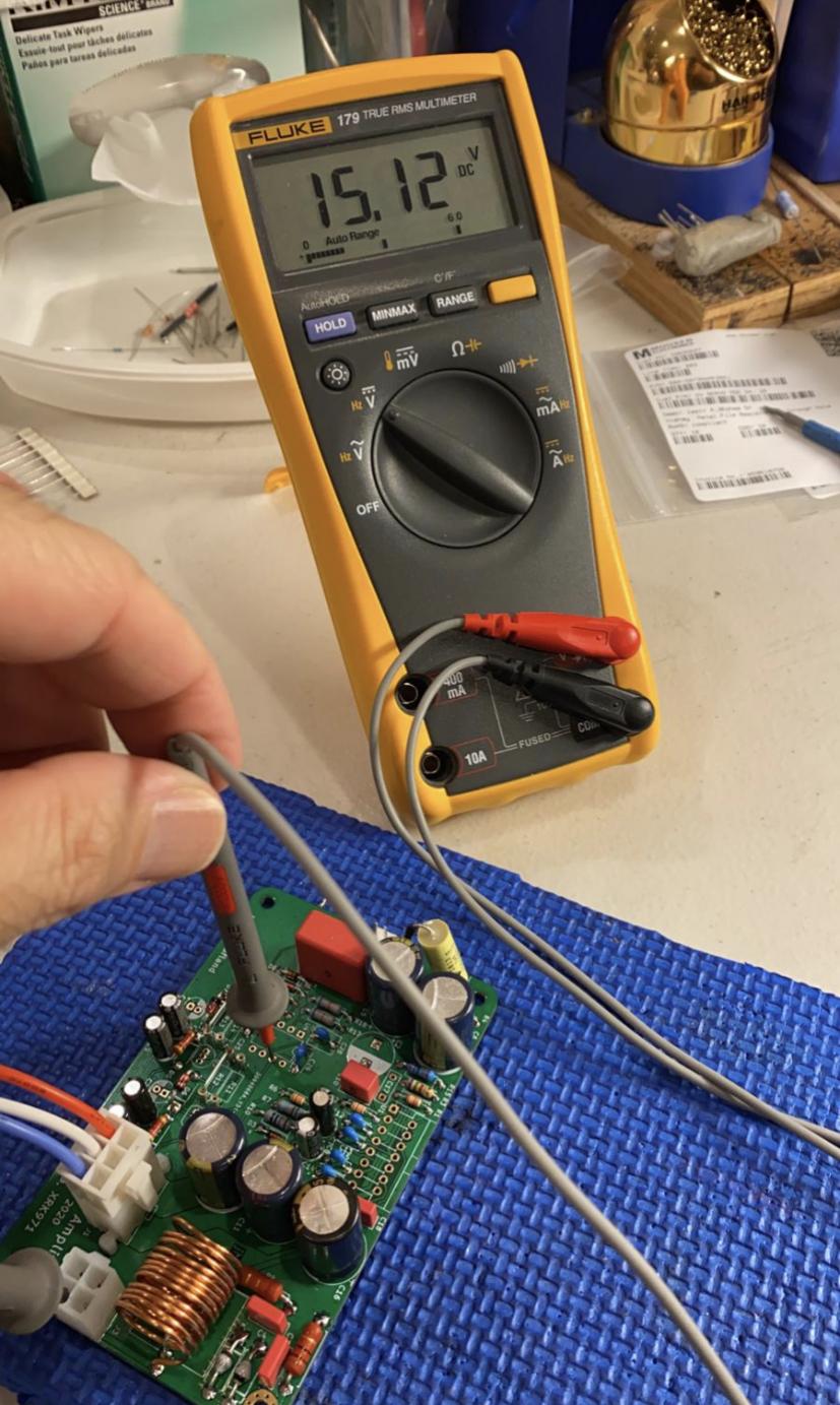

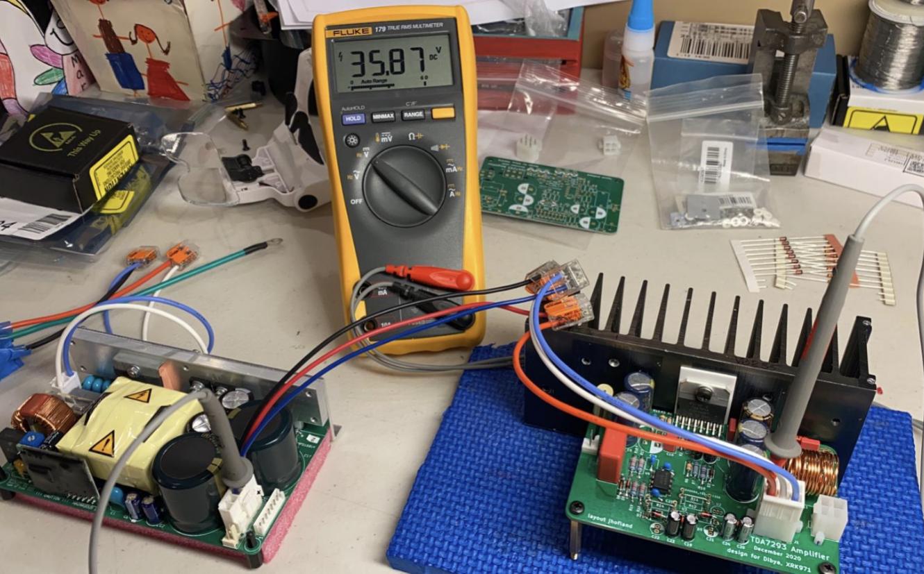

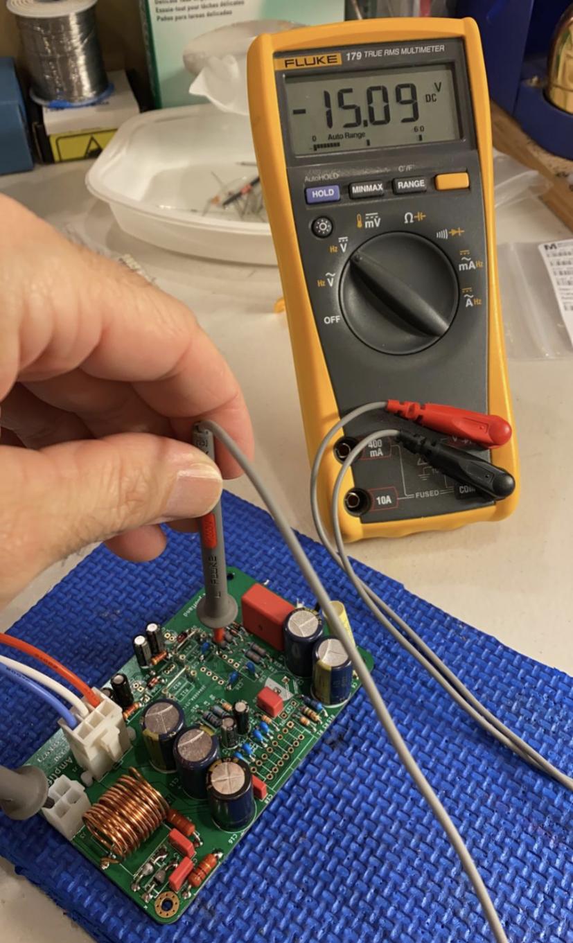

Vunce made great progress on the verification build. It’s all powered up and the new zener diode HV supply mod is working perfectly. We are running into something with the DC offset servo though as it’s not hitting 0mV (offset at 41mV). So we are debugging that.
I expect first sound soon though, 41mV DC offset, notwithstanding.

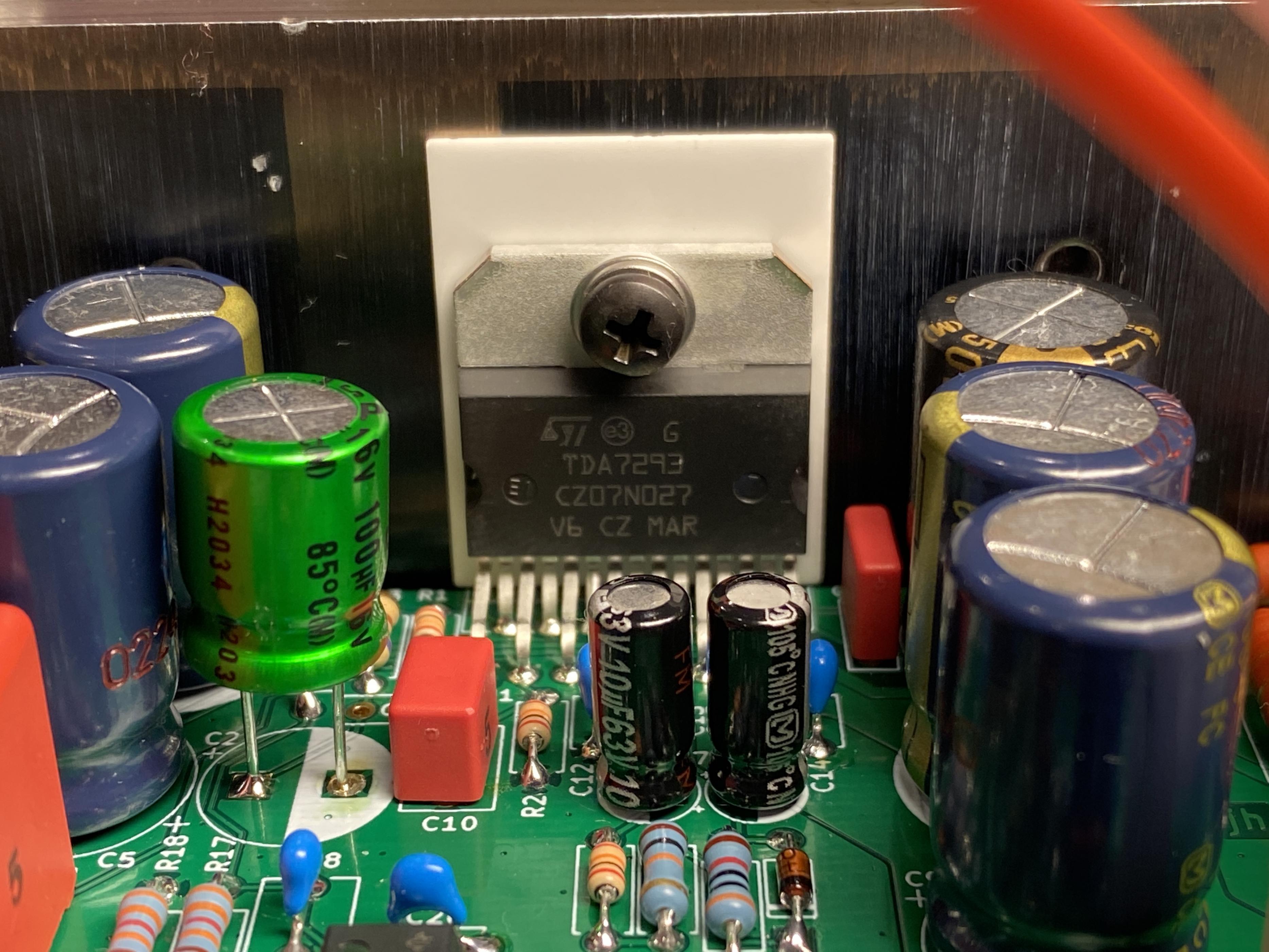

The TDA7293 chip is mounted on a 140mm x 65mm x 40mm heatsink with a ceramic TO-264 insulator between. After an hour of playing music at a moderate level, (just loud enough to still be able to talk to another person in the room), the heatsink temperature is 35°C (ambient temp 21°C) with a +/-36v psu. After a run of several Class A amplifiers this is barely warm

Vunce, you have a problem. 😀 Better keep a fire extinguisher at hand while listening. Where did you get those TDA chips?One more thing , TDA7293 have two version , V6 is rejected batch for Chinese ODM , TV stuff like that and V7 is best batch aka Silicon lottery. ST is very shady in doing business.
If you use higher than 20-0-20 Trafo for V6 IC , it will blast like a fire cracker. Practically ST is providing fake IC to these people for pennies.
If IC is from mouser / digikey it will be V7.
