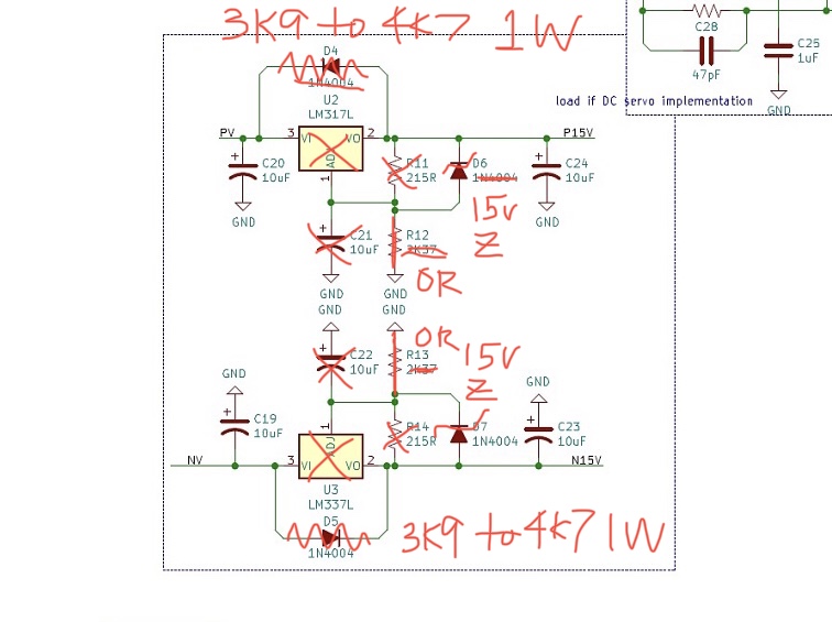

Here is how Jhofland suggests wiring the board with zeners and resistors for the high voltage mod. Use 1W resistors as the dissipation is about 1/2w. So two 15v zener diodes and two 3k9 to 4k7 1W resistors and populate C19/20/23/24 with 10uF caps. Jumper R12 and R13. Place Zener diodes across D6 and D7 with same cathode orientation. Put the 1W resistors across D4 and D5. Leave the other parts unpopulated. Pretty easy actually.
attachment.php

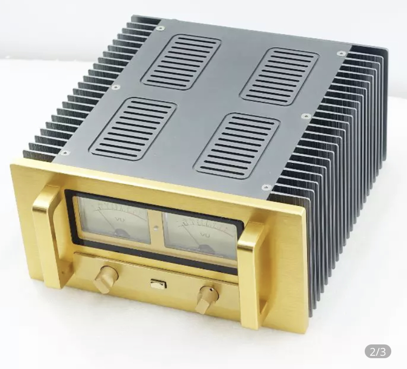

A chassis like this would be about perfect for this amp. I have used one for a 35W dissipation per side Class A and it worked fine:
attachment.php
US $98.00 | BZ-15 CNC All Aluminum Chassis Case Box for DIY Audio Power Amplifier 240*120*258mm
BZ 15 CNC All Aluminum Chassis Case Box for DIY Audio Power Amplifier 240*120*258mm|Amplifier| - AliExpress

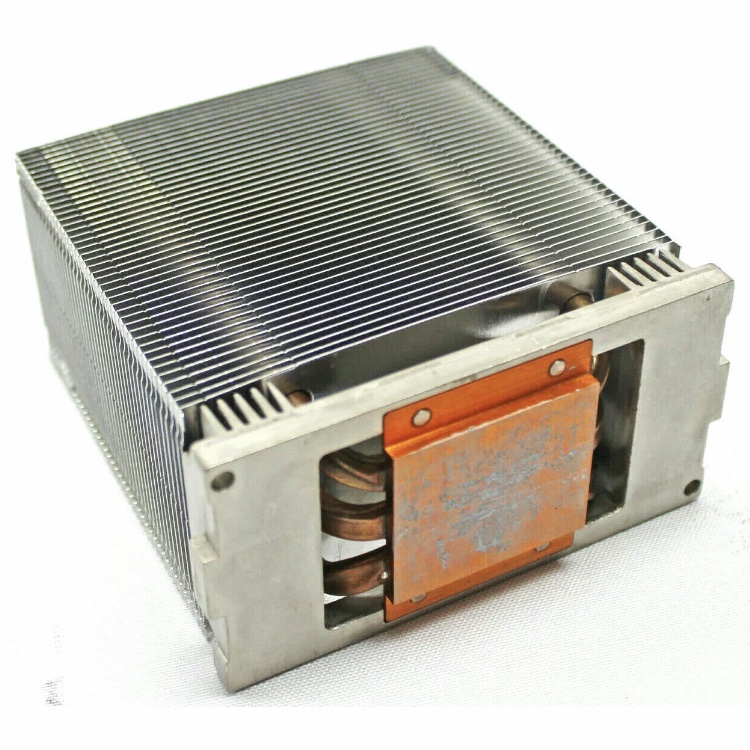

Hi Kokanee,
I hope you don't mean those crappy one Intel provide you in box.
It depends on the size of your heat sink.
If you have lab PSU , try running those ic at ± 25v then ramp up slowly and see if it is cooling properly if not add those fans.
Hope it helps. Can i have image of your CPU cooler?
I believe XRK can help you in this regard.
