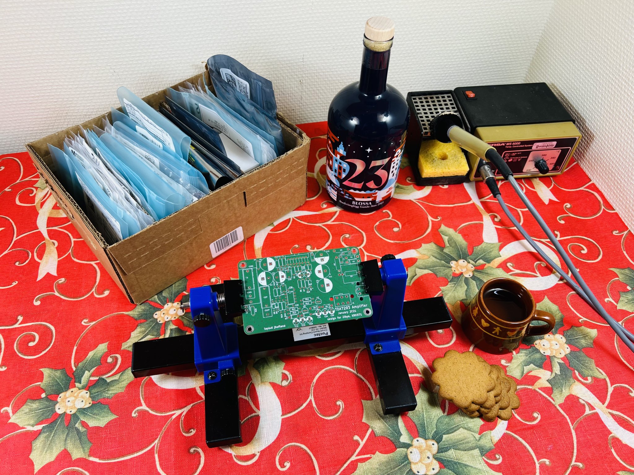

Hello everybody!
After reading through all the posts in this thread, phuuu... I'm ready to start building the X-Mas Amp.
What an interesting project with the TDA7293 and what a great work, some have put into this.
Thanks Dibya, Jhofland and everyone else who contributed to this. 🙏
I pour some Jul Glögg (mulled vine) and grab some gingerbread cookies and get started. 🌲❄️☃️

Thank you very much! So great to finally get started and build this Amp. 👍 😀🤟Love your set up and refreshments. Enjoy the build

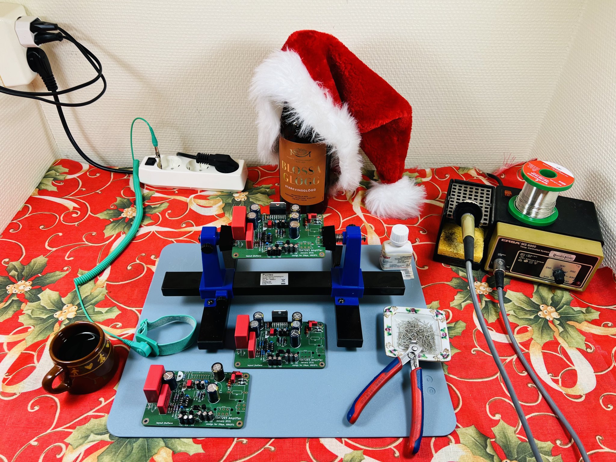

Almost done with the circuit boards! Unfortunately, I had forgotten the copper wire to L1, 1µH.
Have ordered a roll of copper wire today.
Couldn't decide which version to build of Xamp. I have three circuit boards, so I build a board with carbon film resistors for R1, R2, R3, R4 and R6.
"As Dibya pointed out, and spec'd in notes on schematic and BOM, the gain setting resistors R1 and R3 should be carbon film for best harmonic profile of dominant H2 vs H3"
The second board I build with Metal film 1% and 0.1% resistors
Will be interesting if I can hear any difference.
The amplifier that sounds best to my ears, I will build on the third card.
