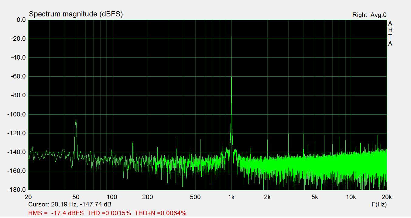

My TDA 9273 project went a little bit wider than testing just one board. I wanted to compare three different boards to find out which is the best among the chosen candidates:
I have purchased 14 TDA7293 ICs, all components from Mouser and Farnell, ordered five pairs of Xmass Amp boards from PCBWay, and in addition to that a couple of pairs of Chinese boards from Aliexpress.
- Xmass Amp
- TDA7293 Parallel kit from ebay (https://www.diyaudio.com/community/...lave-style-no-lossy-emitter-resistors.211746/)
- TDA7293 power Amplifier PCB 60W*2(OCL) 120W*1 (BTL)
I was expecting that Xmass Amp will sweep with the competition but it was quite the opposite.
The winner was:
You can see the best results from the Figure 1. below.

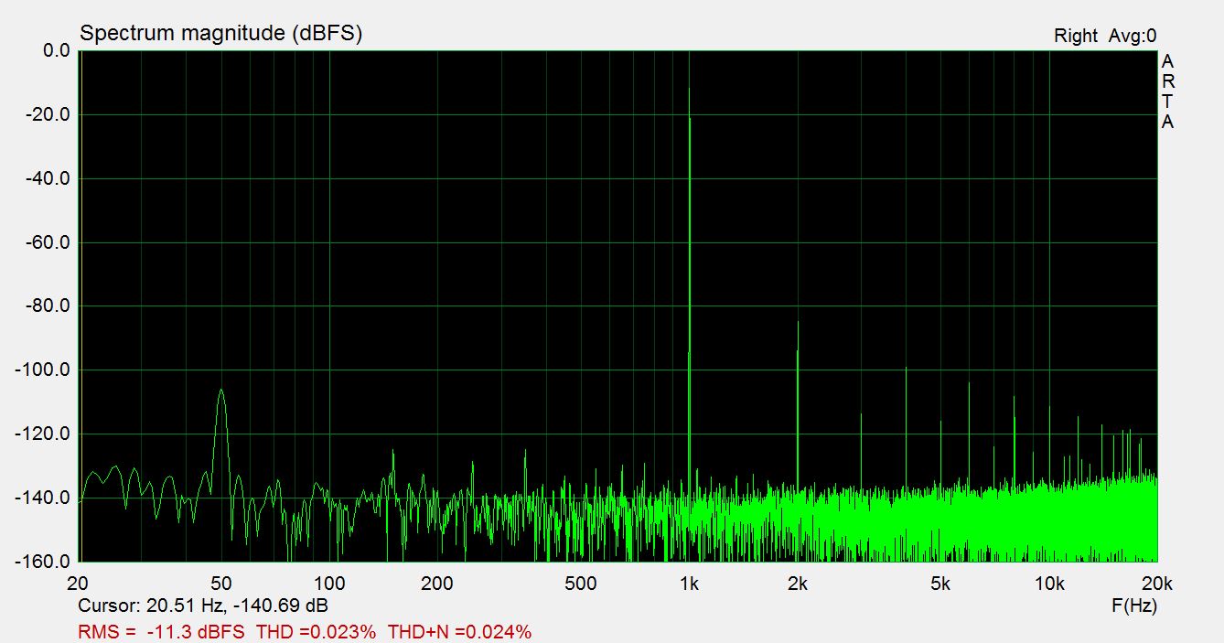

Results for Xmass Amp are shown in Figure 2.
I have made sure that measurements were made under the same conditions.
Initially, I have hesitated to publish the results hoping to find the solution alone.
However, I am sure there is solution to this because at least two results published here indicate that this amplifier may produce much better results.
I have used the gerbers from the OP and Shopping basket at Mouser.
Both channels of Xmass Amp have the same highish THD results as well as all other parameters..
The only change I’ve made is R15=10K.
My questions are:
Q1. Is there anything in the 1st version of the board that increases the THD?
Q2. Is there any change that should be applied to the 1st version of the board?
Fig. 1. TDA 7293 – 2OCL 1BTL at 10 VRMS into 5.5 Ohm
https://www.diyaudio.com/community/attachments/tda7293-10vrms-jpg.1130340/
Fig. 2. Xmass Amp at 10 VRMS into 5.5 Ohm
Here is what I got for 10Vrms into 10ohms. You are running 5.5ohms here but I don’t think it should change that much. Sometimes, THD in 0.025% range may have to do with your dummy load resistor. Are you using a wirewound or cement filled load? They tend to be high distortion. The best are using a high power metal thin film series parallel array or an EBG thin planar non inductive resistor (like UHP-300).
Good luck finding the source of the distortion. OTOH, it is dominant 2nd order and monotonically descending higher orders. Whereas the other one is dominant odd orders and 5th is higher than 3rd. This might sound metallic or fatiguing over long listening sessions.
