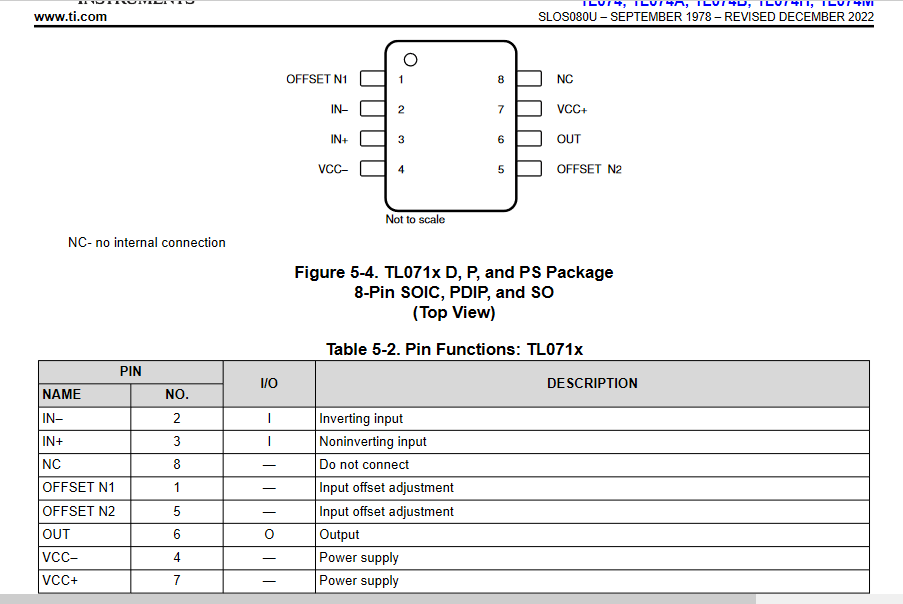

Are you using TL072 opamp? I think a FET input one is needed here to keep DC currents on the inputs low to reduce DC offset on the opamp.

I also did look at the schematic, and checked that it was the correct TL071 i had.

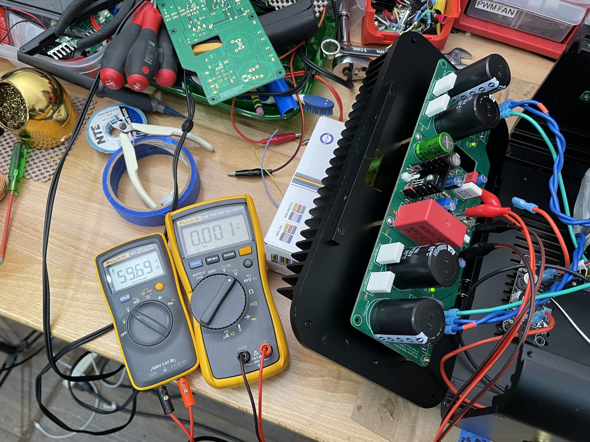

Well, output on TL071 (pin6) = 0.455vdc
VCC- to GND = -15.13vdc
VCC+ to GND = +15.13vdc
IN+ to GND = 0.2vdc
IN- to GND = 0.2vdc
Offset today, with input shorted = 103mVdc
Output from PSU = +23.4 / -23.4

Do you think you have a genuine TDA7293?
Other places to look for DC offset are small solder bridges or leftover flux making contact between pins that are very close together. I recently fired up a 40W class A amp based and one channel had 25v offset while the other was fine. Looking carefully at the solder joints I noticed a small bridge - almost inperceptible on the input stage. Reflowed the joint and used some wick to clean up fixed the issue.

I bought them 7293 from Mouser, so i sure think they are real, no fakes. TDA7293, but offcause i can never be 100% sure.
I also think they are real, when playing music without any problems on my shop, but again you could be right ?
I must admit 🙄 that i did not clean the PCB with iso. alcohol as i allway's do, I will do, and also carefully look through the PCB in my microscope.
I'll be back within the weekend.

Cleaning and removing flux etc... actually lowered the offset to 18mV channel L and 6mV channel R, and when reducing the voltage on the variac i see a small rising in the offset, so i should really wait until i have the right trafo now... Please stop Jesper now 😵
All of them are low now, the IN+ / IN- are within 20mV and the output (pin 6) around 130mV now!
I do think everything is as it should be.
I will rapport back when i have +/-37vdc rails ready.

Glad I could help. Are tidy and neat solder joints an extension of a tidy and neat bench top. 🙂
My bench is a mess but my solder joints are neater, thank goodness. That last solder bridge was not mine but a friend who helped assemble the amp for me.
Toothbrush and mineral spirits paint thinner first (that dissolves rosin flux better), then isopropyl alcohol and toothbrush. Some people put the board at this point under running warm water and use dish detergent and brush for final step then air dry.
Here is latest photo of my bench while debugging that solder bridge. Fixed it - DC offset went from 25V to 1mV. Rails are +/-30v. Class A with 1.7A bias current flowing. It’s a warm amp.
