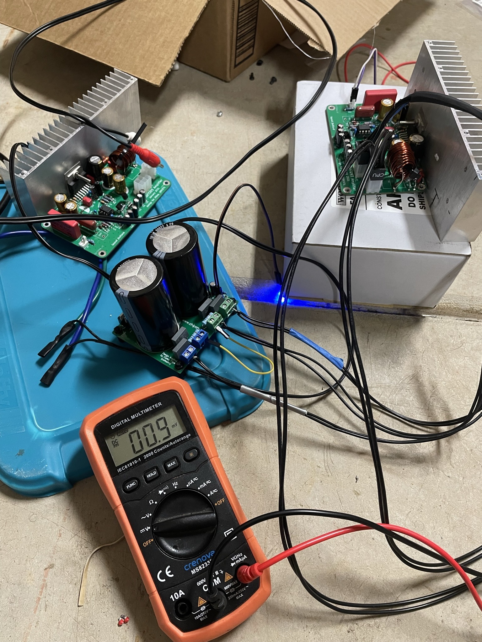

Hey y’all, just finished stuffing everything and a first power on. The dc offset was a bit too high and I realized I had started with 10k ohm at r15. Swapped it for 47k and I’m under 1mv now!
Initial listening on an old pair of infinity speakers I use in my garage for smoke tests is pretty good. I'm looking forward to boxing this up nice and finishing the build. Also spliced up an old computer power supply to reuse cable/connectors - completely hadn't even considered that until it was mentioned on this thread. I kinda like seeing "CPU" printed on the clips

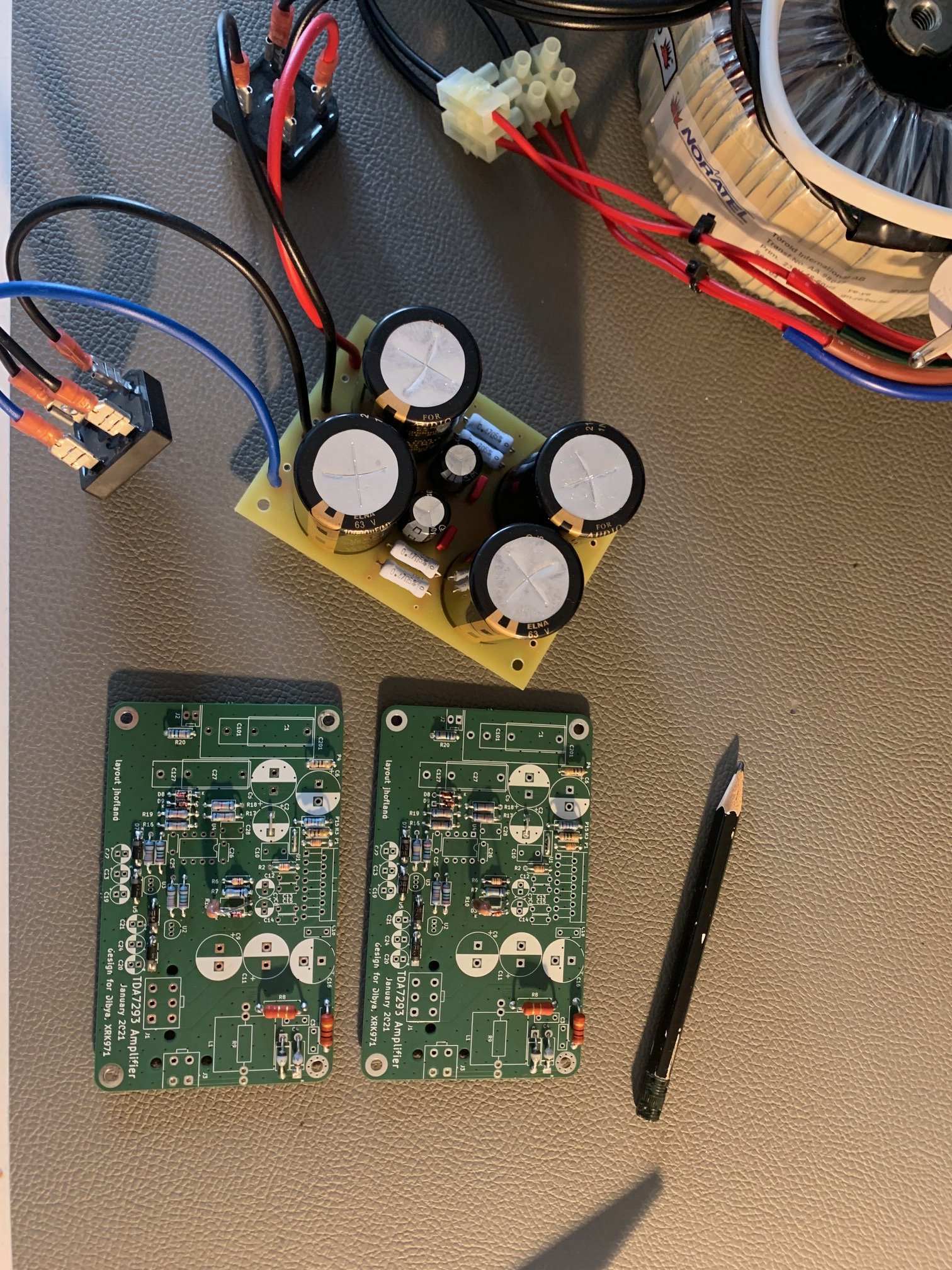

Hi all... and merry X-mas amp. (Still waiting for the correct transformer from Poland)
Well, it won't be that long until i am ready to test some, therefore asking if it's just normal procedure when doing this, i mean:
All parts mounted, Input shorted, output with DMM (measuring DC-offset) and slowly turning up the variac looking for smoke, hot part's etc...
Right ?
Jesper.
Right ?
Jesper.

Nice work. Yes, measure output voltage DC offset. If that is high, something is wrong. Look for smoke or listen for strange sounds. It’s a pretty easy amp to startup if assembled correctly. Good luck.Hi all... and merry X-mas amp. (Still waiting for the correct transformer from Poland)
Right ?
Jesper.
