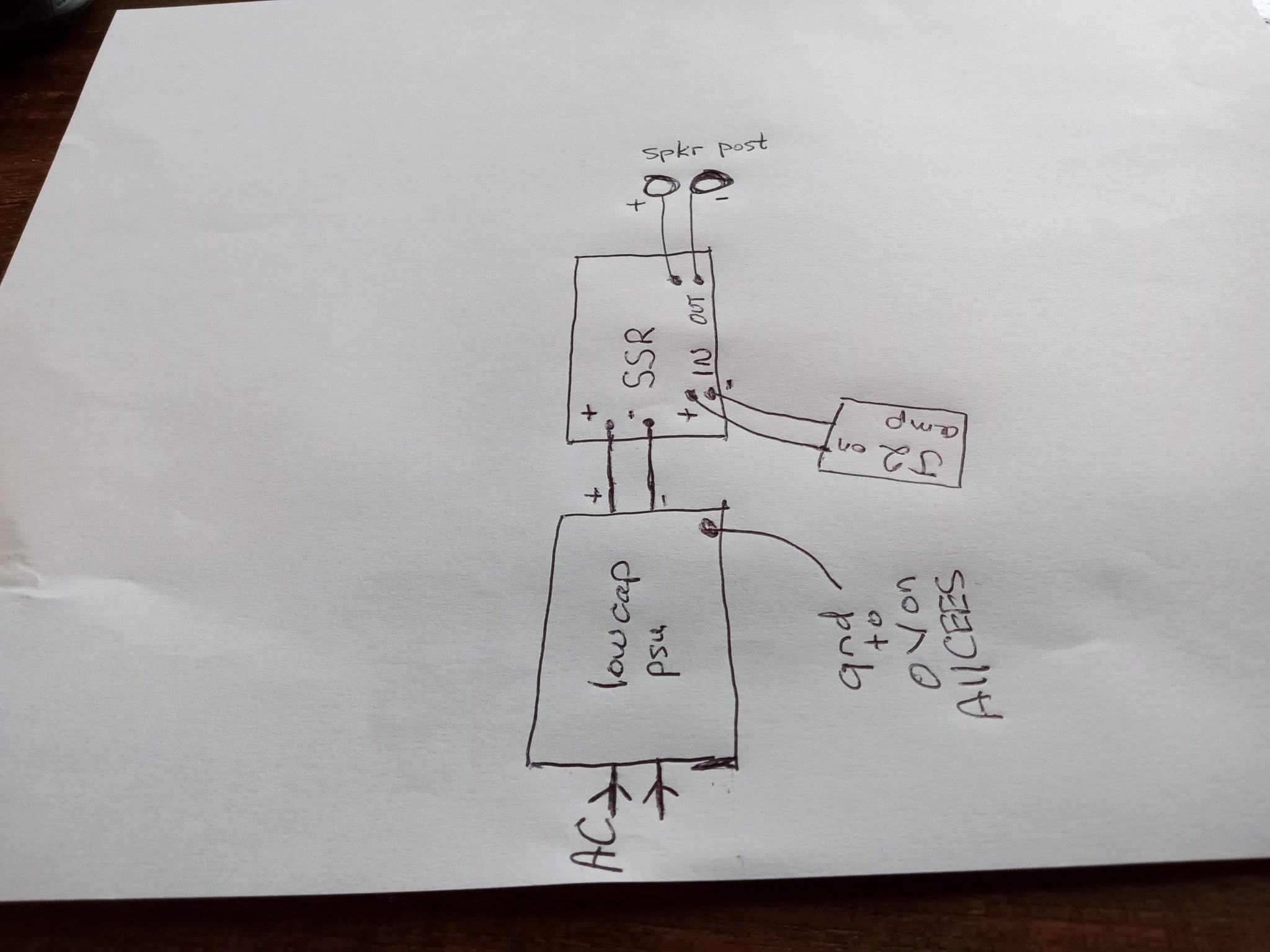

Thanks X. One more quick question, below is the plan for the low cap psu and the SSR protection. Look OK?
Is there any advantage to having the negative speaker binding post connected to the 0V on the All Cees psu rather than the - out on the SSR module.

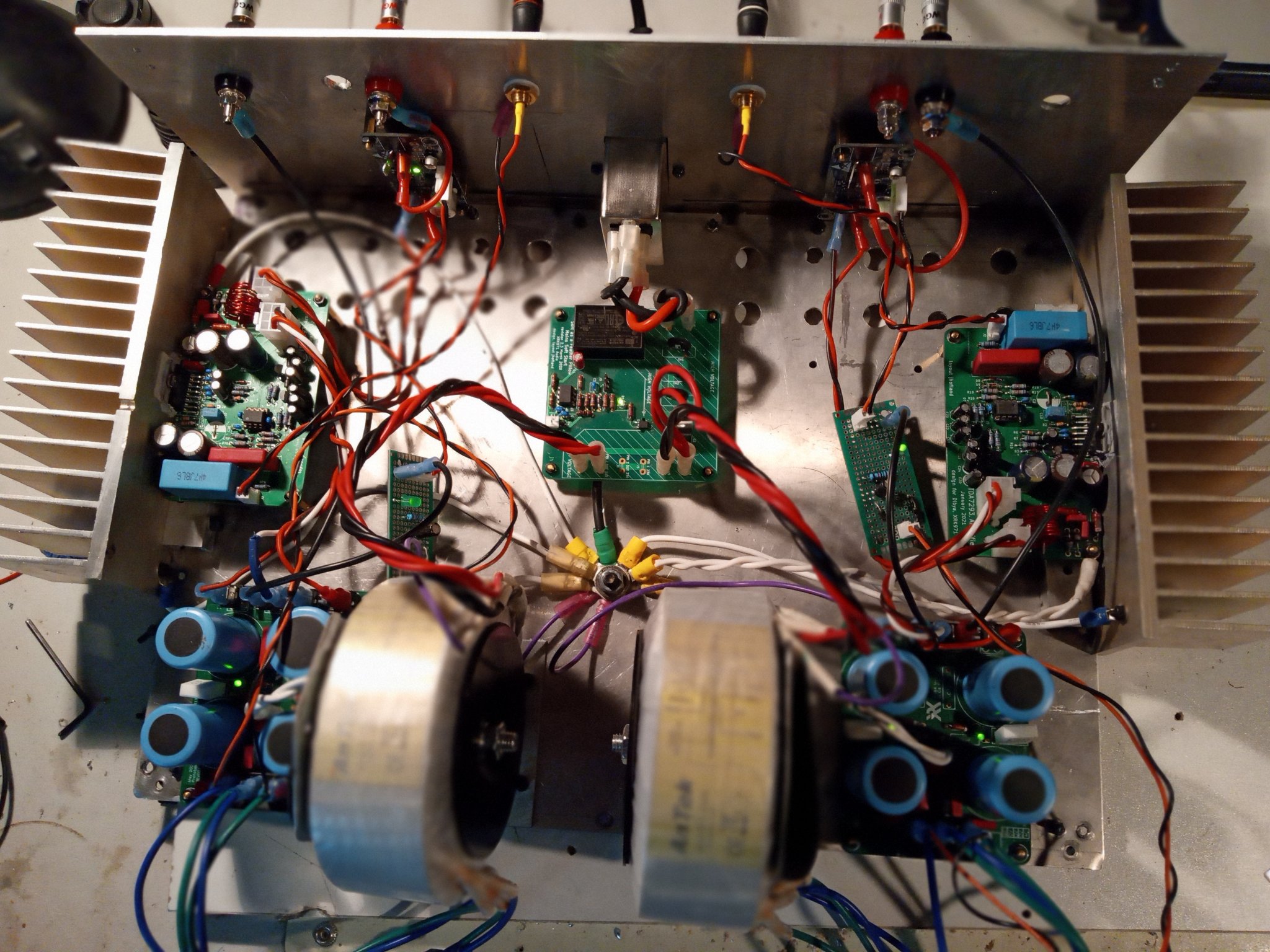

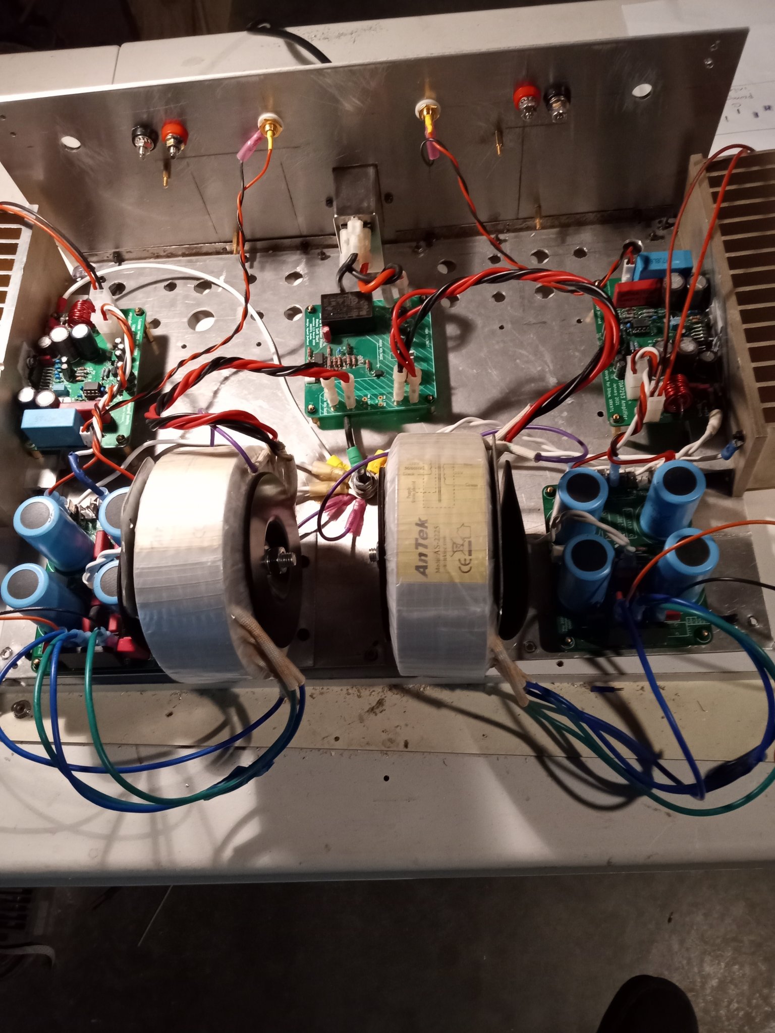

I finished my basic wiring, and gave each channel a test thru 10W/10ohm resistors. Mains power supplied thru a variac and dim bulb tester. increased the voltage slowly to 110V with dead silence, no pops, no smoke. Measured the offset and received 1.8mV on the left channel and 0.9 mV on the right channel. I think everything is OK, so I will connect the low cap psu and the ssr modules, and see if it will play some music. Below are a couple of pics of my wiring so far.

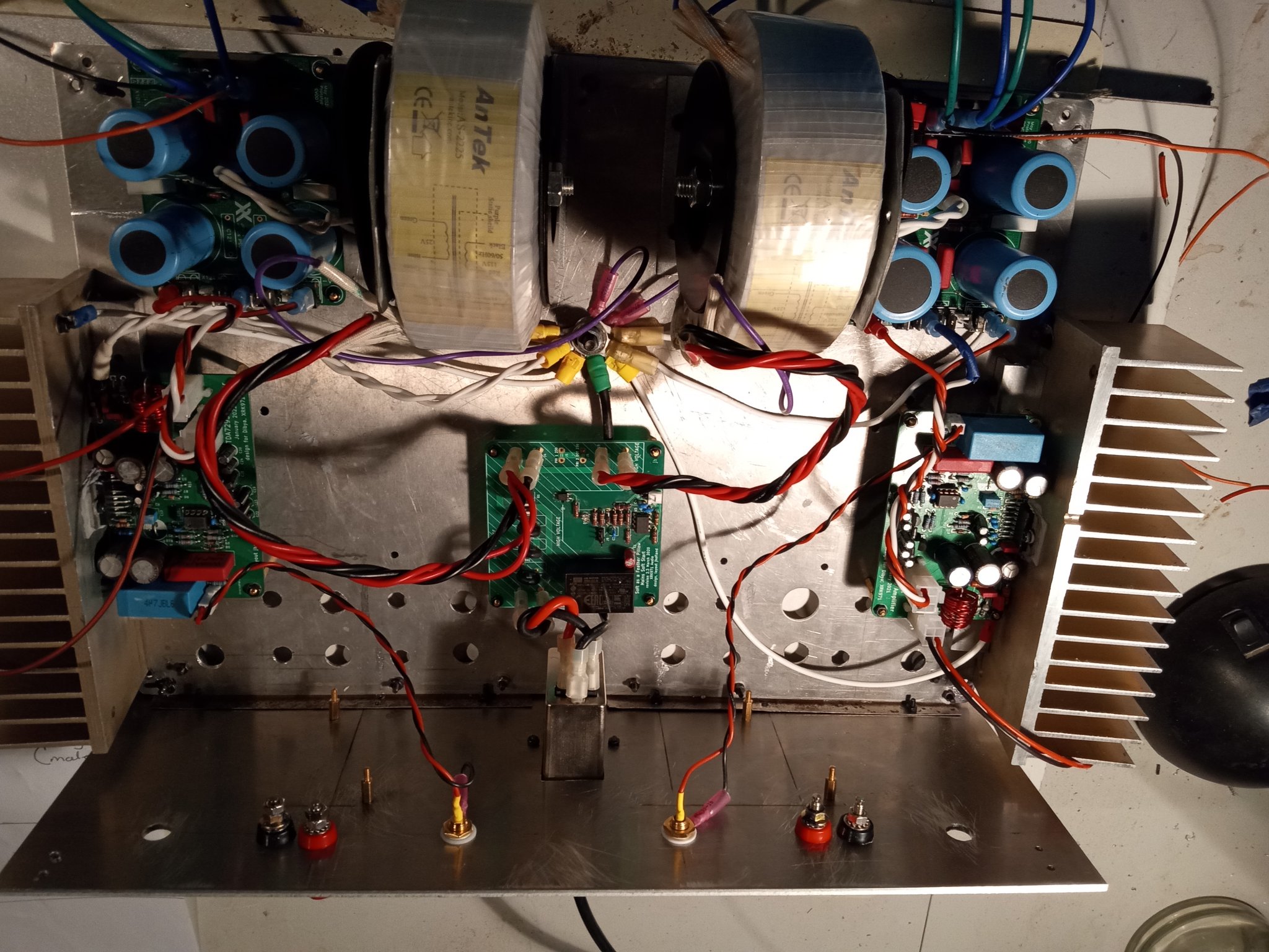

Thanks for all the encouragement. I hooked up everything and powered up each channel separately. The left channel played music for a bit and then it cut out. It turned out to be a rookie error: I left one of the corner bolts off of the amp board as it was to hard to tighten down due to proximity to the heatsinks. I thought it would be OK with the 3 other corner bolts holding it. Amazing what you learn when building;). Did the same to the other channel, then powered it up again. I must say that this is a very nice amplifier. I am listening to some very nice tunes through my produces does sound this
Joined 2010
Oops, My computer ran out of power, and I could not edit the above post as I was timed out. So to continue:
Did the same to the other channel, then powered it up again. I must say that this is a very nice amplifier. I am listening to some very nice tunes through my mid-fi spkrs and it sounds great. Will let it play for awhile and see if any changes happen.
I would like to thank the designers of this amplifier and all the help I have received from everyone on this forum. Happy building to all and here is a pic of Xmas layout (or should I say the wiring maze)(y).

Not sure X, when I pressed on the side of the pcb where there was no bolt it made a connection. When I released the pressure the music would cut out. So maybe the pressure caused the chip die to conduct. After I bolted down the corner of the pcb it must have applied the pressure needed to make contact, as I had no more problems. Just to be sure, I will apply a bit more torque to the chip against the heatsink.

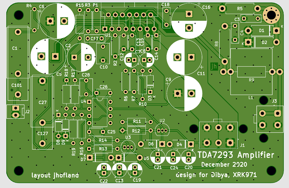

I don't think that C16 has to be a special cap. It is not mentioned in any of the posts as being "critical or you must have", so any decent quality cap as Kay P noted above should work. On my amp I used one that I had in my inventory, looks like the brown Elna silmic type, but is just another brand 63V/100V/105C. I did use the Elna Silmic II for C5, C11 as part of Dibya's secret sauce. ;). My amp is playing nicely.
