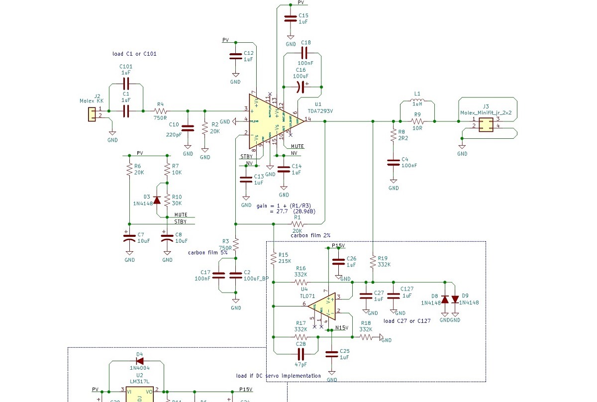

Today I was doing some speaker measurements in room using the amp and we discovered that one channel is 6db higher than the other. I measured AC voltage at the speaker with a 50Hz signal and one was approx 1v while the other was 1.5v.
What should I be looking at please?
Thankyou
Thankyou
Gain is set by R1 and R3. Perhaps use of 5% carbon film here may have caused gain error if R1 is +2% and R3 is -5%. Measure the values and select matched pairs for left and right channels. Or replace with 1% metal thin film.

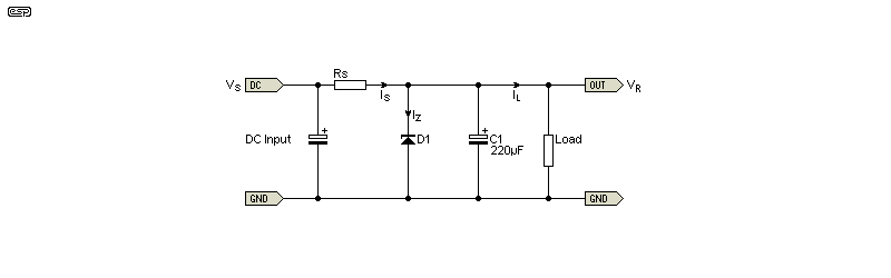

Use 15v Zener diodes as voltage regulators. More info here:
https://sound-au.com/appnotes/an008.htm

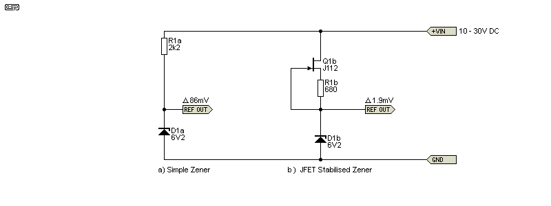

Or add JFET and is significantly better:

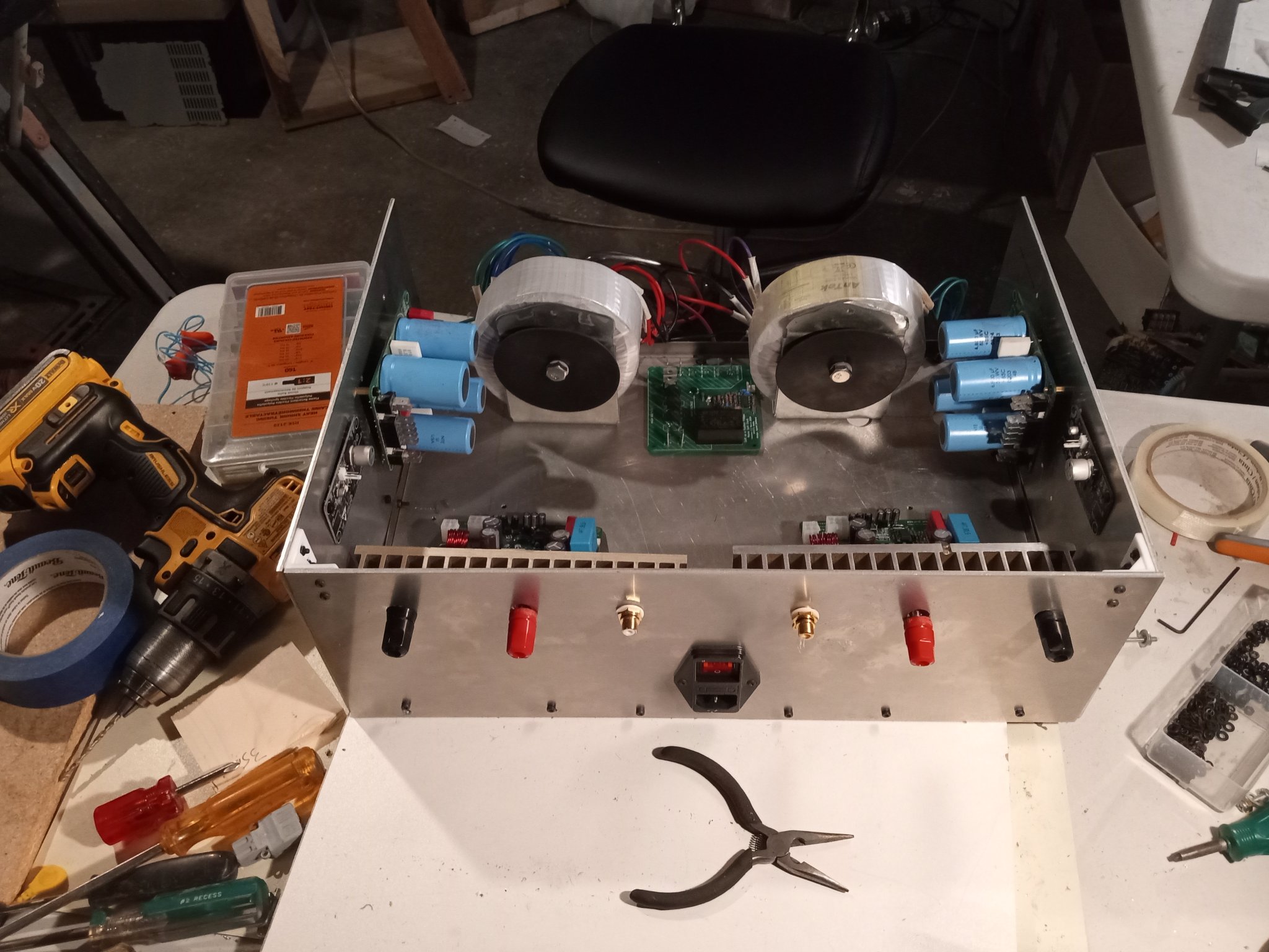

Good Afternoon,

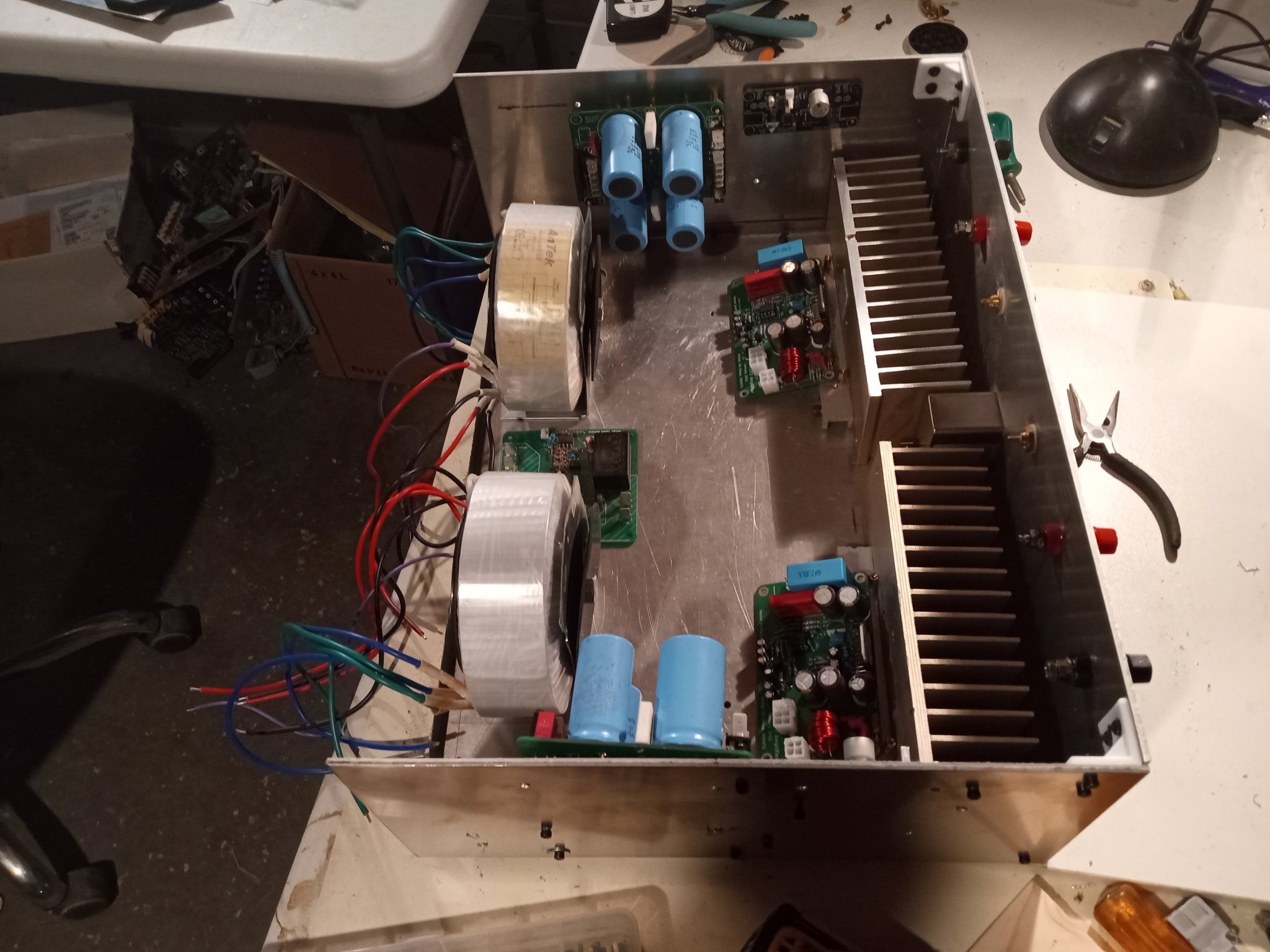

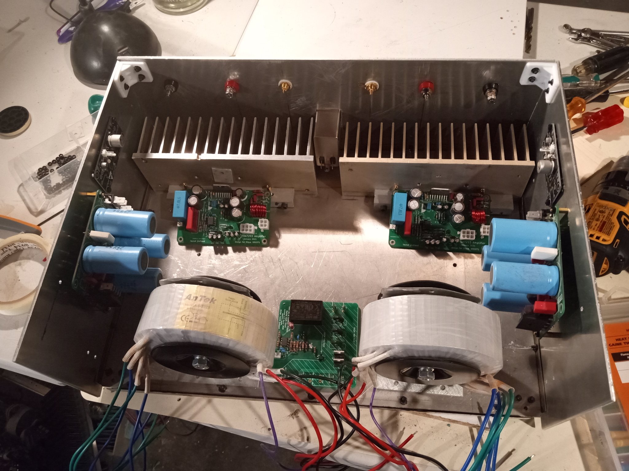

I have attached some images of my proposed layout for the Xmas amp. This is a very preliminary prototype enclosure just built to make sure I can build a working amp, no lid will ever be attached. I will be moving the Xmas amp to a better home in the future.

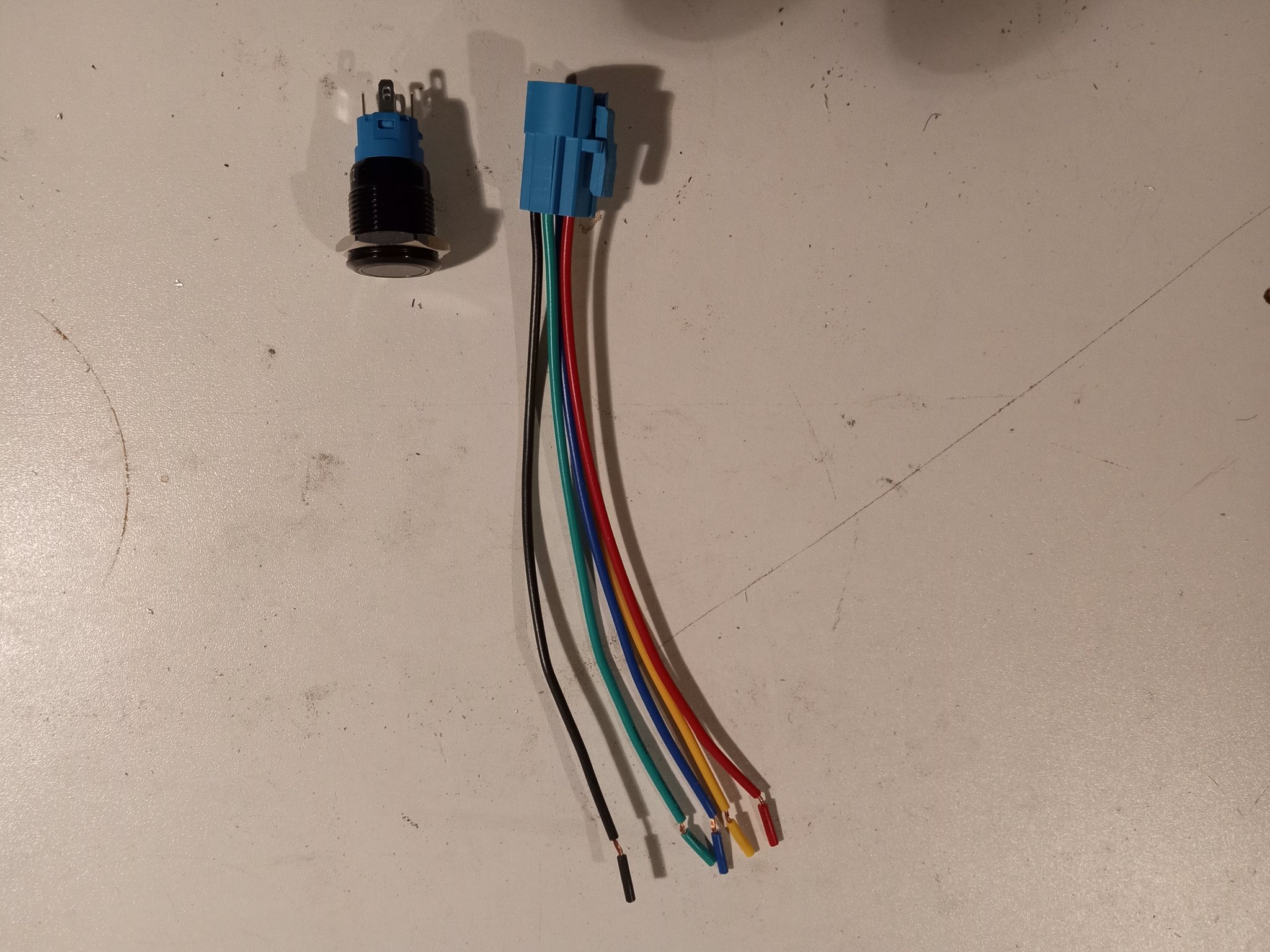

The one thing that bothers me: I purchased some switches and wiring harness's to have a remote switch. The switch harness has 20 ga. x 500V wires. Are these 20 ga. wires sufficient to safely handle the 120V mains voltage and current that one might expect. The IEC/filter module is rated for 220V/10A
Depending on the answers I receive I am thinking of using some 16ga. silicon wire and running from the IEC/filter module to the switch and then to the soft start module. ( No harness with 20 ga. wire).
Any recommendations please.
