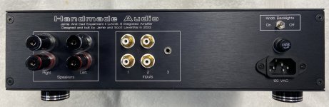

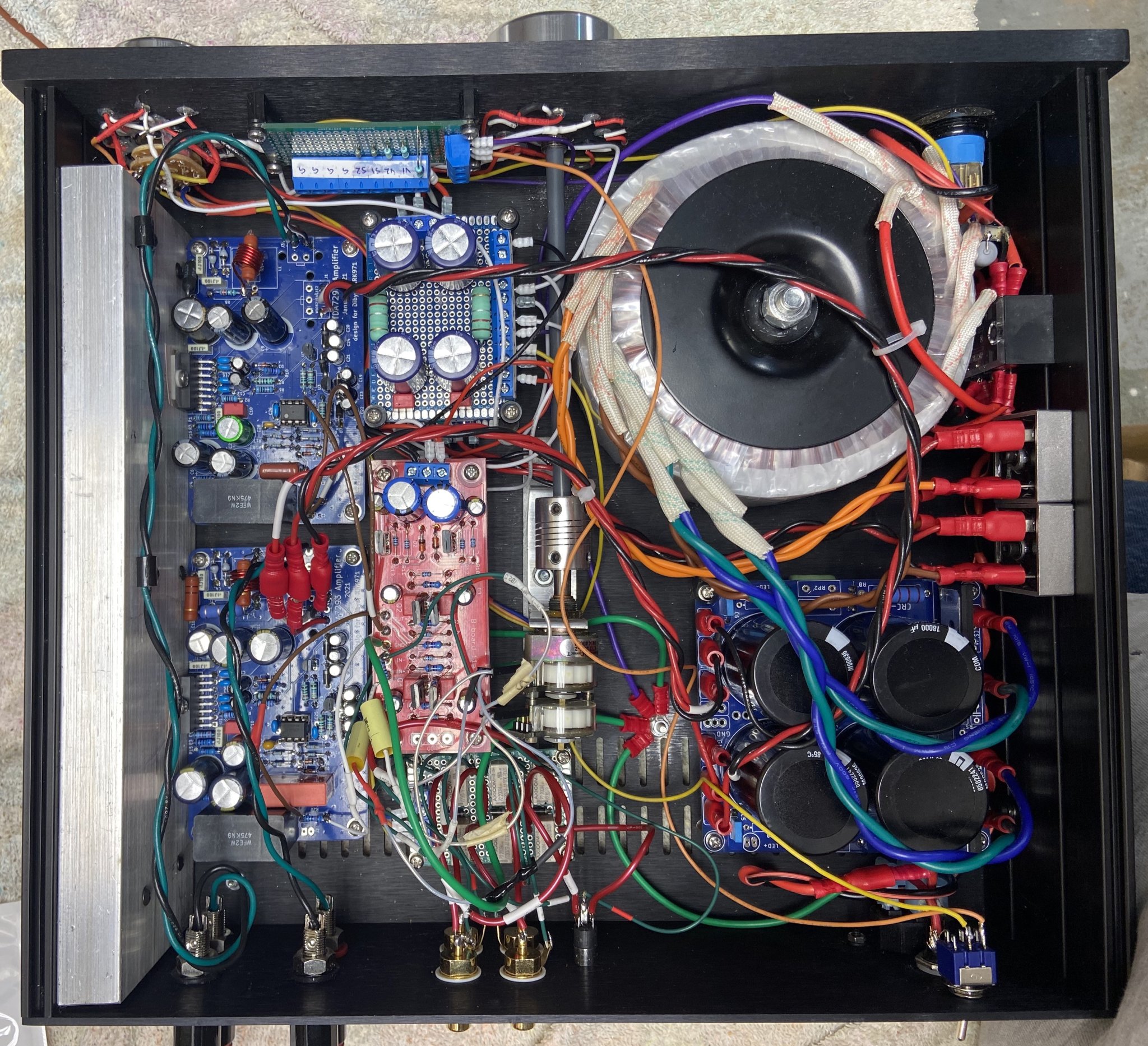

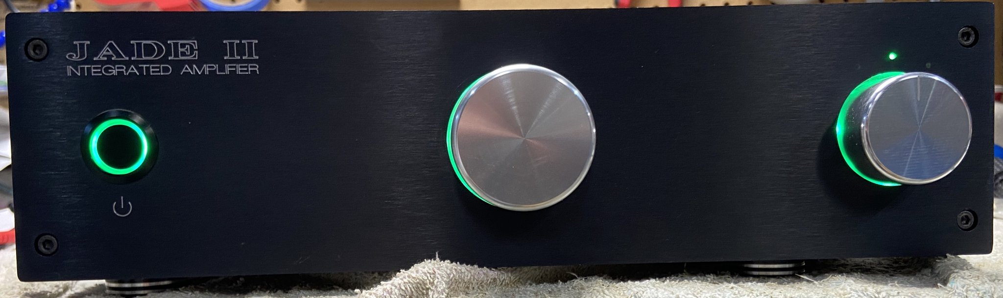

This project took a while longer than expected but is now finished. As background, my younger daughter and I built a Gainclone together about 14 years ago (see https://www.diyaudio.com/community/threads/chip-amp-photo-gallery.79303/page-63#post-1988901). That amp is on its last legs now (i.e., another project for me!) and Jamie suggested we work on a new project together. I needed no convincing. My daughter is now a very busy journalist with limited availability. When time permitted, she came home to visit and we'd find a few hours to work on her amp. She did most of the soldering and drilling; I did the rest. We had a few problems along the way (e.g., see post #1,017) but persevered and are very happy with the result. This new integrated amplifier will soon be installed in Jamie's apartment where it will be thoroughly enjoyed.
This was great fun. Projects like this don't happen without the amazing generosity and support of the members of this fine community. In this case, many, many thanks to Jhofland, Dibya, Prasi and the endlessly enterprising xrk971! I appreciate your fine work and the opportunity to spend more time with one of my kids.

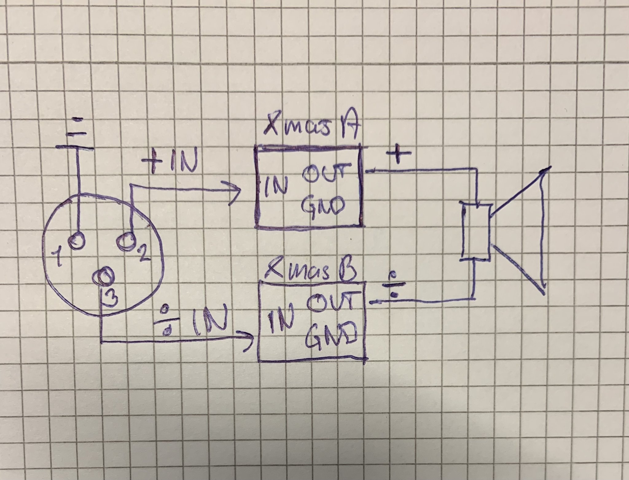

This would mean 2 x 2 boards in BTL configuation? Which speaker impedance do you have in mind? I think it might be doable, but requires feedback resistors of close tolerances (0.1 %) and one board per pair running in slave mode.

Almost any amp can be made to be balanced output. You need to get twice as many amps but power can be as much as 4x. One amp for each leg - just make sure output -ve doesn’t touch GND. One amp is connected to +ve of the balanced and other to -ve end. The preamp needs to be balanced of course to control volume.

You mean like this xrk?
Long ago many year's I had two Pass F4, which was running like this balanced.
Yes, most possibly xrk had this arrangement in mind. Anway, only a minuscule part of commercially available preamps or DIY designs feature balanced outputs. Hence, a phase splitter is required. Or we drive the inverting amp by it's inverting input, being it a resistor of the same value as the feedback resistor from the other amp's output.
