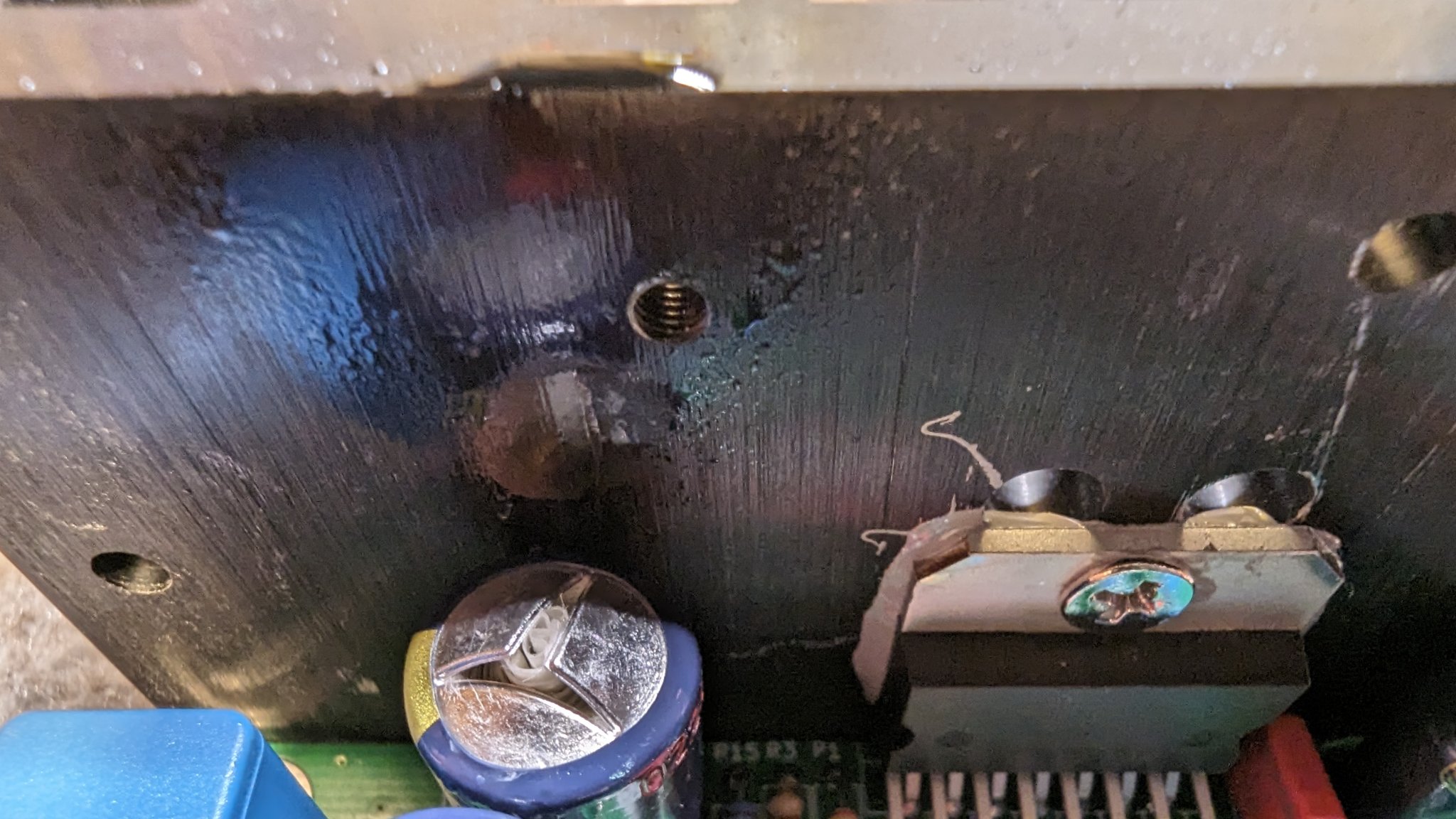

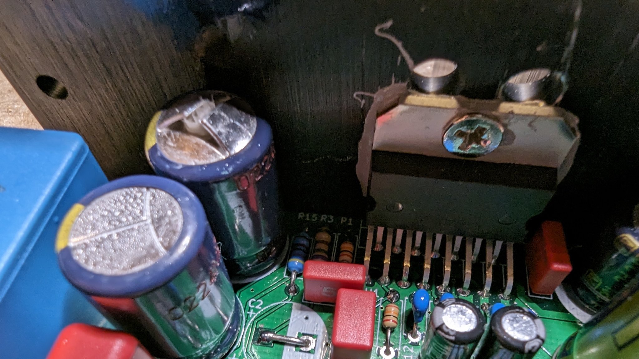

While testing these TDA7293 amp modules, I built a while back. This is what happened.
The first channel module I tested, started up, and worked fine while I listened to it in the background. I wasn't so fortunate with the 2nd channel.
After slowing turning up the variac, the amp kicked in, I heard a couple short scratching sound bursts and then a loud pop and the magic smoke was released! Quickly switched off the variac. This is what happens when a electrolytic cap blows up! 🙂 And the reason being? It was installed with polarities reversed. 🙁 Question is; did it take out anything with it when it blew? I did replace the destroyed part, and all seems back to normal.
Lesson: Always double-check your capacitors for correct installation!

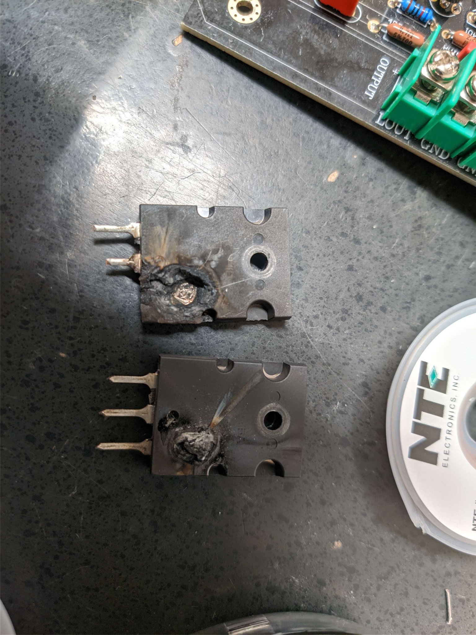

I had that happen to me with a 220uF 50v cap and it was quite an explosion like a large fire cracker. Debris everywhere and luckily I did not get hurt. I always turn my amps on for the first time while wearing safety goggles standing 6 ft away now.
After blowing holes in a couple 2SC5200 I do the same, while also cowering behind the couch and using a smart plug to power on for the first time. This was of course before I setup a dim bulb tester and got a variac.
