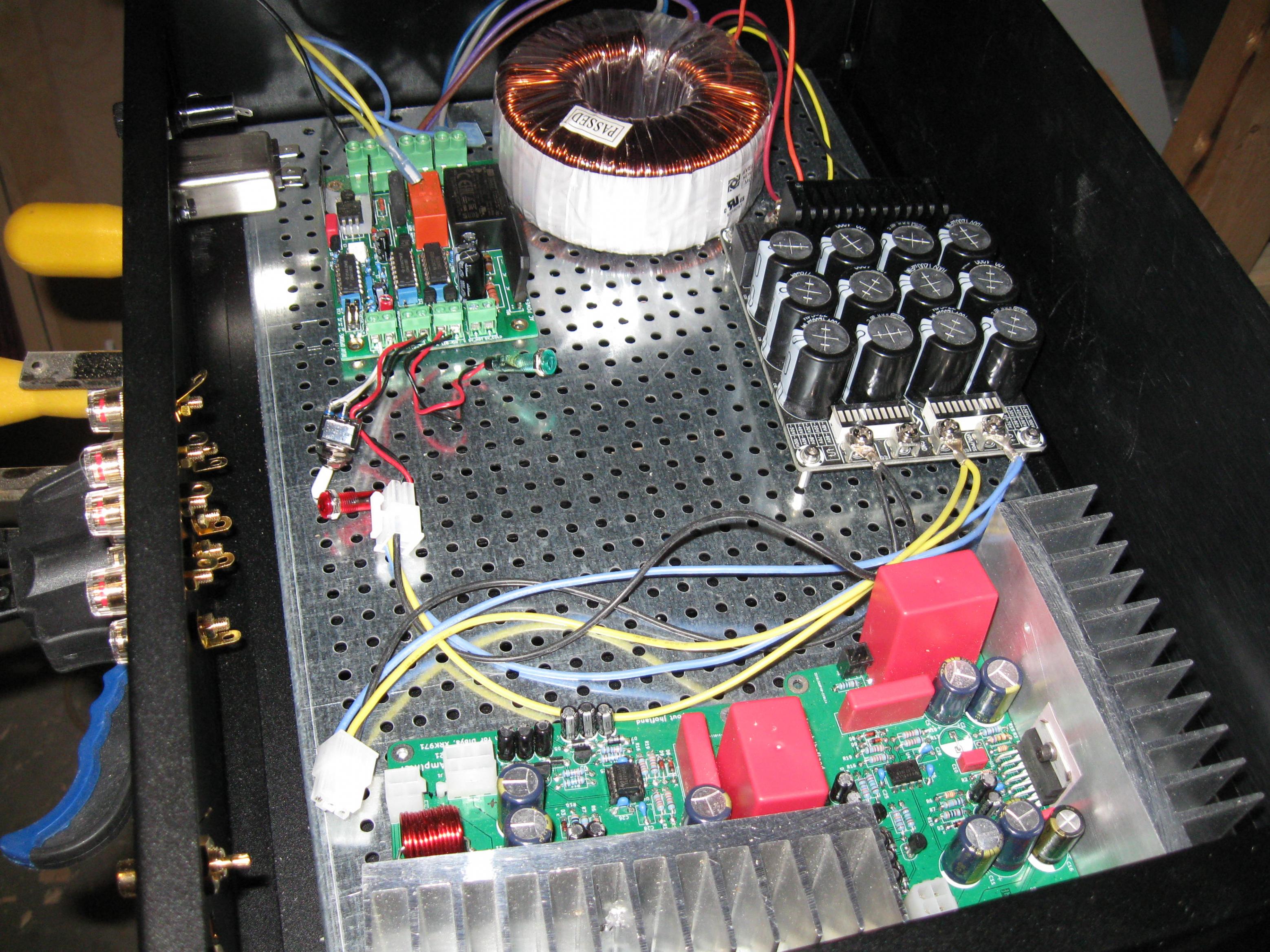

Have been try to get the boards laid out in the cabinet. I hoped to get four channels in there but may not be able to fit them. The amp sounds very good and I had it playing on a workbench for several days.

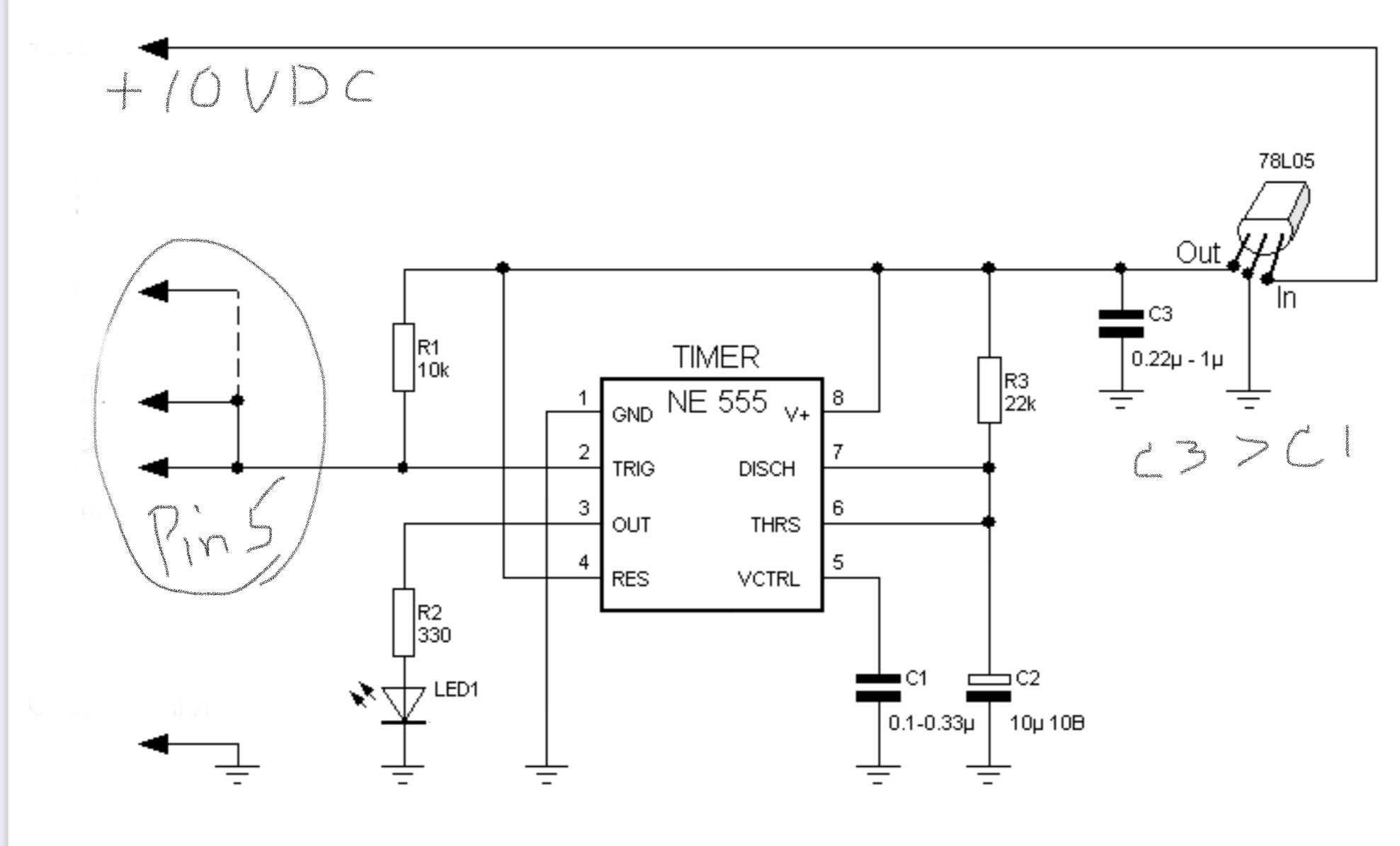

Thanks Pete. Seems pretty complicated - I was hoping a simple LED would do, but maybe this is to give it some sort of hysteresis to make it easier to see.

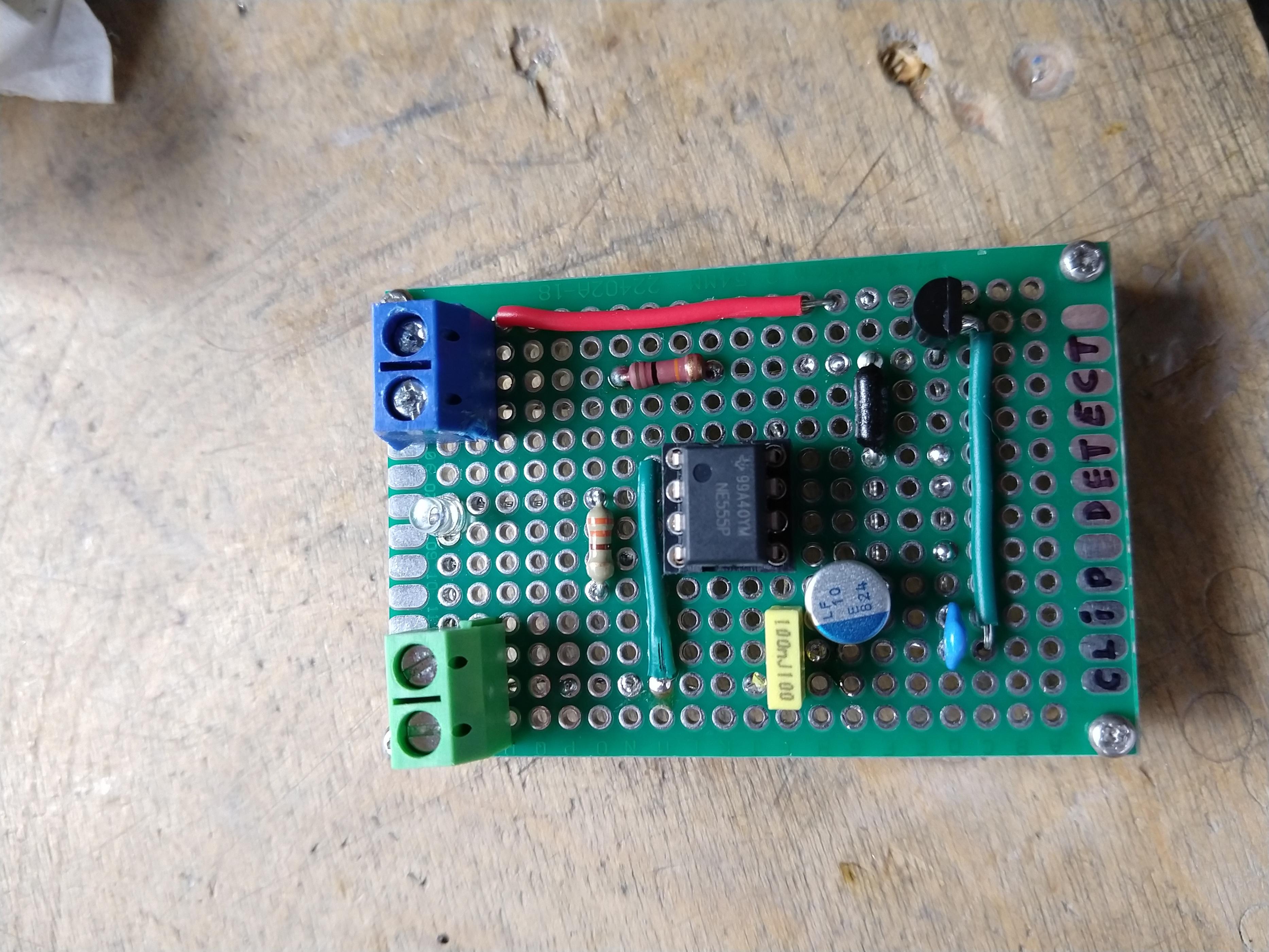

Ok X, so I went ahead and built the clip detector as suggested by AudioKiller (see schematic & my quick build below). The input voltage to the clip detect circuit was ~10VDC and the voltage regulator kept the circuit at ~5V. A wire soldered onto Pin 5 of the 7293 was then connected to the detect circuit. The voltage to the Xmas amp was +/- 25VDC after rectification. Speakers were NHT Super Zeros (8ohm). I played the music moderately loud and clipping was clearly detected by the circuit as the LED stayed lit for long enough to see the beginning levels of clipping. A very smooth visualization.
I then tried what you (and others have suggested): a simple resistor and LED setup. I used a Lite-On standard LED (LTL17KTBS3KS) and a 1K 1/2W resistor. The resistor was attached onto pin 5 on the 7293, the LED was attached to the resistor and then a wire from Pin 13 (from the 7293; 25V) fed the LED. I then played the music moderately loud again and clipping could be detected via the LED but visualizations were not as clear as with the clip circuit until the volume was increased (beginning levels of clipping were hard to see; very dim & very quick).
So the simple resistor & LED works and might be enough to see moderate levels of clipping. Lower levels maybe...just as long as it’s not a very bright room and you look intently at the LED.

Thanks for sharing that. I think the 555 timer is being used as a mono stable vibrator to give some hysteresis and persistence so that our eyes can pick it up. It would be interesting to compare with and O-scope to see what is meant by clipping.
The clipping warning LED on a TPA3255 class D amp comes on when it detect moderate distortion at the peak. Not clipping quite yet and you get a faint flicker.

I changed to a "super bright" white LED and it's pretty visible when you push the amp but one may miss the infrequent & short clips still. They are still easier to see with the 555 circuit but it's not like it's a wide region between clip (or whatever it really is) onset versus having the LED well lit.
