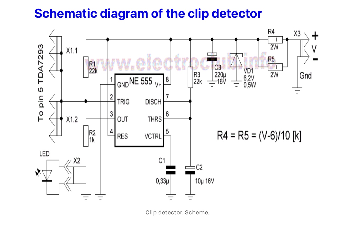

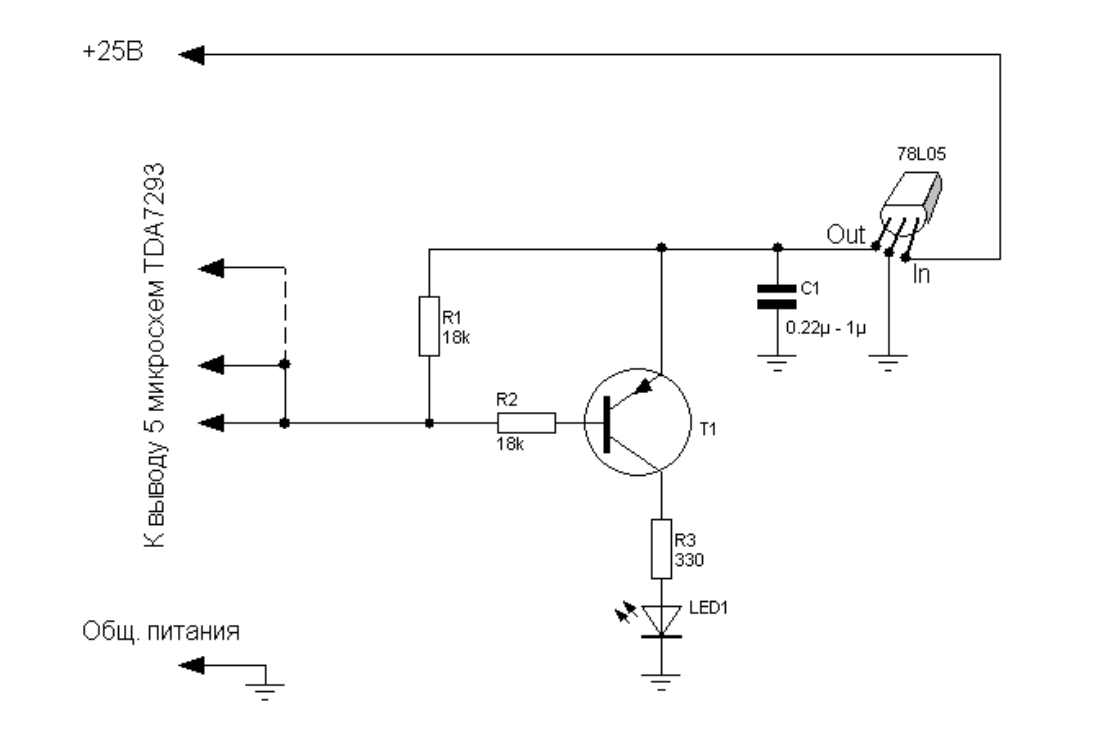

I just noticed that there is a clip detector on the TDA7293. I can’t believe it took so many posts for people to figure out how it works? From what I gather, it’s just an LED and say 10k resistor to positive supply and the TDA7293 clip provide open collector logic?
Schematic for TDA7293 clip detector?
Here’s a link to a clip detector circuit designed by a gentleman named Audiokiller. You might need to have your browser do a Russian to English translation if you go to the other links on the page. It seems you can use one circuit and have up to 6 TDA7293s (pin 5) attached to it.
Клип-детектор для TDA7293 - AudioKiller's site
Pete
Thanks Pete. Seems pretty complicated - I was hoping a simple LED would do, but maybe this is to give it some sort of hysteresis to make it easier to see.
X, Audiokiller made the point that the simple circuit (that you first showed) will work but unless it’s a long session of clipping it may not light the LED for long enough to even visualize the clip (assuming one even uses a really bright LED). Add to that, as he claims, the circuit inside the TDA7293 that controls pin 5 is not high speed. The attached diagram is the most minimal circuit he thought would work keeping a 5 volt & 0.5 mA "rule" as he termed it.
This is his story and may not not invalidate your thoughts on the implementation.
Pete
