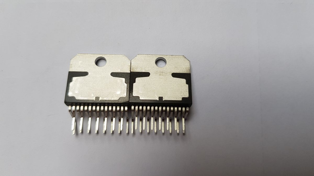

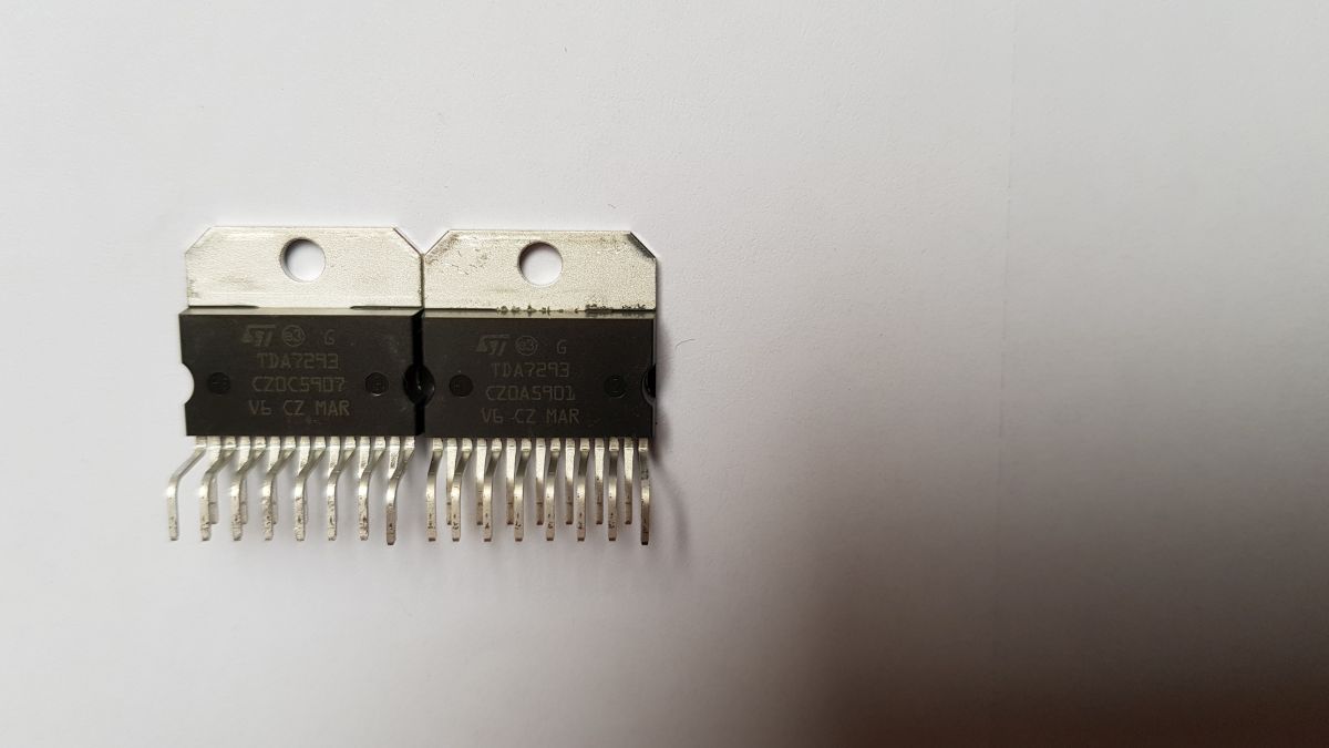

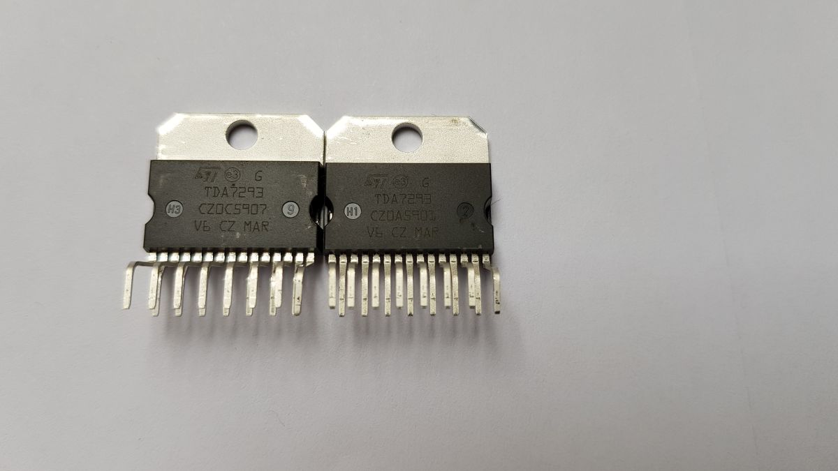

My TDA7293's, genuine or fakes?
I managed to source a bunch of TDA7293's, see pics. Obvoiusly they're from two different batches. But are they genuine? What do you think?

Hi kay
As i learned from the LM1875 ebay thread that the only way to test if these chips are genuine is to short them and look if they are survive.🙄😉
chris
Thanks 😉!
What else could be in these cases that mimicks a TDA7293's functionalities more or less? A 7294 chip maybe. Anyway, this could be sorted out with the help of pin 11 which disables the connection between the low power and high power sections in a genuine 7293. Will test it.
Best regards!
