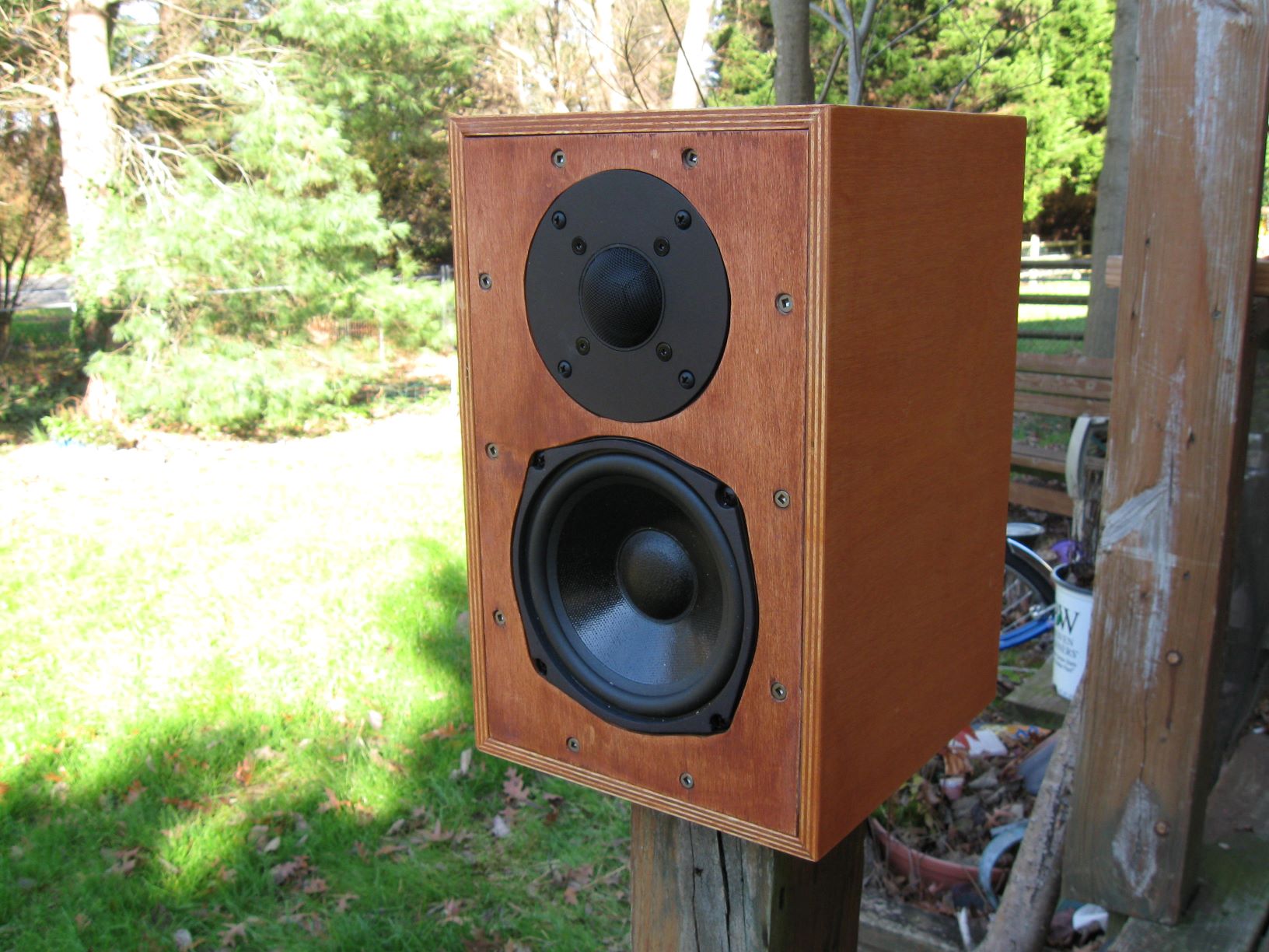

My pair was built to the BOM with the 4.7 caps at C1 and the WIMA caps at C27. They sound great. Listened to them for three nights at 2-3 hours a night. I use the speakers X posted here as a homage to the LS3. I used a few different sources and I was very happy with the sound of the amp. Most days I listen to an F6 with Korg Nutube pre. so don't think you need a lot of upgraded parts to get this amp working very well.
Nor do I want to discourage you from trying stuff. My C1 caps are physically huge and ordered because the ones on the BOM were on back order. Maybe they make a difference maybe not but the bass is good and the music was pulling me in. To me that's good enough.
