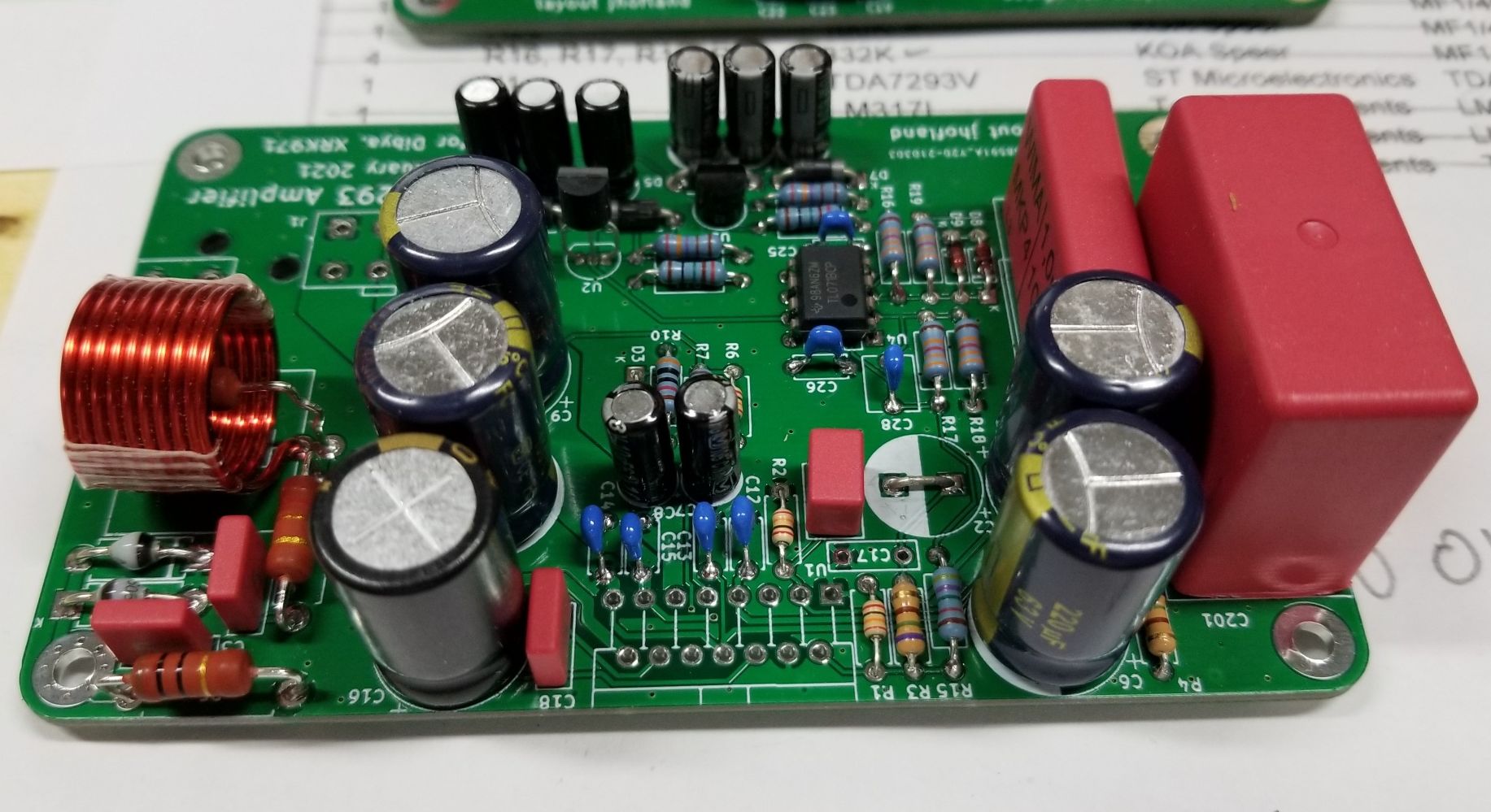

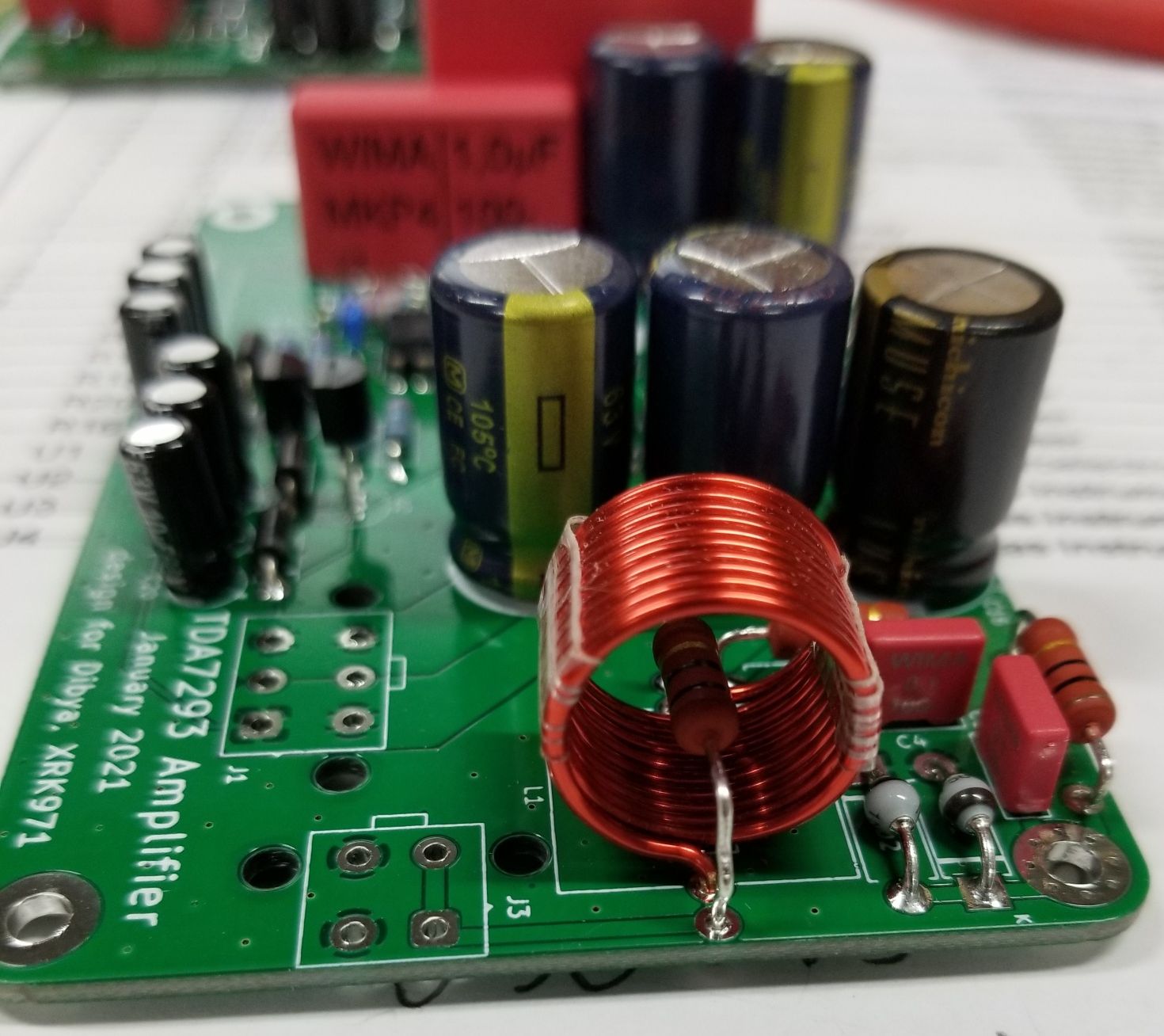

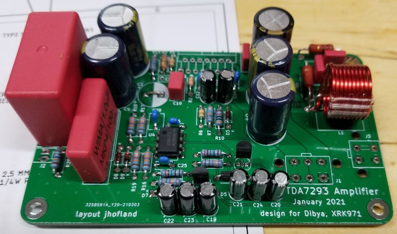

I started on the Xmas amp a couple of day ago, here is my progress so far,
If you see anything wrong, please let me know!
First time making an inductor, what a PITA.
Not 100% sure on the connectors yet, so I didn't solder anything on the board yet.

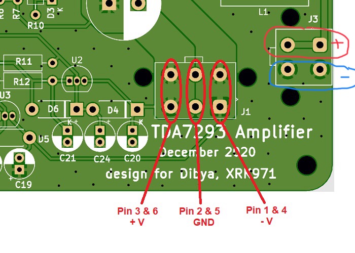

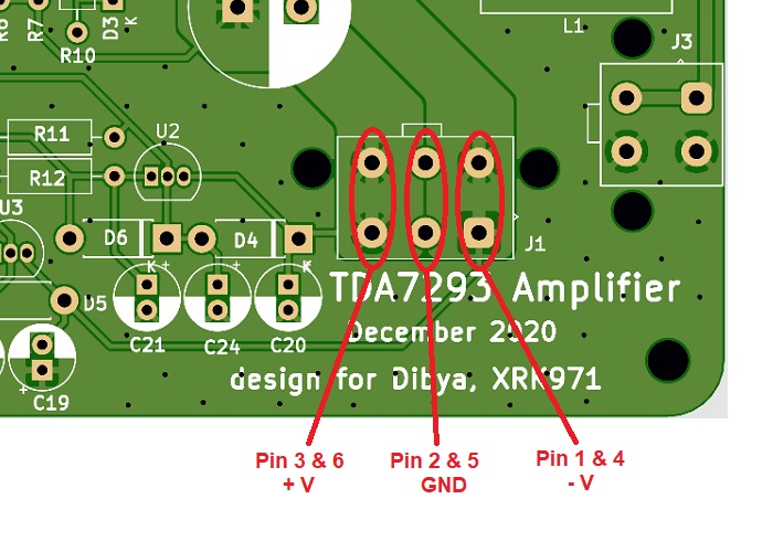

So, just to confirm the J1 Molex pinouts and match with the schematic. Is this correct?
Your pinnings are correct ..L-to-R: +V GND -V

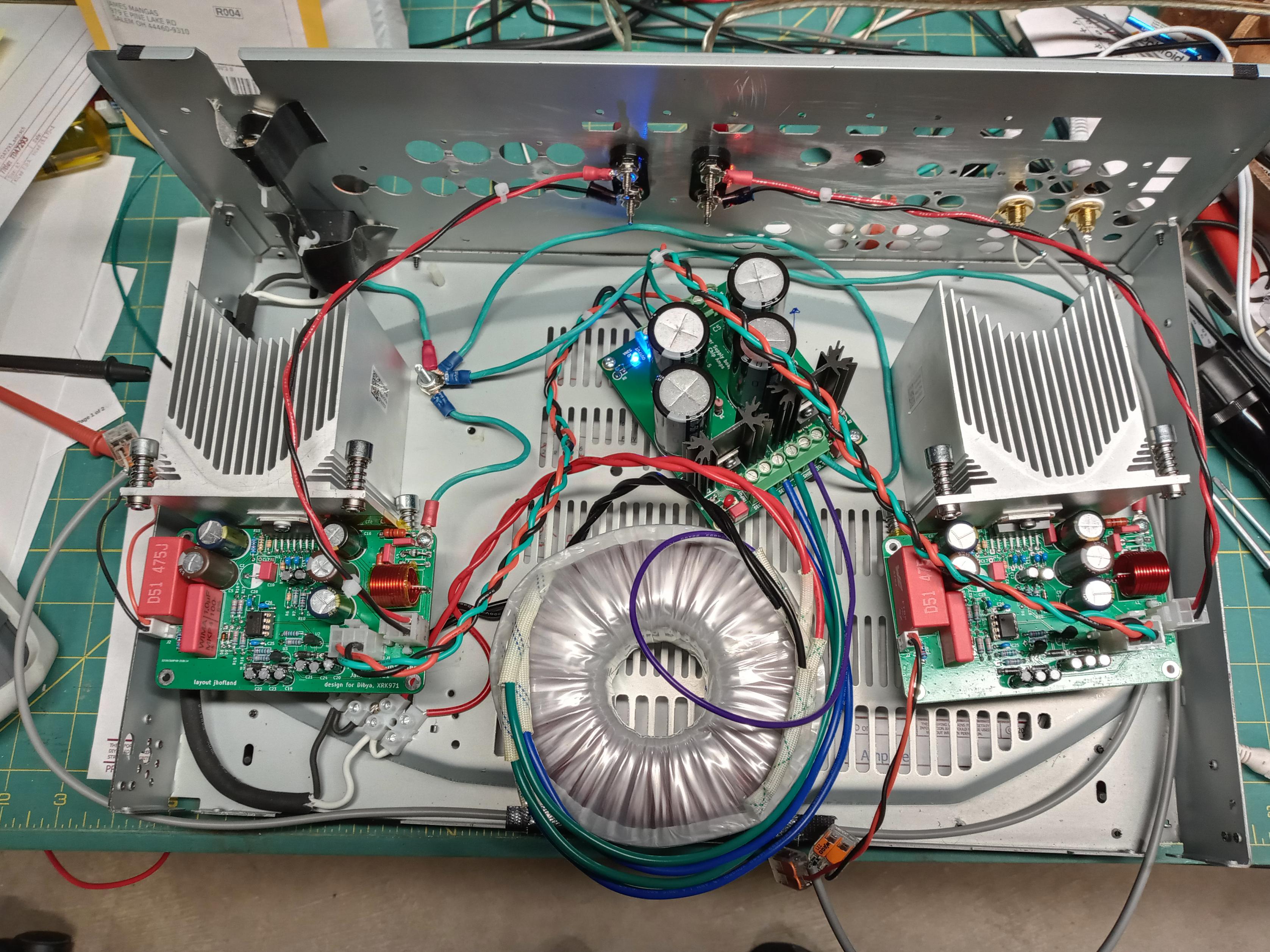

Xmas amp test chassis
Hi everyone!
I built the amp a few months ago and had it it my rather sloppy (and well ventilated) test chassis. Despite flying leads everywhere and an open air layout, this amp is dead quiet! I listened to it for 6 or more hours a day for 8 weeks and have to say I am truly impressed!
I did make one change though. While I thought the amp sounded wonderful I felt it needed just just a little more punch as I was listening to it in a rather large room so I swapped out R-3 from 750R down to 680R thus boosting the gain a bit. I was worried that it might negatively
effect the fidelity of the amp but I'm pleased to report that it did not. The slight boost in horsepower gave it a noticeable increase in slam that was just what it needed for my application.
Hats off to everyone involved in the design & production of the boards and a special thank you to Dibya for giving this project to the DIY community. Well done! I ran this amp hard at time & it never failed to impress!
Here's a pic in the test chassis. I can't wait to get it in a proper box but first I have to finish another project I have going. I think I'm going to give the Xmas amp to my grandson for his upcoming 16th birthday. Thanks again to everyone for making this possible!
