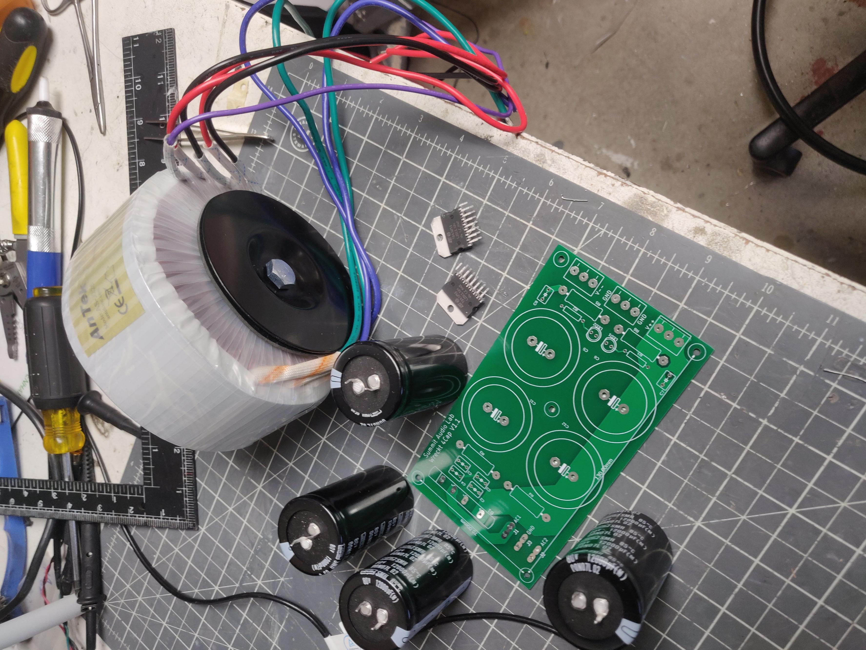

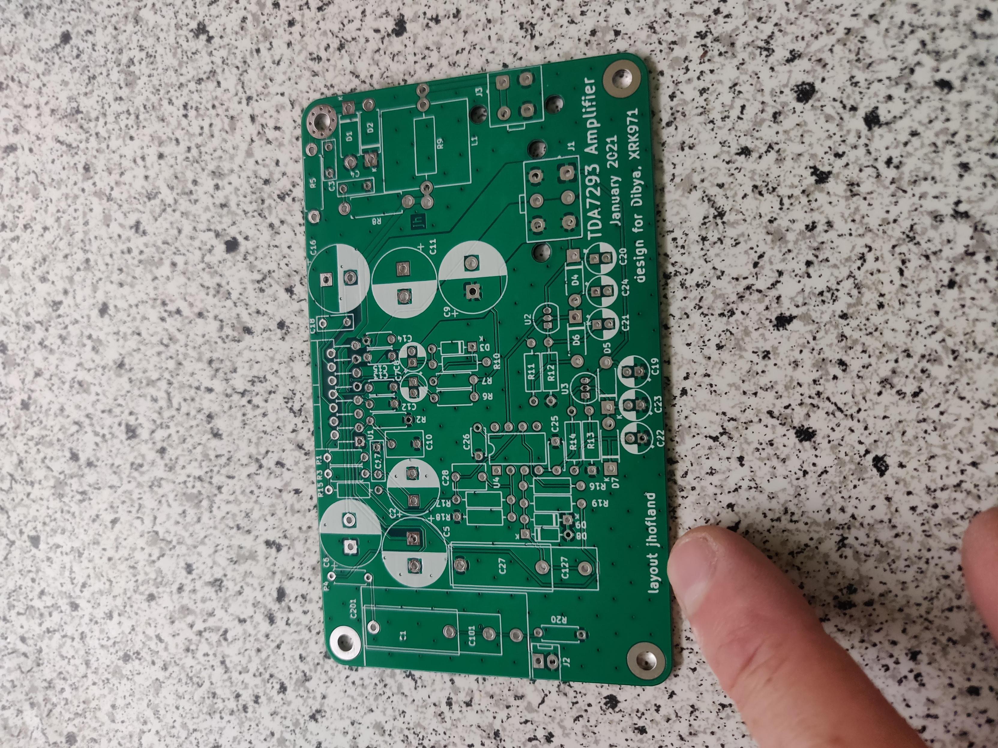

Getting ready to do a build on this. I was looking for a simple figured out chip amp to build, and this fit the bill, thanks to the developers.
I've started collecting parts.
JLCPCB sent me 5 boards,
antek sent a 3225 dual 25v secondary 300va transformer,
Ampslab.com supplied 5 tda7293 chips,
Power Supply will be my own design PCB with 48,000uf of capacitance.
Case is on the way on the slow bus from China. Case is 320mm*300mm, so nice and compact.
Gotta decide what to do for protection. I also have a diyaudio soft start board floating around I might use.
Plan is to use this in the kitchen, or the bedroom, somewhere. I like my little polk rt25i speakers in my office, so maybe I'll try it there.
I'll post again when I get down the road a ways on the build.

Hey Summitp,
the pics look good. I'm interested in how your build goes and how it works when it's done. 48000µF sound good. Is it per rail or all together? Dual 25V/300VA is perfect :).
I just put 5 PCB's in my shopping cart at JLCPCB. I already use two TDA7293 paralleld for my Subwoofer, but I'm interested how a single one compares to the open source LM3886.

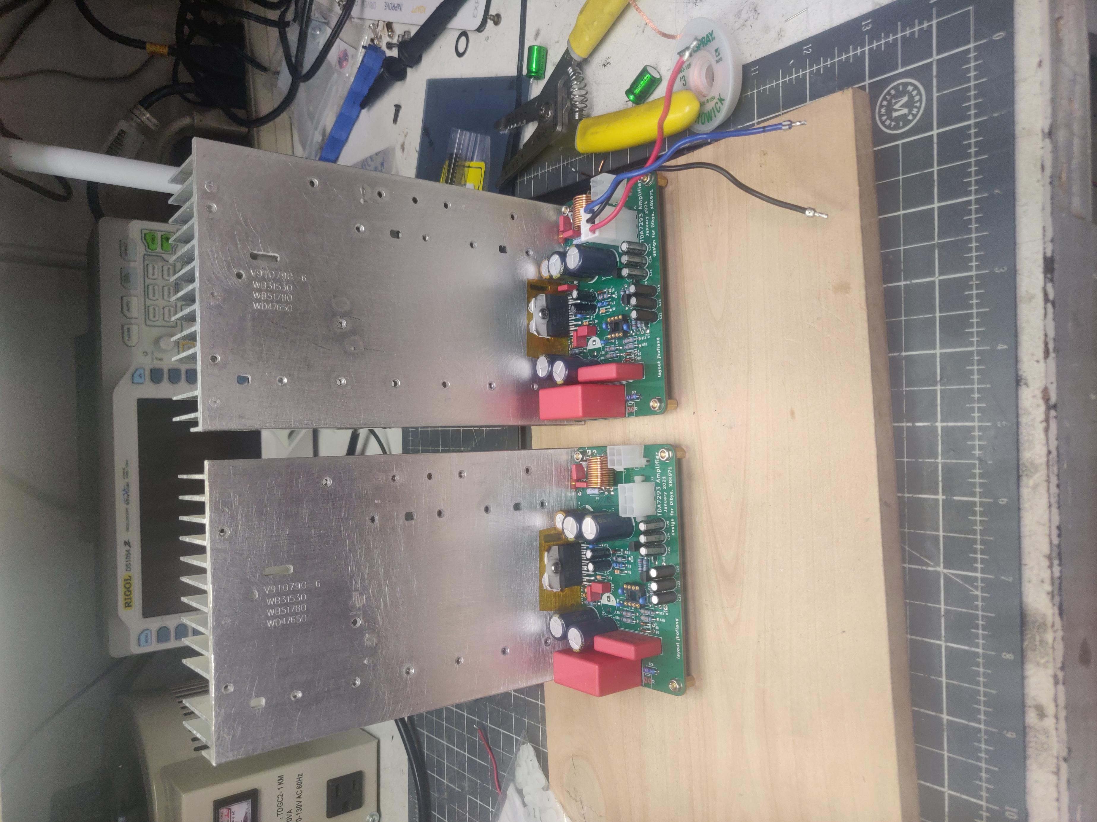

Made. Alittle progress on mine. Unfortunately the case was delivered to Chihuahua Mexico. I am not in Chihuahua. A little digging turned up an appropriate size piece of wood and a couple heatsinks from a dead Yamaha reciever.
I forgot to order the 2.2r 2 watt resistors for the zobel network. I did have some 2.2r 1 watt. Is that going to be a problem? Only if I play it really loud and it starts oscillating right? My other "in stock" option is paralleling a couple 10r 2W to make a 5r resistor.
Just gonna get a test setup going until a case shows up.

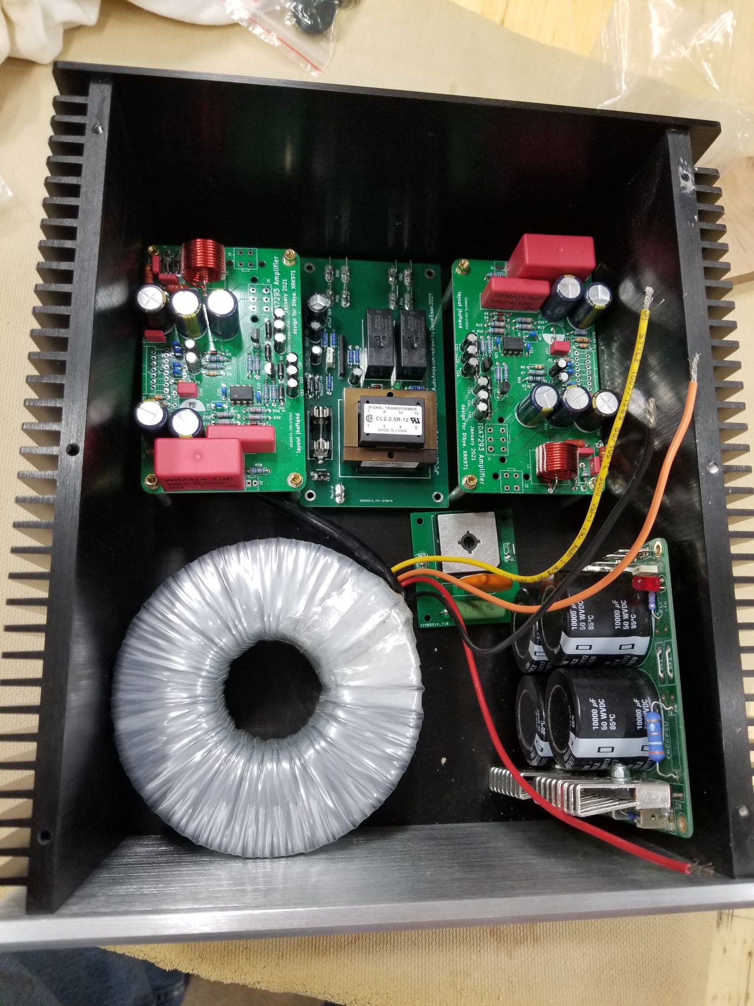

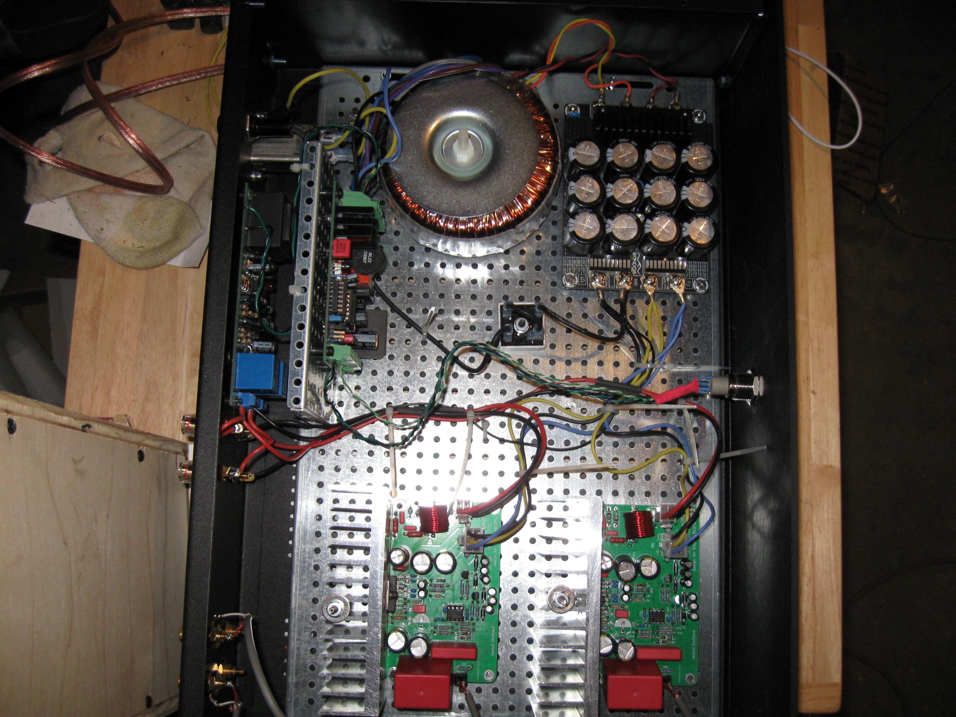

I am at the point where holes need to be drilled in the case and everything is about to be mounted.
Anything wrong with how I have this laid out?
Power will entering at the rear bottom left (looking from the front).
RCA's will be entering near the ALPS 10K pot. Oversized volume knob will be on the front with a brass rod connected to the ALPS pot at the rear of the amp.
Speaker posts will be to the left and right of the protect board that's in the middle.
Is it a bad idea to run the 110v from the input at the back of the case underneath one of the amp boards to the toroidal transformer? Would there be an advantage to putting a metal plate between the 110v wiring and the board?
What about shielding the toroidal transformer itself, Putting a metal box around it, inside the case? I don't see this very often. If it falls under the heading of, "cannot hurt", I don't want to do it because of the amount of effort involved, but if it is correcting the source of a major problem I will.
Any other comments about the layout?
Thank you,
David.
Founder of XSA-Labs
Joined 2012
I would move the power trafo away by mounting it on its side using a L bracket. Move the speaker protect board to the rear panel and let the AC mains run in middle of case away from amp PCBs. Place PSU board on floor in middle in between the amps. If you move the trafo father away I don’t think you need shielding. Sheet steel box works. Or get mu metal shielding foil. But try it first loosely mounted (or held in place with blue tack) etc to listen to the noise. Adjust orientation for best case. Rotation of transformer can have an effect.
To make room, you can bend the pins of the chips so that it mounts on same plane as PCB like an underhung active. Mount amp PCB and chip amp on the heatsink side panel. That will open up all sorts of space inside the cramped chassis.
