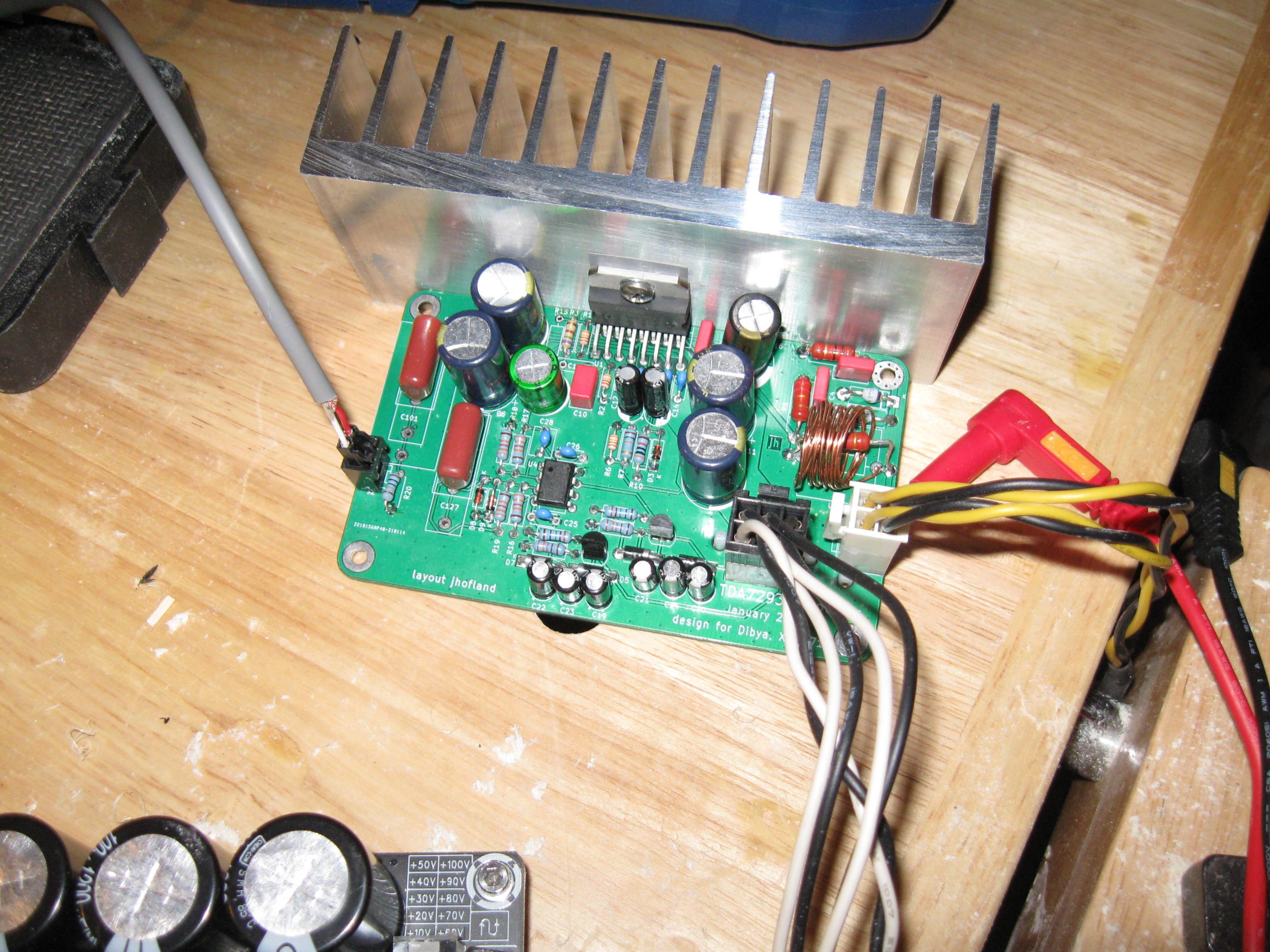

Here is the board before the short.
Looking at the picture, it does not look like you have an insulator behind the TDA7293 chip nor a plastic shoulder washer to insulate the metal from the heat sink??
Also, Reflow R2 solder joints, looks like a void at one pad.
There is an insulating pad but yes there is no shoulder washer. You can see the grey pad in this shot.
I need to order connectors, washers and thicker pads. Maybe we need to make a list of items that will allow completion of the amp and keep mistakes like mine from happening. Especially if they are really important for success.

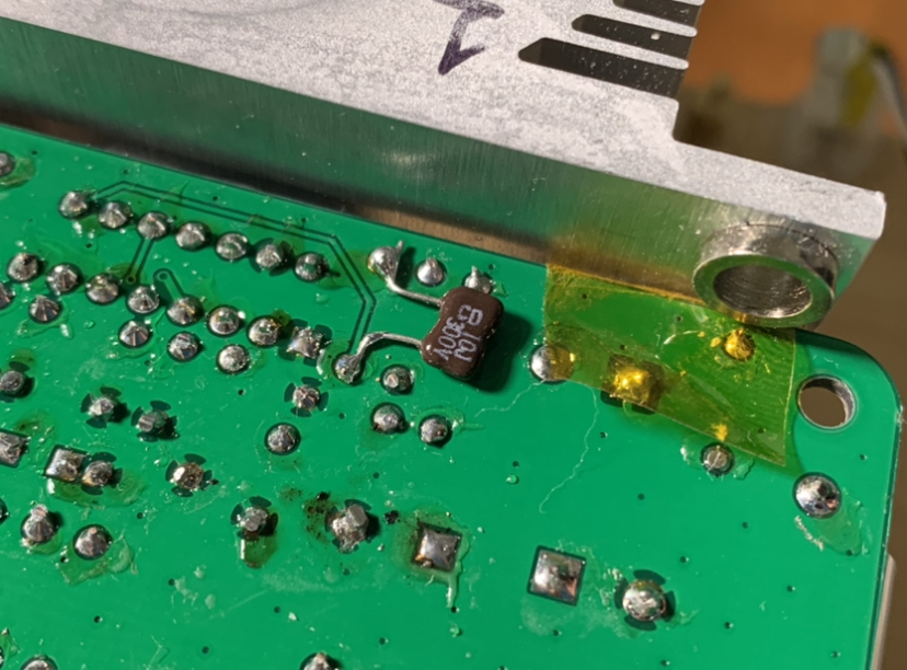

Thanks for the tips on adding a 10pF cap across R1. I think I have a silver mica that might work nicely there. One can also change the input resistor R4 to 1k5 to decrease the RF low pass filter frequency. Although, that may attenuate the input signal.
Hi X, if I already asked this I apologize...did you ever use the 10pF cap across R1 and what was the result?

Yes, I did - I ended up installing a 10pF 300v CDE silver mica cap on the bottom side of the board across R1. I have not looked at it on an Oscope with square waves, but listening to it with music, I can’t really tell a difference.

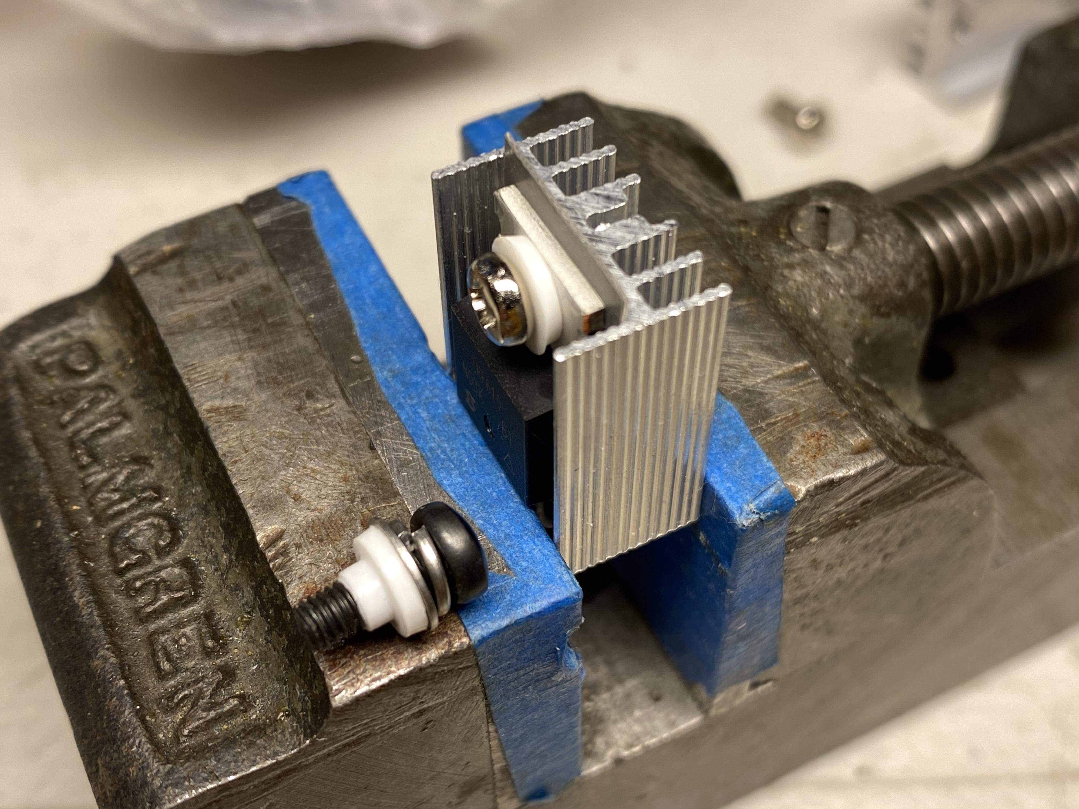

I have to put in an order for some hardware and I am wondering about shoulder washers. The ones I am looking at are 2.0mm in total length (1.2mm washer and 0.8mm insulator length) and fit a #4 or M3 thread. The metal on the TDA7293V is 1.6mm thick.
Are these sufficient for isolation, or what are others using ? Thanks for the help.

Just as long as you use them on both sides (chip side and heatsink side) the M3 metal screw shouldn’t short the system. I actually have used nylon screws, washers, and thumb-screw nuts which don’t need any special insulated inserts; just keep the metal ground plate, of the chip, from touching the heatsink.

Hi Pete,
I don’t think I understand your setup? You can’t use two shoulder washers to hold a device to the heatsink, it will not make contact properly and will melt almost immediately! I also would not recommend plastic/nylon screws as I doubt they will hold the proper torque/snugness.

Hi Pete,

Here is an example using a TO-220 Mosfet.
Heatsink—>insulator pad—>Mosfet—>nylon shoulder washer—>flat washer, split washer then screw
Yes, I’m sorry, I should have been clearer. I usually use heat sinks with fairly wide fin spacing and drill a hole dead center between the two fins then use an insulated spacer on both sides (chip side and in the gully of the heat sink fins). The situation you pictured is how I would do it for a TO220 regulator onto a tapped heatsink. You can snug down a nylon screw well enough. The aim is only to sufficiently oppose the two surfaces together, with paste in between, for heat transfer. In my normal usage, none of my LM3886 chipamps or this chip, even get slightly warm enough to justify the size of the heatsink I use anyway.
Vunce, I was thinking of these. The shaft length is 1.22mm, just a bit shy of the 1.6mm thickness of the metal tab on the 7293 and they are made to pass through a TO-220.
https://www.mouser.ca/datasheet/2/2/Aavid_04242019_7721_Series-1578809.pdf

Aavid 7721-7PPSG These shoulder washers fit the chip and a 4-40 bolt. They were on the BOM for Marc Johnson's soft start switch. 3mm should work also but I only had a 4=40 tap.
