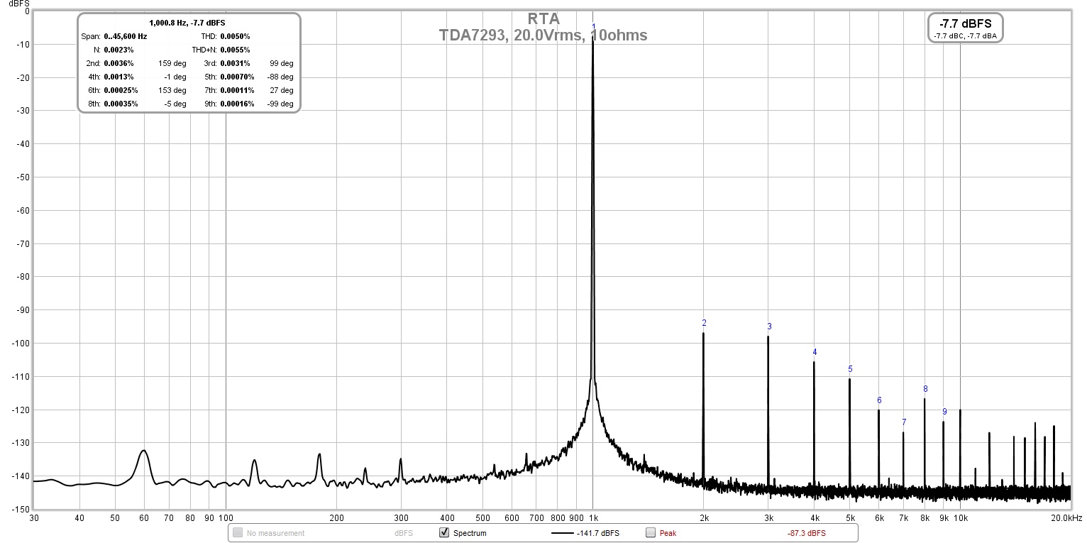

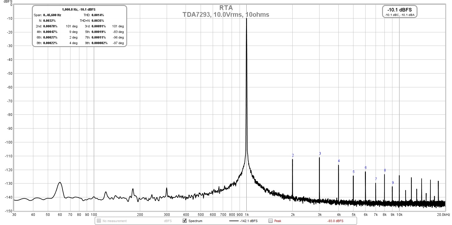

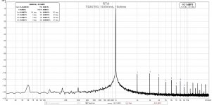

I was able to clean up the measurement setup. The shield on the XLR input cable for the load resistor measurement needed to be grounded to the amp chassis ground. Much cleaner now. Here is measurement for 10vrms into 10ohms (10w):

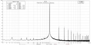

Here is 20vrms into 10ohms (40w):
