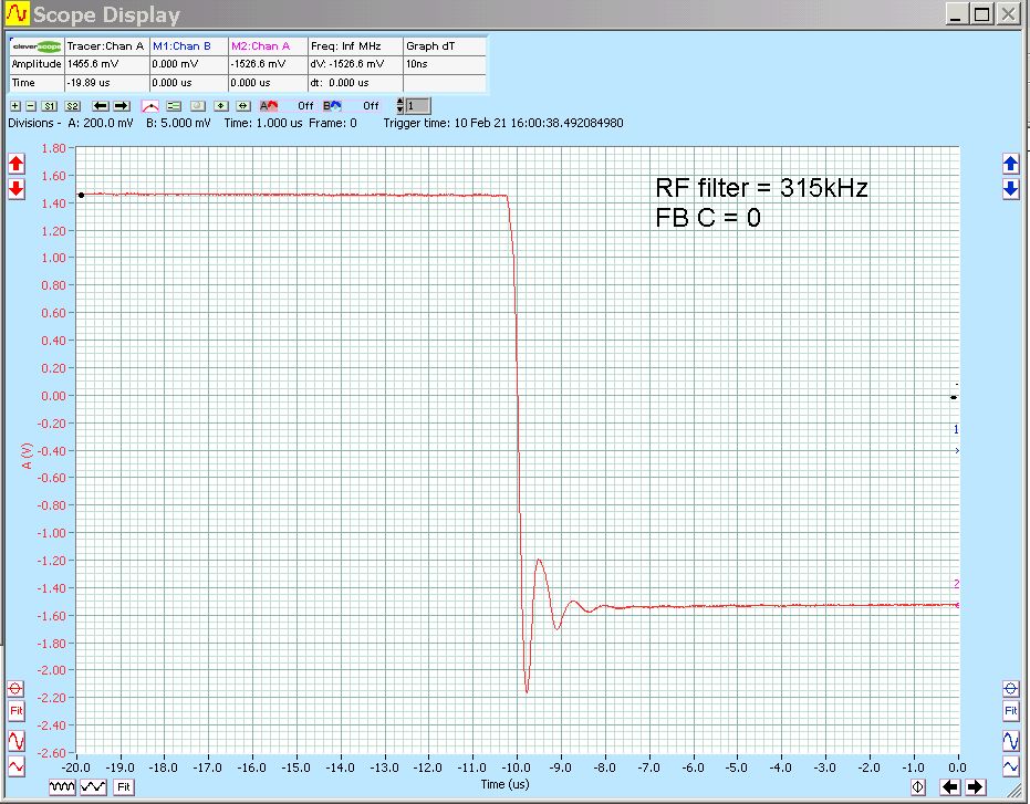

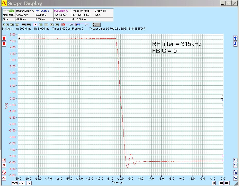

Here are the waveforms. These are triggering on the falling edge of a square wave, into an 18 Ohm load. The first set is with an input rf filter set to 315kHz. The overshoot of the stock configuration with a 1MHz filter would be even worse.
First is the "low-level" response. You can see this is still a 3VP-P waveform. Overshoot is about 25%, and it doesn't get any better at lower voltages. With 1uS per division, you can see the resonance is roughly 1.3MHz.
As the level is increased, the "overshoot" is increasingly swallowed by the finite slew rate of the device. Shown is 10VP-P. The overshoot is roughly the same magnitude as before, but it looks better because it is a smaller percentage of the overall waveform.

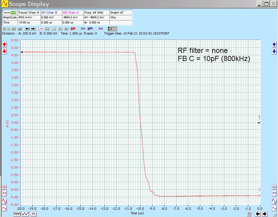

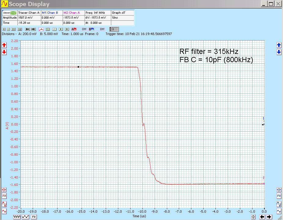

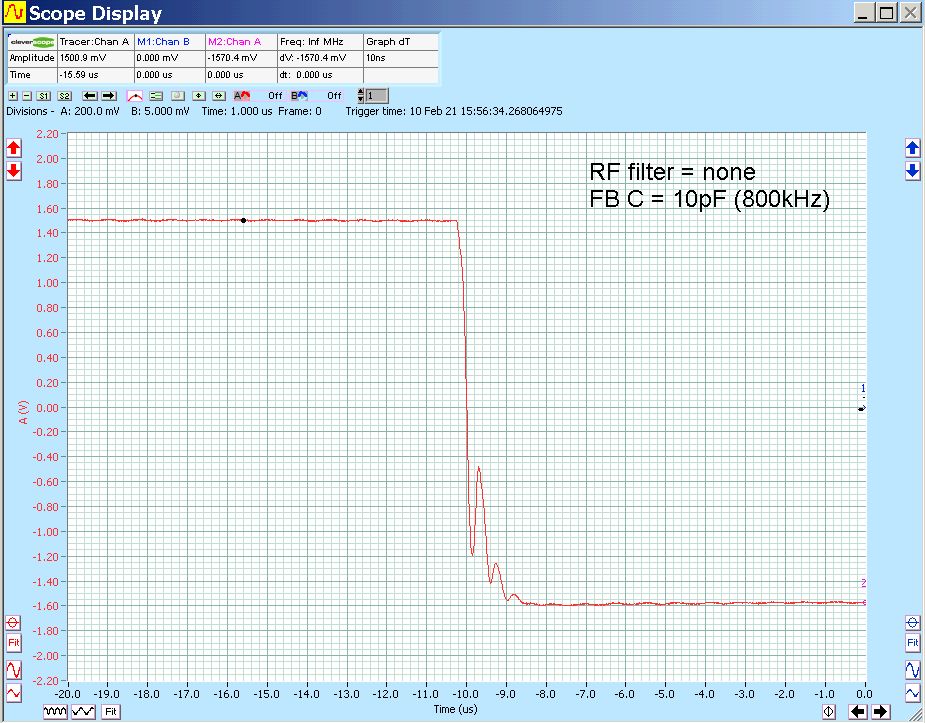

To optimize the feedback capacitor, I remove the input rf filter cap and tweak the falling edge response. With a 20kHz feedback R and 1.3MHz resonance, you could start with 6pF (1 / (2 * PI * Freq * R). I started with 8.2pF (1MHz) and that took care of most of the overshoot, but I decided to go to 10pF (800kHz) to be conservative. These are the same low-level and high-level waveforms, with 10pF feedback C and no input RF filter.
As you can see, it cleans up the high-level waveform really well; it doesn't even need an input filter. The low-level waveform still does, though.

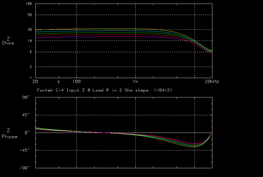

I don't want to make your thread about my headphones, but since you asked, attached is the input impedance of the headphone system. Last month I ran a series of curves with different primary terminations. The top curve is the stock one. I'm using the next one down, the light blue one, which gives a load that is ~18.5 Ohms from 20Hz to 5kHz. That is why I have been using an 18 Ohm load in all my measurements.
