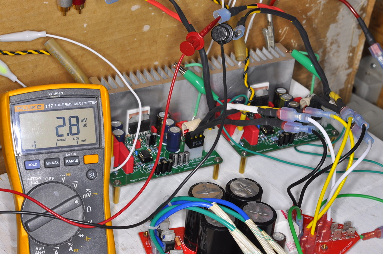

When the offset was lowest (4.5mV) the voltage at pin 6 of the servo op amp was 169.1 mV
measured between pin 6 and the grounded corner of the board.

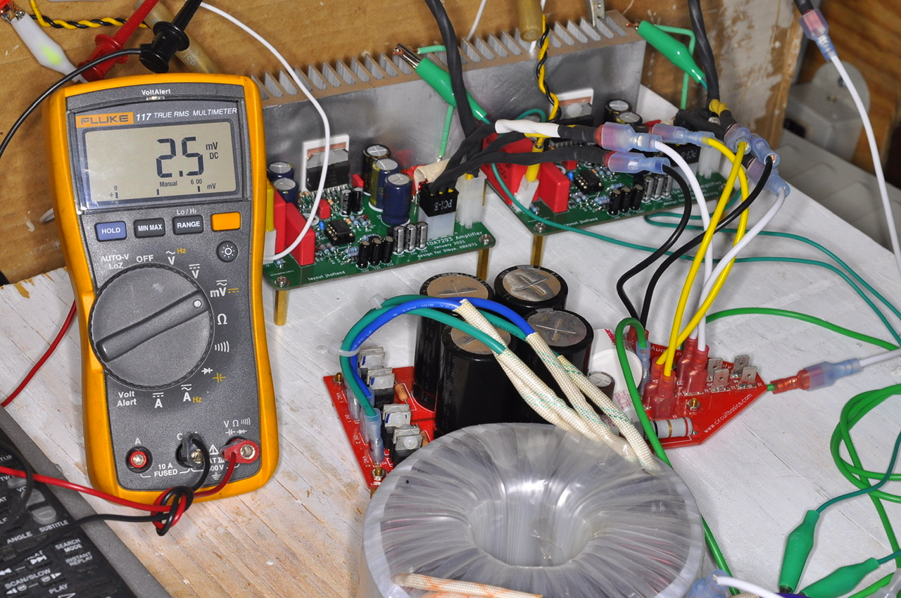

Good to hear you got it up and running Turion. Interesting apprach with the RCA ground to PSU star? 15mV is still within reasonable limit for speakers - but that is odd that it is not closer to 5mV. You can try changing R15 to 10k and that is still a safe value according to Jhofand. That will give you some more gain on the feedback loop to zero it out.
X: I replaced the 47K5 at R15 with a Dale CMF55 10K (its what I had in my stock) and the DC offset at output dropped to 3.5 & 3.8 mV DC (see pics).

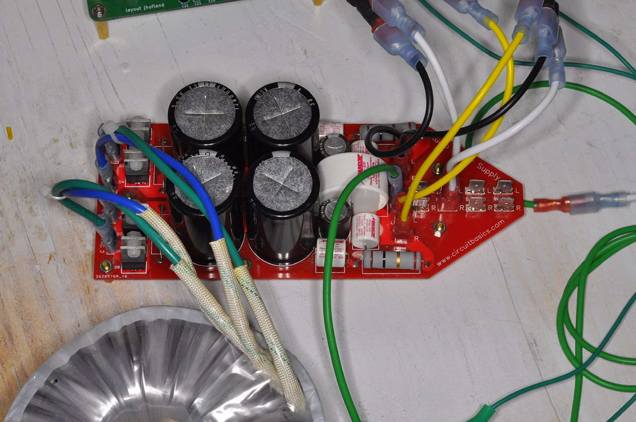

Can you post pics of your setup showing how your psu and amp boards are wired? Strange that you had to move the signal gnd to the psu?

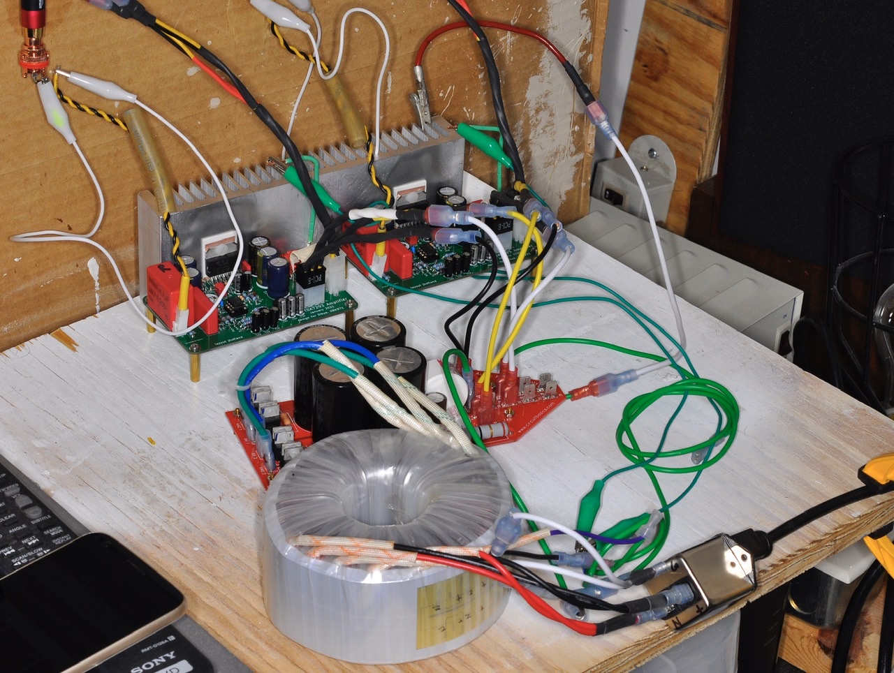

Vunce: I took apart all the ground wiring and re-connected everything. I took the boards’ GLB directly into the Earth star ground and re-connected the input signal ground to the RCA connector. Ground loop feedback eliminated. I may have grounded the boards’ GLB outputs to the PS star ground last time. All good now!
Thanks to both of you for comments/suggestions.
All of the X5R caps are mounted under the board in case I wanted to change them out.
Pete

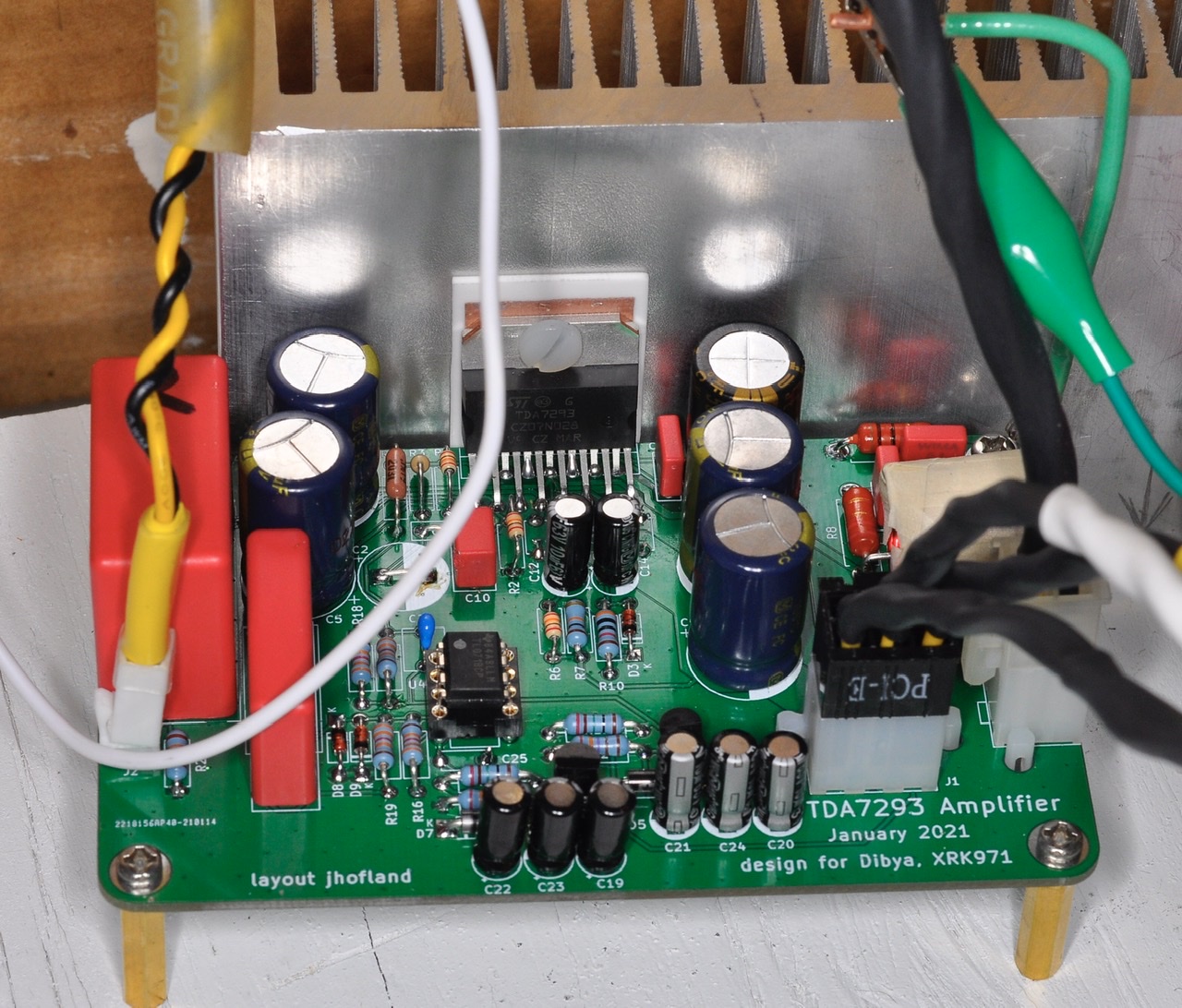

Hi turion64 (Pete),
When you posted about using IC sockets for U4, where you referring to the solderless type, as the holes on the pcb are close together and harder to solder. Just wondering as a soldered socket is no advantage, except for removal of the IC.
MM
MM
Hi turion64 (Pete),
MM
Your last sentence is the winner! I wanted to be able to easily replace the single op-amp in either the case where something shorts it or i want to try other op-amps at the heart of the servo.. just because.

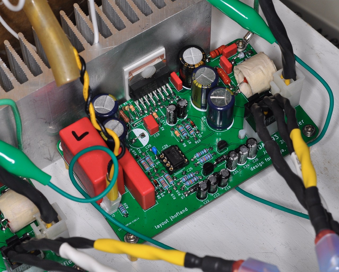

My impressions so far? With the following build variations in place and listening with 8 ohm speakers (Genesis Physics 210 speakers ..680pF WIMA at C10, 10pF C0G across R1, 4.7uF WIMA MKP4 in C201, 1uF WIMA MKP4 in C127, 10K Vishay/DALE CMF55 at R15, 24000uF per rail (Nichicon LKS 50V)...a wonderfully warm sound with a deep, satisfying bottom to the music. Spacial soundstage. A bit more "sparkle" in the upper frequencies would be nice so something to look at (R1, R3; maybe R4 and/or R9?). A pleasing sounding chipamp. Kudos to the designers.
