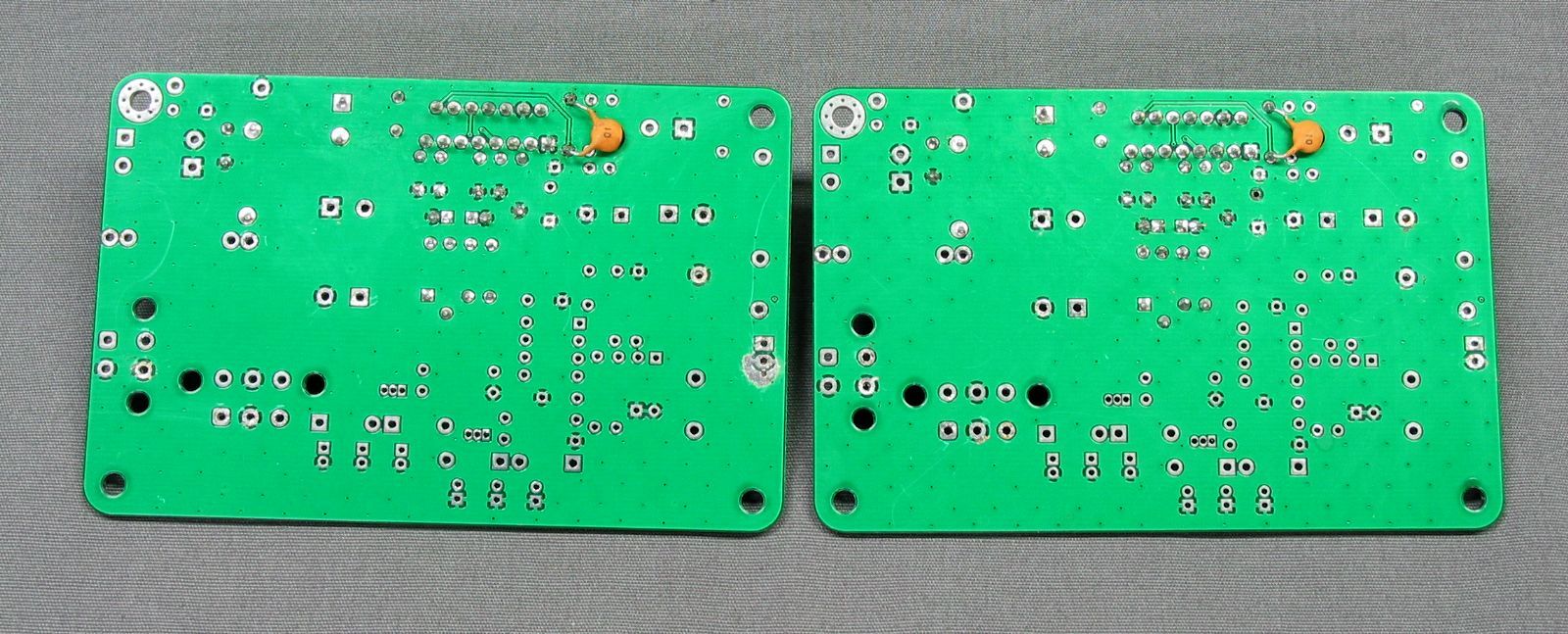

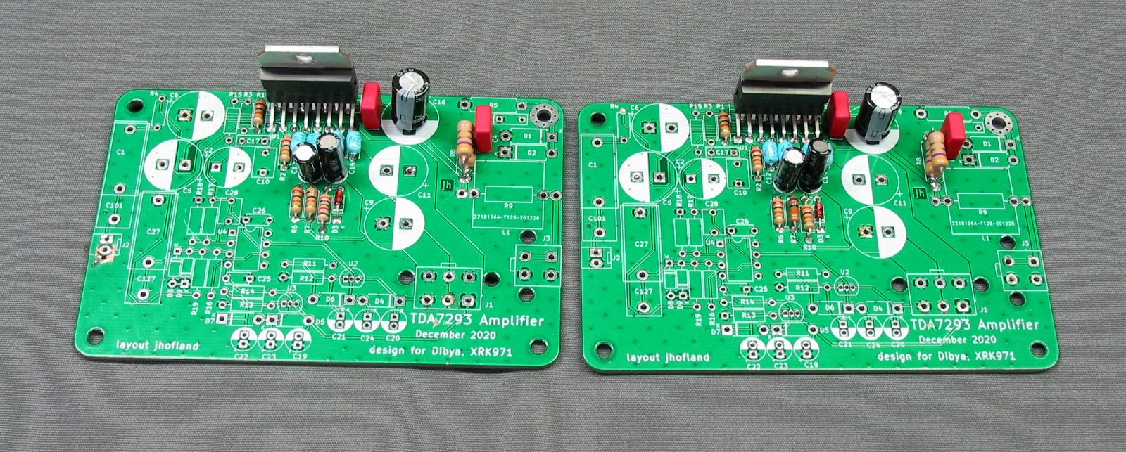

I have a set of these boards available with some parts loaded. I had configured them to drive my headphones but it didn't work out as I'd hoped.
Parts I used specific to my needs were removed with professional desoldering equipment (Pace), and the flux cleaned off with IPA. The 7293's were sourced from a USA distributor. A 10pF NP0 cap is added across R1, and two 680pF mica caps are included for C10. Can ship immediately. Contact me by PM.

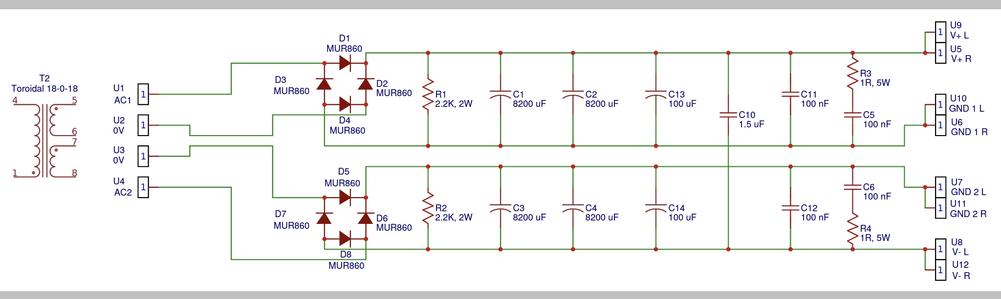

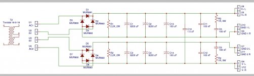

I’ll try that today. Here the schematic of the PS I’m using with tranny being the Antek 3220, C1-4 are 12000uF caps. GNDs are marked at outputs, so yes a sort of PS star.
