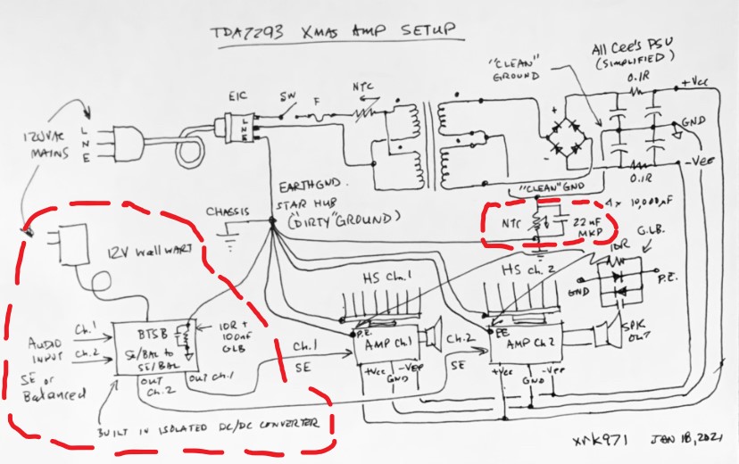

Hi X, that's a very helpful diagram. I agree with all the comments about isolating grounds... I am mostly unfamiliar with the buffer (whether it's an off-the shelf or custom item - essentially how to buy or make one?)... also i have not previously seen using a second NTC and 22 uF MKP in parallel connecting the clean ground form the secondaries to chassis. (see red dashed outline added to your diagram) I understand the use of GLB's everywhere else, just haven't seen an NTC used in this way before.
Thanks! - Six.
It’s not a trick but a fortunate case that adding a buffer in between my signal source and amp cleaned things up. The buffer has a ground loop breaker to isolate dirty vs clean ground (as do all the other circuits). The buffer happens to have its own separate wall power supply and an isolated DCDC step up dual rail PSU (Murata). Here is sketch of my setup.
Thanks! - Six.
The NTC (8D-20 or CL-60) provides a nominal 8ohm to 10ohm resistance when cold. Just like a resistor. However, if there is a catastrophic fault and full current needs to shunt to ground, the NTC heats up and is about 0.5ohm to allow the current to safely get dissipated. Alternatively, two anti parallel diodes conduct when voltage is greater than 0.6v and allow more current to flow. The 22nF (or 100nF) cap is there as an RF shunt to reduce radio noise. You will need really big diodes to handle 10A currents and the single NTC is more cost effective and compact way to do this.
