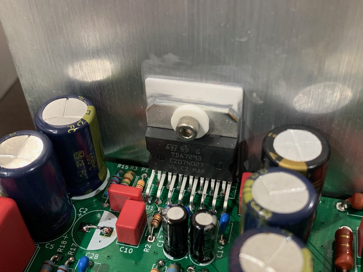

Mounting the chipamp to the heatsink using a ceramic spacer pad and thermal paste:

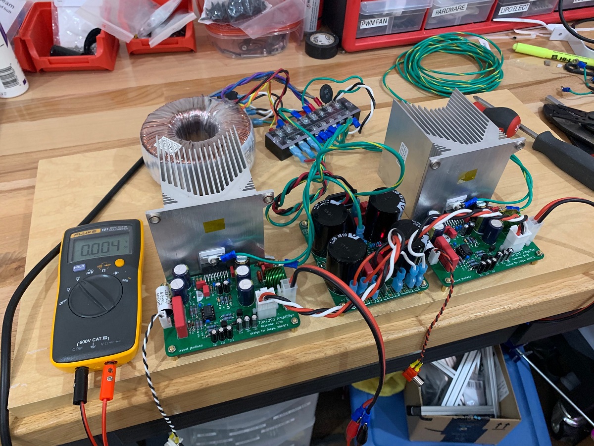

Bench testing to make sure no smoke or explosions. DC offset is about 4mV to 5mV. When amp is first turned on, DC offset is about 11mV and then quickly settles to 4mV:

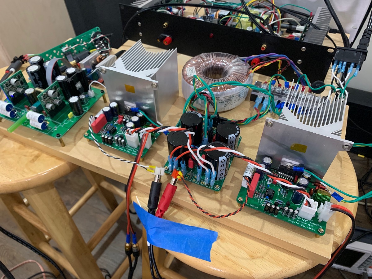

Full listening test with main rig comprised of Focusrire 2i4 driving Aksa Lender preamp (with SMT daughterboard) driving TDA7293, driving 10F/RS225 FAST TL speakers:

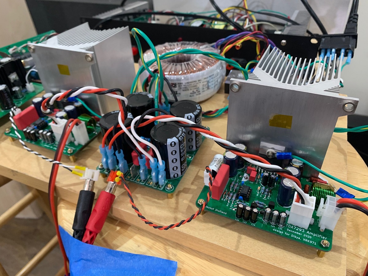

Closeup of the setup:

Pardon my ignorance... I see a lot of care to insulate the bolt + heatsink from the amp's power chip, as often the case.
I always wondered how this worked inside the chip's hole: for sure the bolt must be touching when passing through - how is that insulated?
Many thanks and sorry for the basic question, learning on how to build amps!
