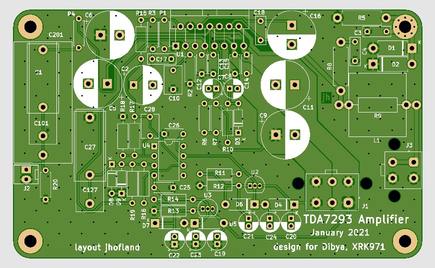

Final Gerbers, Schematics, and BOM
Here are the final design files with the following changes:
1. Isolate the mounting bolt pads from the ground plane, except the top right bolt is connected to the ground via a ground loop breaker (opposed diodes, 10R resistor, and 100nF film cap, all in parallel)
2. Add third set of optional pads for Wima 4.7uF 250v MKP film cap at C1
3. Add 100k resistor to input pin upstream of input coupling cap.
4. Update BOM to show 47k5 resistor for R15 to allow DC servo to work properly.
New and final board layout (107mm x 65mm):

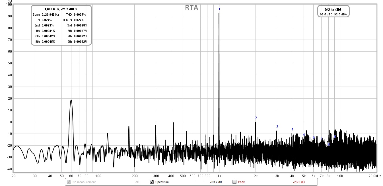

Sixto measured a parallel Chinese/eBay TDA7293 and got some nice results. It has dominant second order distortion as I suspected it would as a result of the quasi complimentary output stage. Pretty low distortion figure at 0.0027% THD.
@Sixto, I did not catch what condition (Volts rms and ohms load)?

Hi Folks,
Hi X, I got 2.87 volts at the meter using an 8-ohm 100 watt resistor for the load. I willl see if I can run a sweep of multiple frequencies and also run 2 resistors in parallel for 4 ohm load. Still learning how to use this feature of REW.

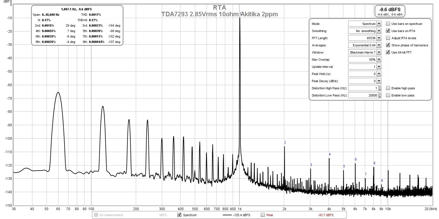

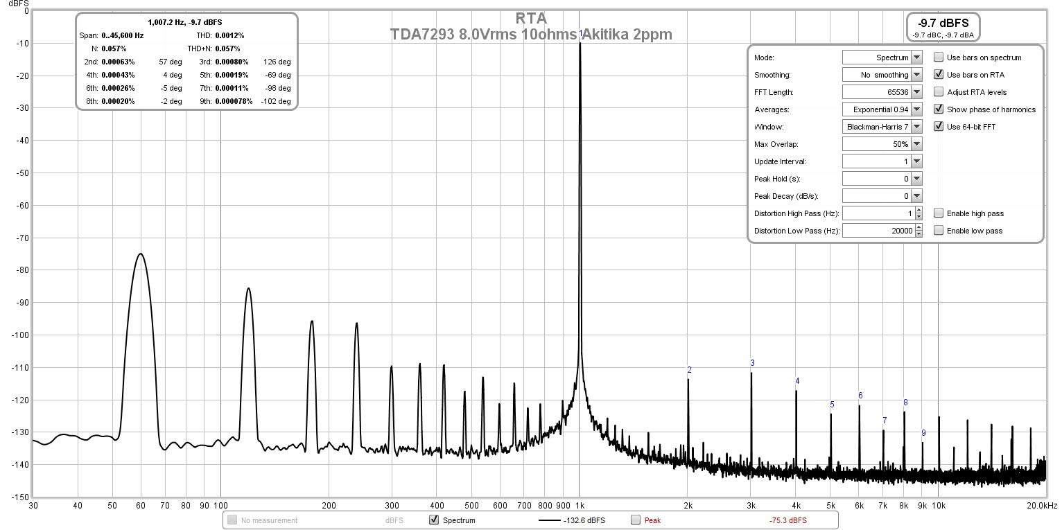

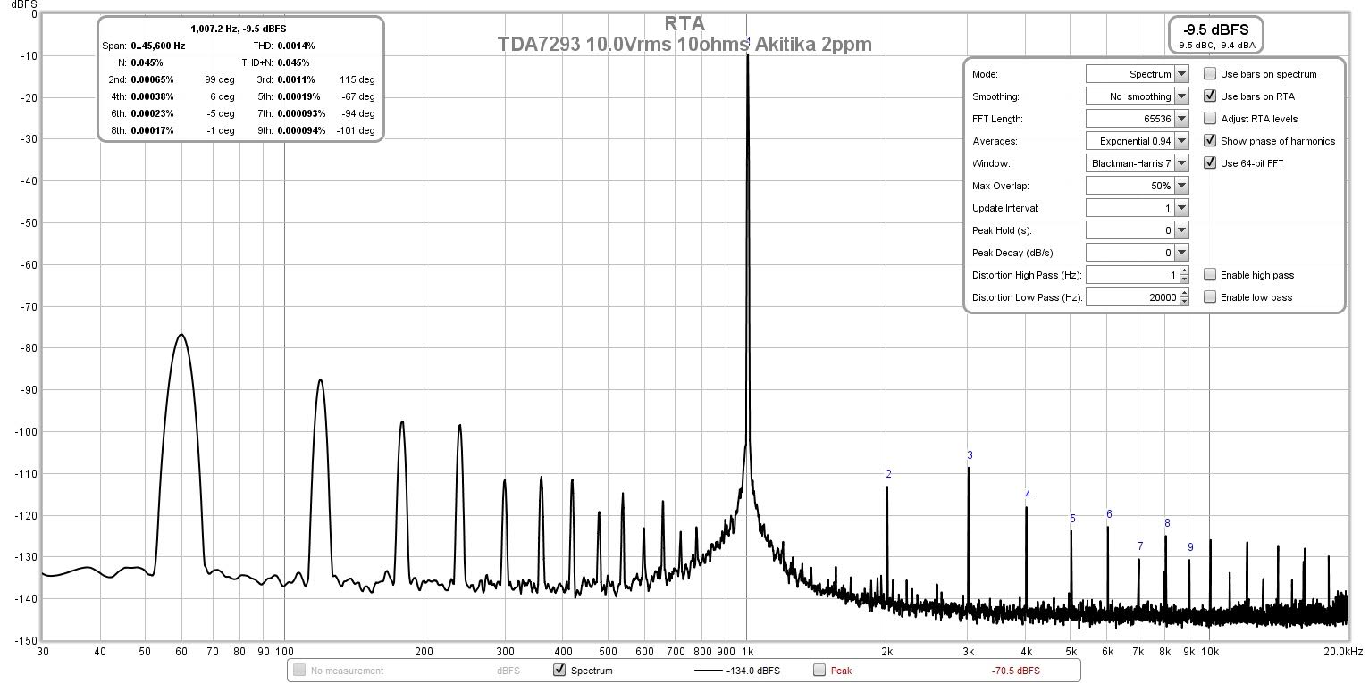

I just did a test on the Xmas amp and it beats the ST data sheet. Seems like design choices and good layout makes a difference. I am getting -65dB of 60Hz mains showing up but it’s not that audible unless I press my ear to the cone. This might just be par for the course for a linear trafo with straight caps.
Test setup: Akitika 2ppm 1kHz oscillator, Focusrite 2i4 interface with XLR input using balanced 10:1 divider and 4.7uF balanced MKP coupling caps, EBG 10ohm 300w non-inductive resistor, Vrms measured with Fluke 115 true RMS meter.
I am getting 0.0017% THD at 2.85vrms into 10ohm. 0.0014% at 8vrms, but becomes less and less H2 dominant as power goes up. This is one of the few H2 dominant chip amps though.
Here is 2.85vrms:
attachment.php
Here is 8vrms:
attachment.php
Here is 10vrms:
attachment.php
Looks like a nice amp based on measurements alone. Listening confirms this as the sound is very natural and fatigue free.

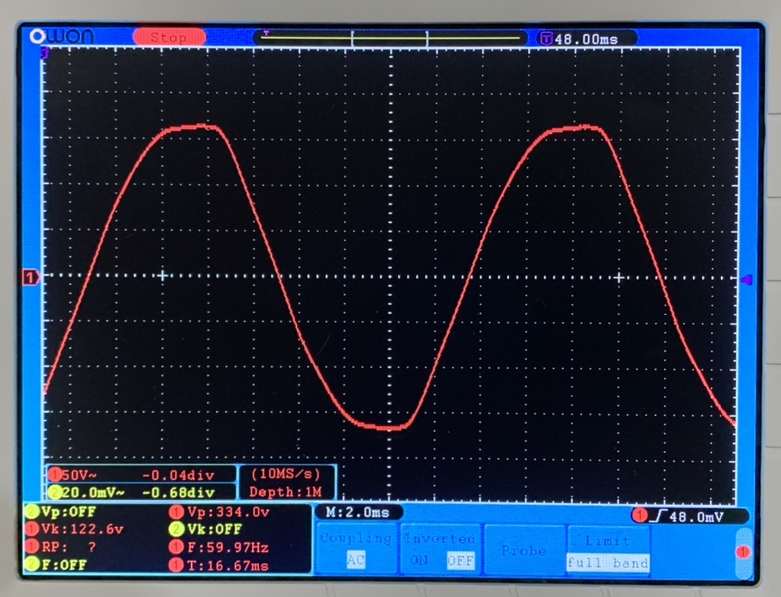

Edit - I suspected that my power company is giving me some dirty AC that’s not even close to sine wave. My oscope proves that it looks like a bread loaf and this generates a lot of harmonics from the 60Hz. Very tough to clean up unless one uses more CRC or a cap Mx. I know my cap Mx PSU can make all this into 1mV ripple at the amp. Here is what the mains looks like:

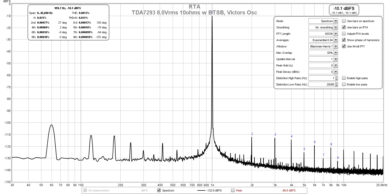

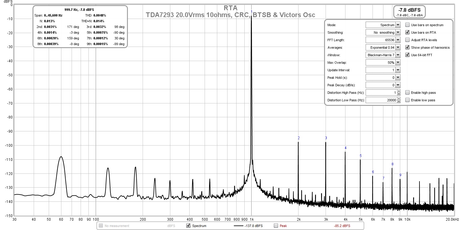

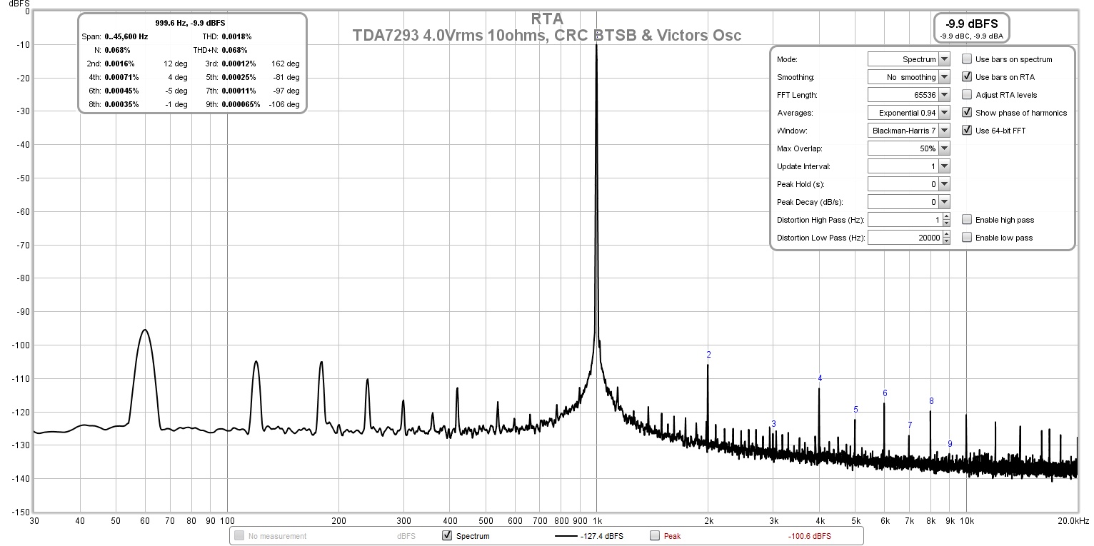

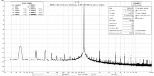

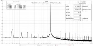

Some improvements in Measurment Setup
After trying to figure out where all that mains noise was coming from, it seems that adding a OPA1656/LME49724 balanced/SE buffer (which has a 5kV isolated DC/DC converter for making the +/-12v rails) between the source and amp, and grounding the buffer's on-board GLB to earth ground helped things. For good measure, I also switched to Victor's ppb 1kHz oscillator. Things look better now and it would appear that I had a small ground loop somewhere that is now broken by the buffer. The 60Hz peak is about -93dB now, very acceptable result as that is basically same as noise floor of CD format. Also, the higher order harmonics of the 60Hz seem to also be controlled. For a typical 8Vrms into 10ohm case, the THD is now 0.0013% and H2 and H3 are about the same but higher orders are monotonically descending:
attachment.php
For the 40Wrms case of 20.0Vrms into 10ohms, we get a very respectable 0.0048% THD, mildly 3rd order dominant, but still with monotonically descending higher order distortion:
attachment.php
And for the low power 4W case, the amp seems devoid of odd order harmonics for a very sweet sound. If you listen at lower levels or with sensitive full range drivers, you will be in a for melodious tube-amp like treat but with lower overal distortion levels:
attachment.php
Glad I found the ground loop - it really helped to show what a great little chip amp the TDA7293 is. I think these measurements will translate to an amp that you will find sounds neutral, natural, and very non fatiguing to listen to. All this confirms why Dibya thought that this particular chip deserves some attention vs how much has been paid to LM3886 and LM1875. Those are third order dominant harmonic distortion chips I think. I should mention that I converted the PSU to a CRC with addition of a 0.1ohm KOA BPR 5W resistor, but it did not change the noise from ground loop issue much. Both plots above used the CRC version of the PSU.

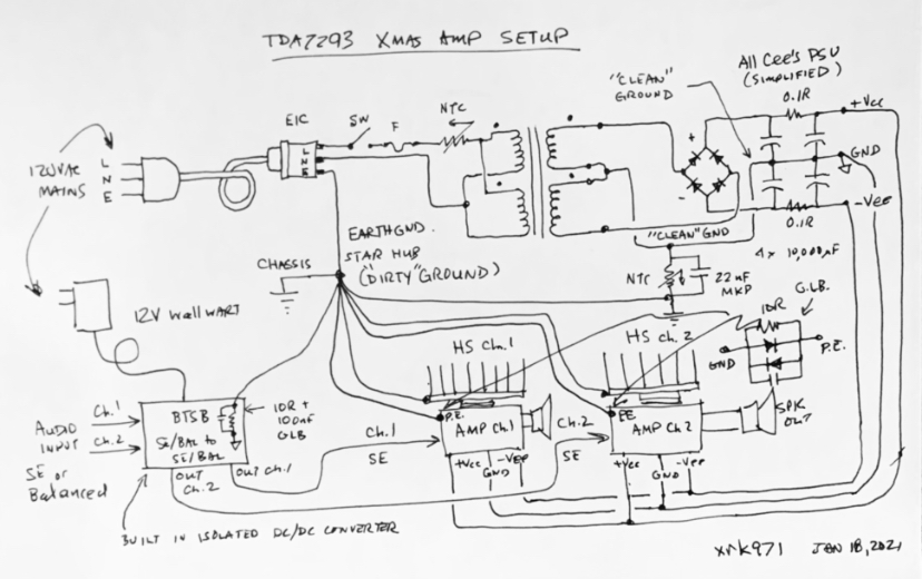

attachment.php
Drawing doesn’t show individual wires for PSU to each amp (ran out of room in drawing). This needs to be done for clean star ground.
The important things to keep in mind when wiring up an amp’s power supply and connections and grounding scheme:
Make sure that all connections to ground are deliberate and not accidental or willy nilly. That is, be sure to define “clean ground” or 0V analog PSU reference and signal 0v and “dirty ground” that is the chassis, mains earth ground from wall plug, and heatsink ground, etc.
All connections between clean and dirty must be made through a ground loop breaker (GLB). Each amp board has one on the top right corner screw mounting boss. The All Cee’s PSU has one too as does the buffer board.
All connections from the GLBs must come to a central hub for a star ground topology.
All connections for clean ground must come to a star hub for the 0v GND - which usually resides on the PSU board. In this case, the All Cee’s PSU has 5 spade connectors for this purpose.
Be careful to ensure that the chip amp is insulated from the heatsink with thermal spacer that is non conductive. Make sure that RCA jacks are insulated from the chassis panel. The negative on RCA should only connect to the amp signal input terminal.
Follow these tips and you will most likely end up with a quiet amp.

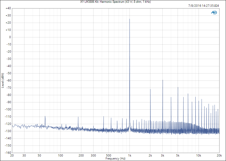

Well, best is hard to define as some people like third harmonic dominant amps - they say it sounds more detailed, etc. So playing at lower volumes will give a very pleasing sweet sound indeed. Pushed hard, it still sounds controlled and respectable without fatigue.
For comparison, here is 43W into 8ohms from a standard eBay LM3886 as measured by Tomchr in another thread:
559155d1468090004-xy-lm3886-kit-review-measurements-xy-lm3886-kit_-harmonic-spectrum-43-8-ohm-1-khz-png
